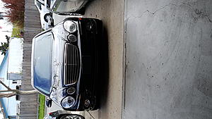

Hey guys after being out of the game after loosing my 2005 E500 in a dispute i am finally back in the game, I was able to get a 2009 E350 with only 77k on the clock fully serviced black on black interior is immaculate. But does have the fuel smell when just filled with gas. i guess all good things have there draw backs. I only have one picture right now as the weather in Californias Monterey County has been less then favorable to do a complete exterior paint correction. But i am happy to be back in the Benz world
