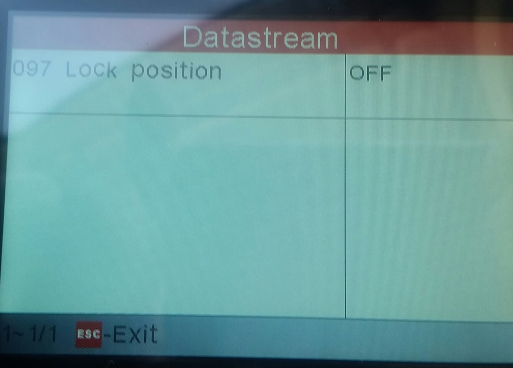

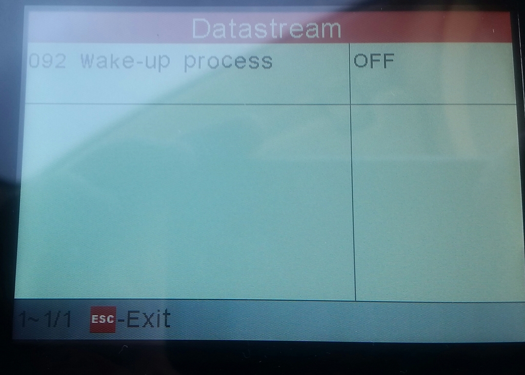

Indeed. Looks like that functionality is definitely built in. I just hadn't noticed (or it didn't work) before. Sorry for the bad pictures. There's lots of sun today.
Airmatic Raising and Lowering with Door Locks-20160627_122510-1_zpstxcz1u2l.jpg
Airmatic Raising and Lowering with Door Locks-20160627_122459-1_zpswxuoxjmb.jpg
So we're back to the Visit Workshop! display and Y54/1 and Y54/1y1 DTCs.

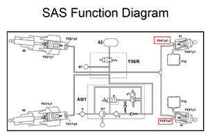

One more diagram for reference.
Airmatic Raising and Lowering with Door Locks-2012-11-01_183052_untitled_zpsqs9d7ihx.png
