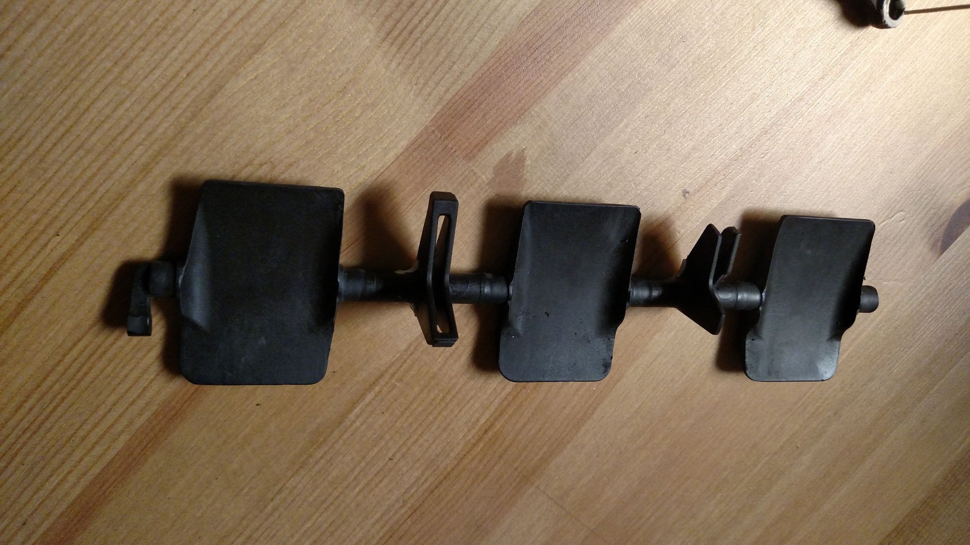

Epoxy of choice for this was Loctite 1C
You can use a different epoxy but you need oil resistance and high temperature resistance, a slight flexibility after cure I think is also good for this application.
Note the right most fin is broken (I aligned it for the picture)
I also decided to reinforce the ones that were not broken
I did not remove the other sides (so I didn't have to re seal it) but also reinforced it just in case

Many different things break on this but most failures should be repairable and it is not particularly difficult to disassemble and re assemble the manifold. (~2hrs)
Do note that at this time I speak from 1 week/200 miles of this working and I will try to remember to report back if/when it breaks again.

This part worked but then had the changeover rod break, wife wanted a new car by then so just let it be.

Thanks for the update. I replaced a typical broken pivot linkage, but it's now throwing codes again. The values from the position sensors don't change, so it's either two bad sensors or the flaps broke once they were reconnected. I figure there's nothing to lose at this point cracking the manifold open to take a look. Appreciate you taking the effort to document your findings.
