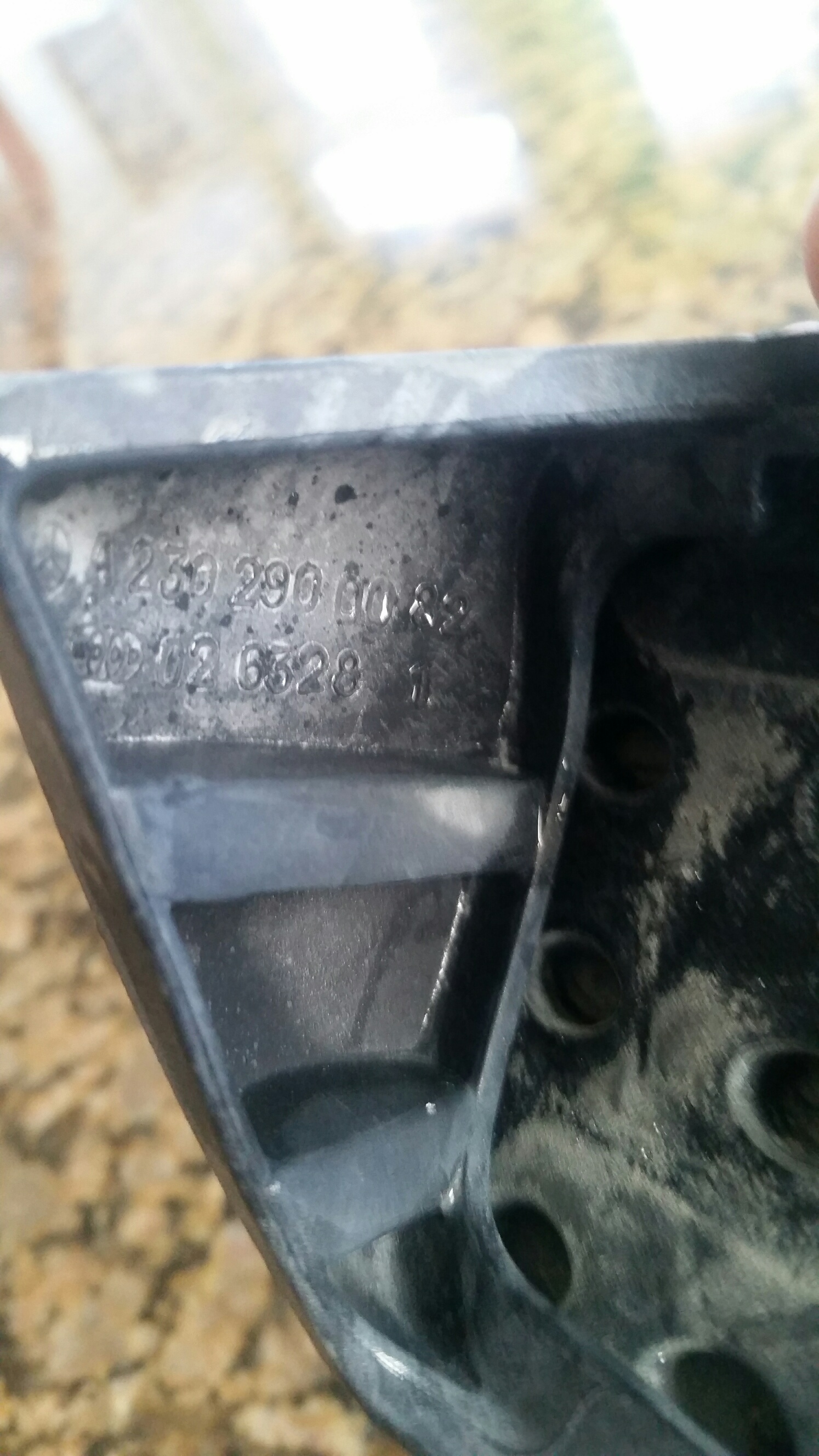

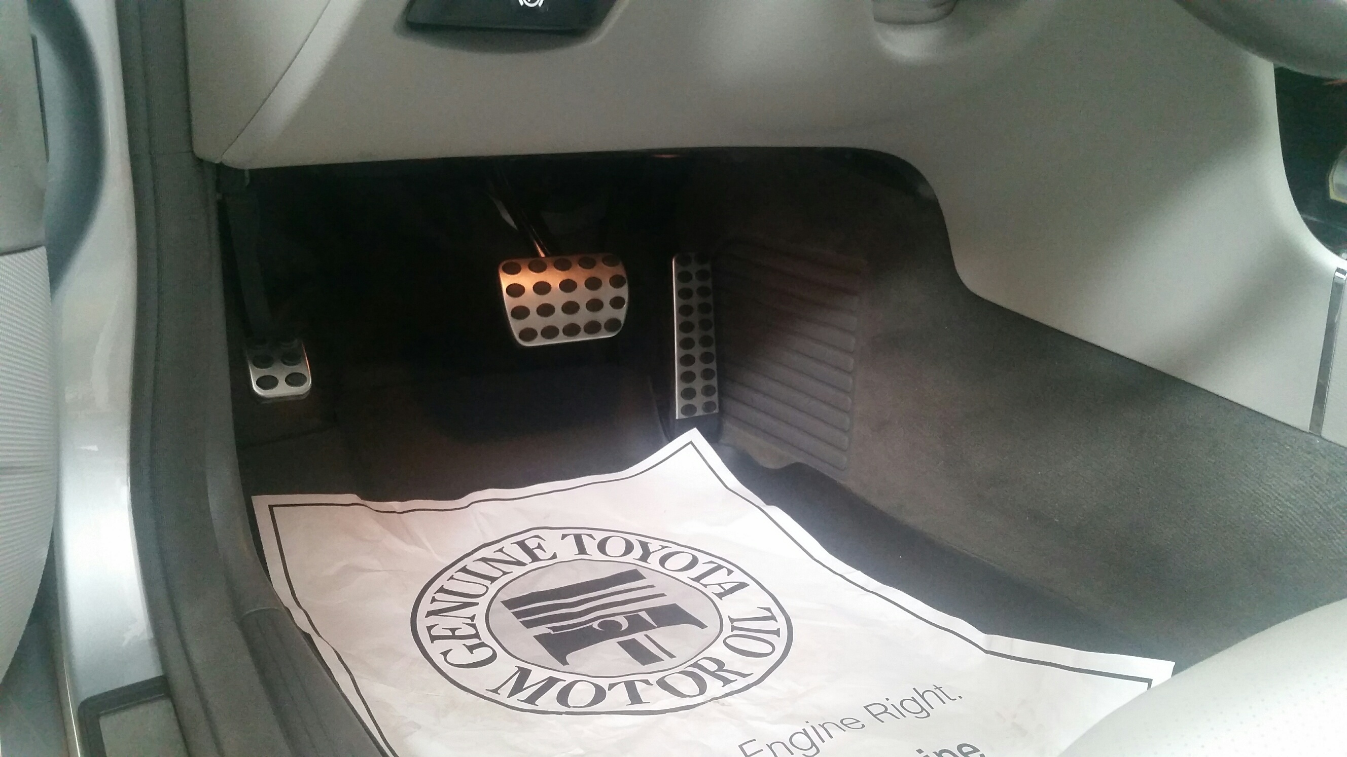

Welp answered my own questions..lol
Pulled the pedals right off of our CLK. Took all of 10 minutes, 7 of those being the gas pedal and that silly pin.
w00t w00t for free nicer looking pedals.
Swapped over the black cheap plastic looking ones from the 211 to the 209!
-Nigel
