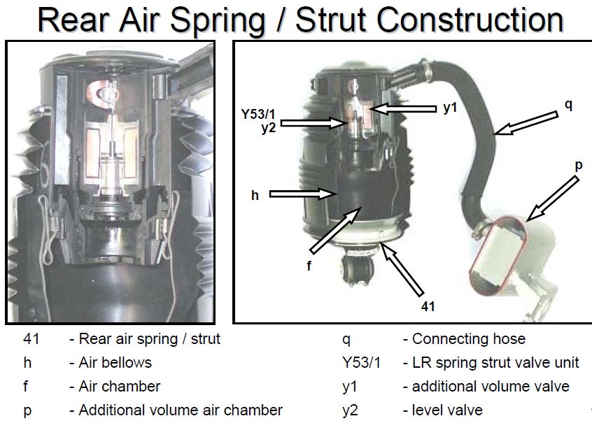

See image for internal components to rear air bag, most likely valve malfunction requiring air spring replacement.

You need some MB diag equipment. Everything height related is based off voltage. Since there's only 1 sensor in the rear something mechanical (someone already noted) is defective or not working as designed.
Don't think the ADS rear shocks are self leveling persay, those are there for damping purposes.
