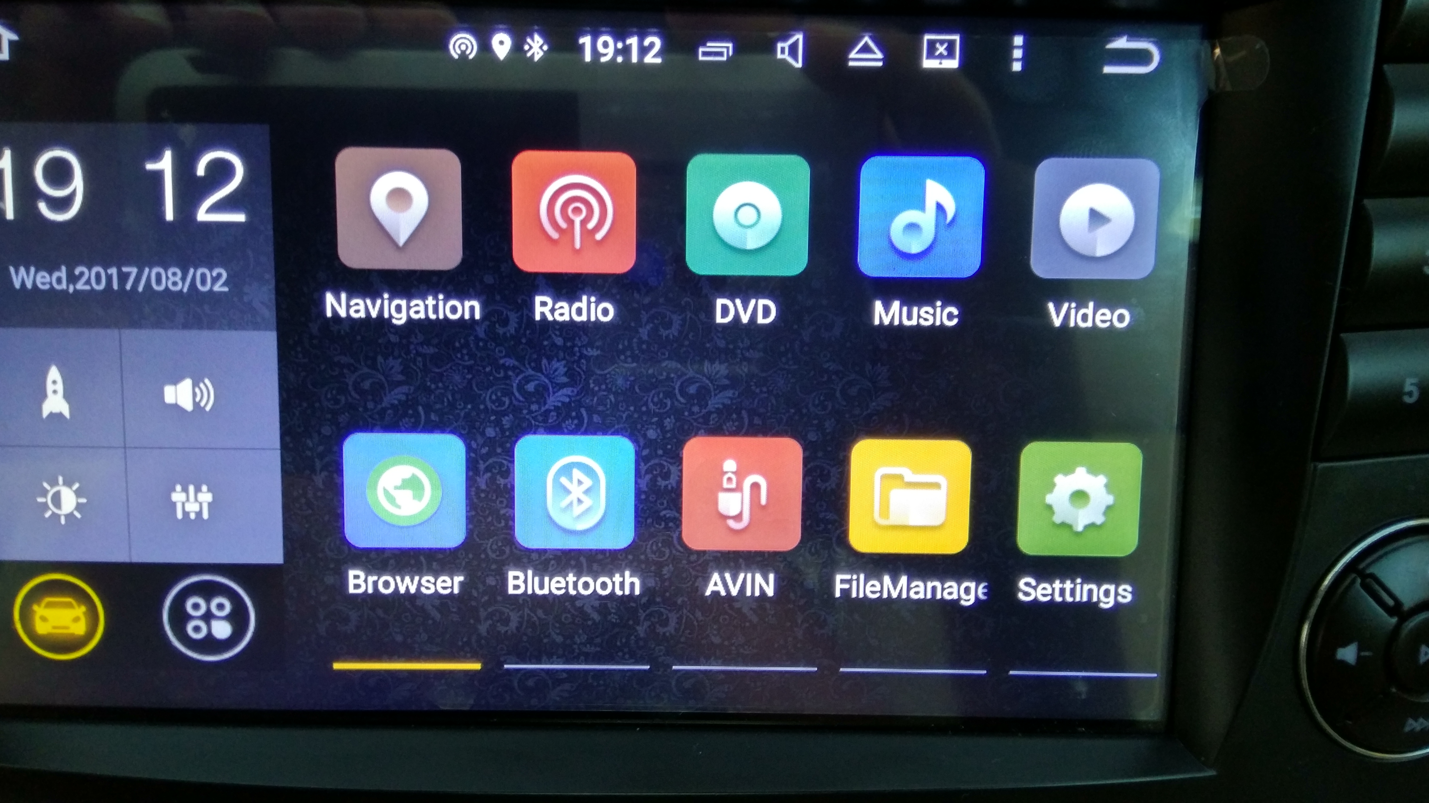

After playing with the radio I finely discover that selecting the "DVD" application enter enter CD playing mode (Hello, AVIAN. was it so hard to add a singe A4 sheet explaining?). The application feel very primitive, all you can do is: Enter/Exit folder, play/stop, forward and backward. I couldn't find a way to display the tracks names (and when you have 50+ folders and sub folders its a must)

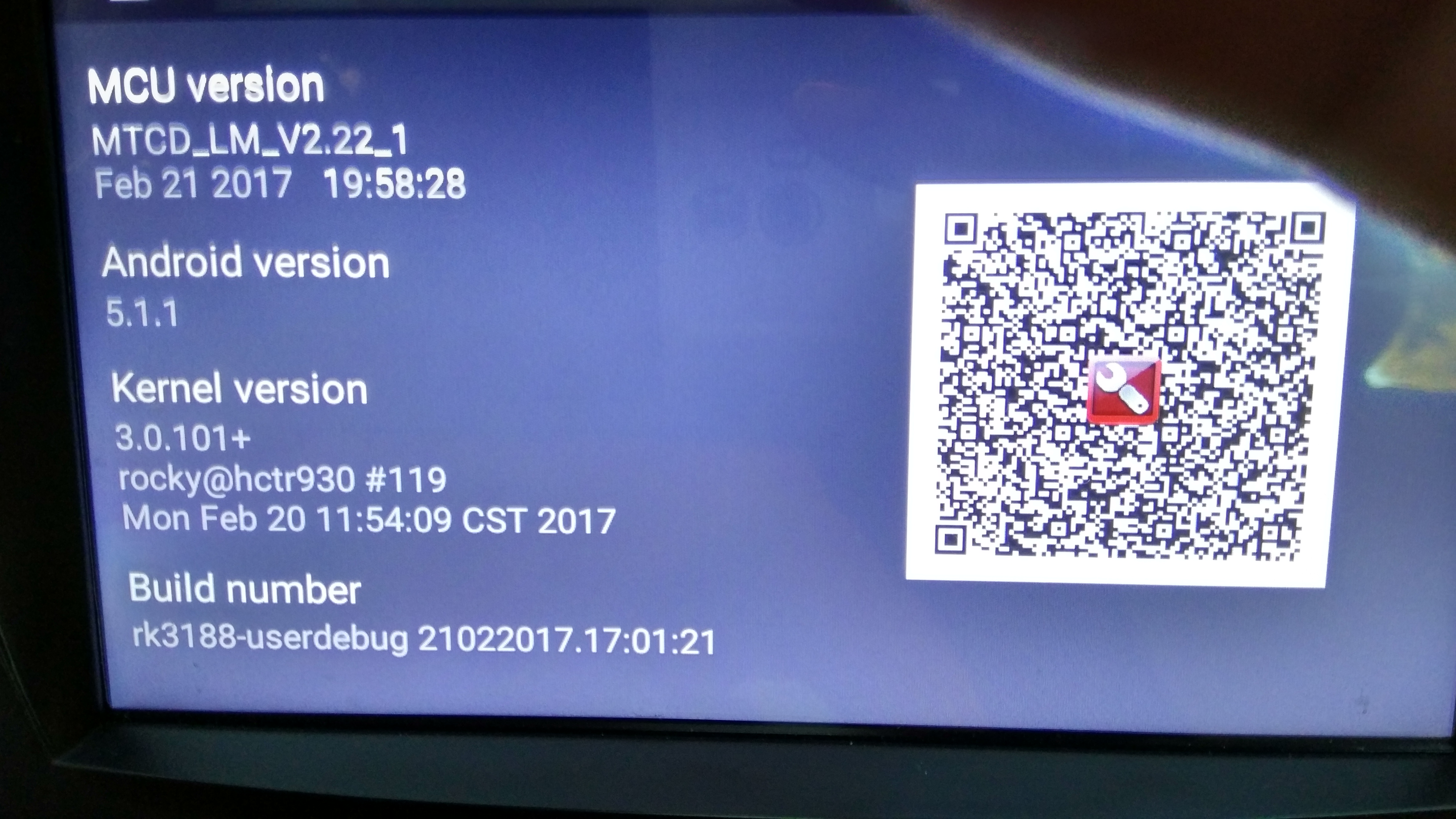

I'm not sure it possible
I'm not sure what radio I was given, the Chinese don't answer my mails (you can read " https://mbworld.org/forums/audio-electronics/637530-w211-2011-need-help-faulty-avant-2-radio.html#post7218284"). More than that, i was confuse when i start solving the problems because according they clam its an Android 6 radio (https://avinusa.com/mercedes-benz-e-...w211-w219.html) but its actually Android 5.1.1.
It does make sense a new firmware will solve some of the problems but where can i find it? beside, i don't know if the radio is root.
I've never heard about the Malaysk ROM, could you point me to see if it fit my radio?
By the way, does any one know what the 'AVIAN' button do? when i press it it ask for password...

This link should have all the information you need. Good luck bub.
https://forum.xda-developers.com/and...-mtcb-t3394209

Thanks, but I'm not familiar with ANDROID
How can I verify i have correct HW for the update? Its 5.1.1 update, not 6 like i hoped...
Thanks
BTW, the link transferred to https://avinusa.com/mercedes-benz-e-...w211-w219.html
Still, they said it android 6. I wonder how *** i got the 5.1.1
