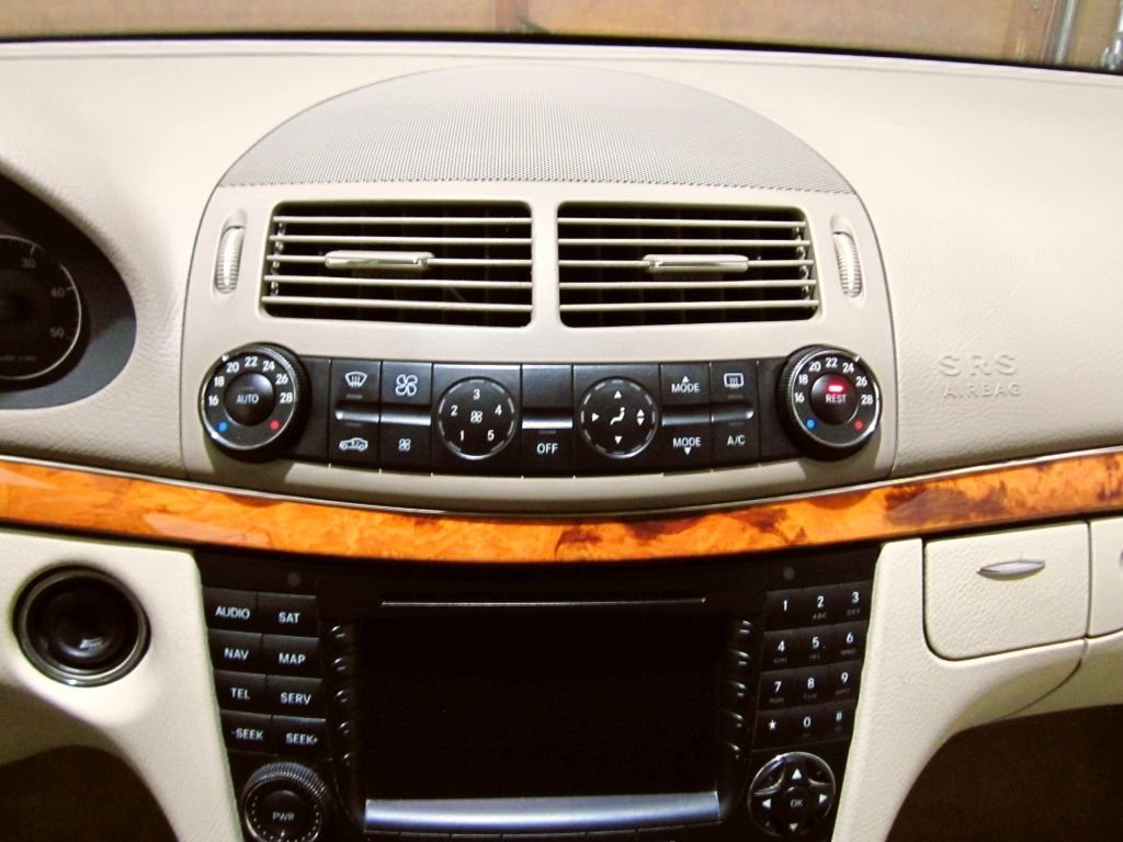

I recently switched out my climate control unit for one with a REST button. As some of you know partway through the 2005 model year MB removed the REST button from all U.S. bound W211's (while the rest of the world continued to have the feature until the end of the series run). It took some research to find the correct 2-zone unit for my car, as there are multiple different units (and part numbers) depending on the year, equipment line and climate control system.
With the part number verified, I found an inexpensive used climate control unit on eBay and had it shipped from overseas. The picture tutorial that Drag0na5h posted was extremely helpful and I was able to get my old unit removed and the new one installed without too much trouble. Then with my SDS, I erased the stored codes and reprogrammed it. A necessary step as these units are not plug and play, especially if there are codes stored and/or you own a diesel (a unit from a gas car will not have the electric heater booster setting enabled). So far it's working great!
kajtek1, REST being display on the later (07+) digital climate control clusters in certain conditions is (I think) due to the "Air dehumidification via evaporator" feature to help remove moisture from the A/C system. See the below SDS screenshot.
