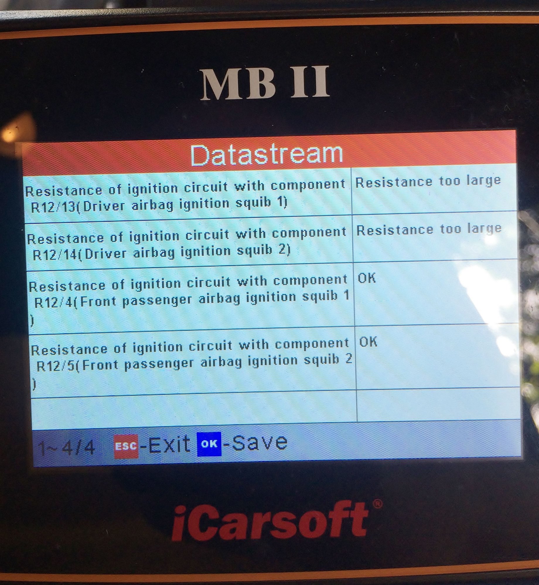

Resistance of iginition circuit with component R12/13 Driver airbag ignition squib 1, Resistance too high ?
Resistance of iginition circuit with component R12/14 Driver airbag ignition squib 2, Resistance too high ?
Both codes according to icarsoft MBII & SRS light on,model Mercedes 2006 W211 E200 Kompressor (Pre face lift)
Any help will be appreciated !

Mar 29, 2018 | 09:31 AM
Airbag squib error
Error code
Reply 0

iCarSoft gives the exact same error as pictured here. Resistance too high r12/13 squib 1 and Resistance too hi r12/14 squib 2

I get EXACTLY the same error as you. I have the same iCarSoft diagnostic tool.
My screen is a duplicate of yours.
