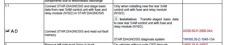

Now the only thing I am unsure of is the SAM module, when it is replaced will it cause issues with a radio not working? I dont want to spent the money to have it programmed to my car if its not going to solve anything.
FWIW next step need to have someone check for fault codes and transfer / code data specific to your vehicle before moving to replacing parts.
