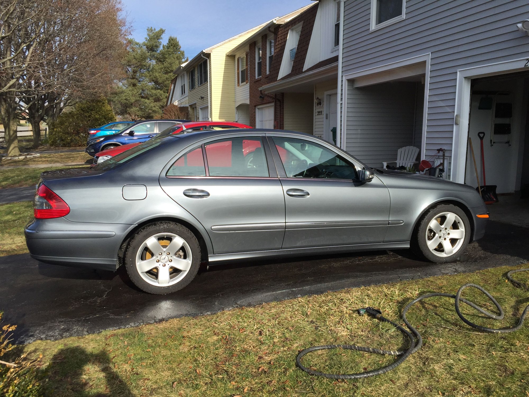

The ones that mine came with are these:

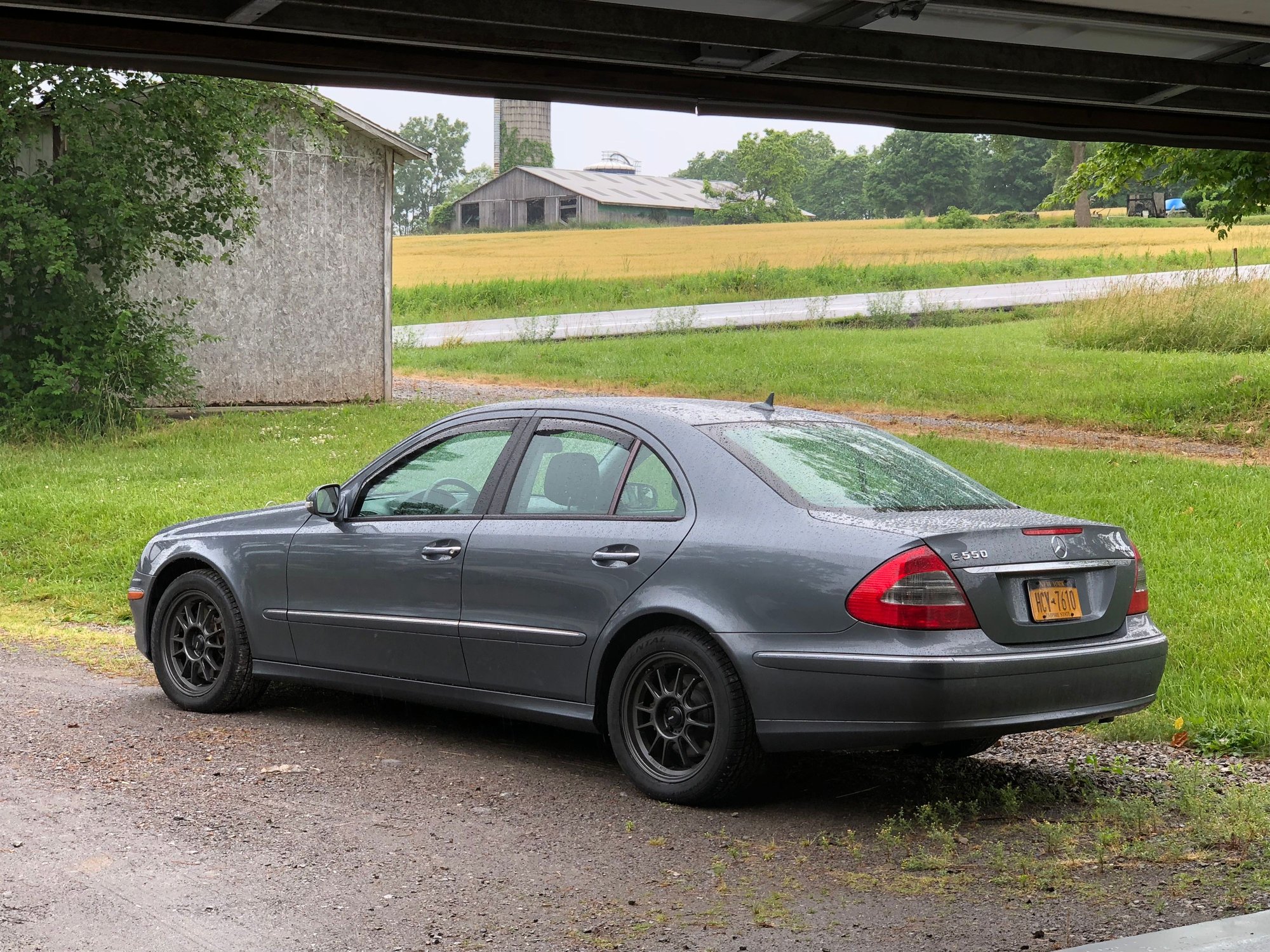

Winter/all season
I run my snow tires (hakka r2) in 225/50/17 on the stock wheels, and a set of all seasons (conti dws) 245/45/17 on the Konigs. The stock wheels are easier to clean, but I prefer the look of the darker wheels.

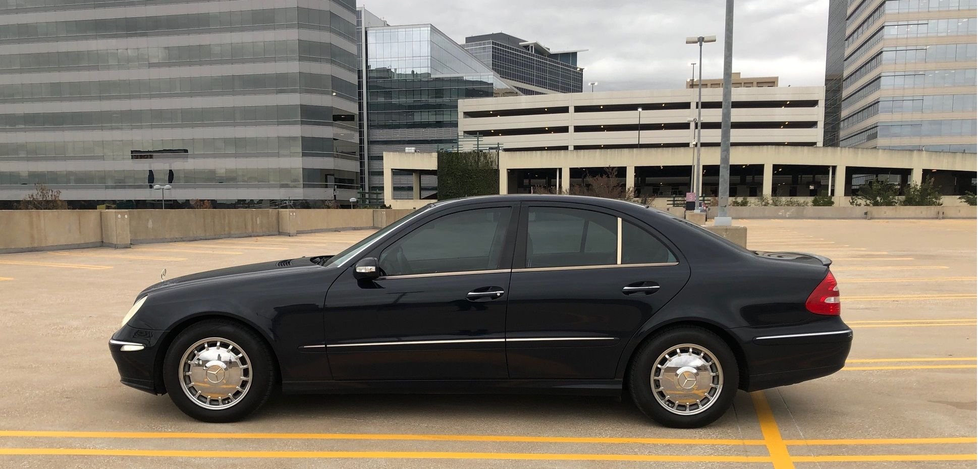

When I bought the e320 it came with these chromed 17" wheels and some garbage "Mirada?" tires. I don't like chrome wheels.
Eventually found some stock 16" E320 wheels with nearly new Michelins on CL. Ride quality and noise improved a lot. I paid $150 for the set and sold off the chrome 17" to some guy that was really excited about chrome lol.
I installed th 16" wheels with 20mm spacers. The tires are 215/55R16 so 30mm narrower than the 17".
I also have a set of W140 16" wheels with Bridgestone blizzaks snow tires 215/55R16. I've used these on both the E320 and C320 whenever we go up to the mountains. They're fantastic on snow and ice but noisy at freeway speed. No spacers to leave clearance for chains if required.
Yes you can drill out other M12 wheels to M14. I've done it on my full size spare, it works but I wouldn't recommend it.

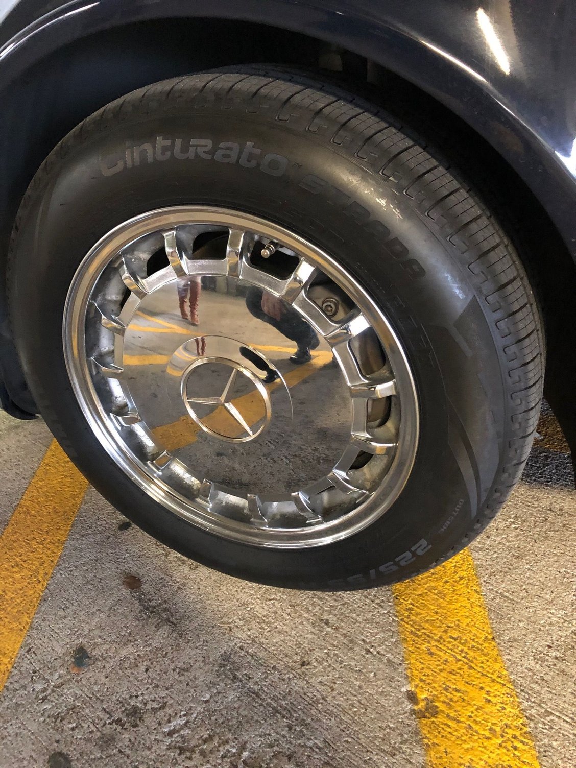

So I found a really nice set of 4 chrome 16x8 ET34 Gullideckel wheels from an R129, came with the original tires from 1993 with plenty of tread left!! Of course those were way too old so I got a set of Pirelli Cinturato Stradas in 225/55/16 and in order to mount these wheels without permanently modifying either the wheels or the car I did a stud conversion with these: https://motorsporthardware.com/produ...14x1-5-12x1-5/ and the 17mm hex M12 lug nuts they sent with them. They would not look very good with the lug holes visible, but luckily the wheels came with some (apparently aftermarket, and rare) center caps that cover the lug holes. At first I did not like them so I installed them on only one side but they grew on me quickly. Gives the car a really neat classic look. Oh and it rides like an old school Cadillac on a cloud of marshmallows but still handles very well, at least as well as I need a daily driver to handle. Overall I am very satisfied.

One thing I've noticed is these new tires are very sensitive to pressure compared to the 17" Pilot Sports I had before. When I first got them they had 35 psi all around and rode almost as firm as the Michelins. I adjusted the pressures to match the pressures in the inside of the gas filler (29 psi front / 33 psi rear) and they felt floaty and disconnected with quite a bit of understeer. Surprisingly, they also felt somewhat harsh, especially over big cracks. I then went to 32 psi all around and they handle great! Car feels light and nimble, and glides over all but the worst road imperfections so smoothly it plays tricks on my mind! Like I know I saw that crack, but I didn't hear or feel it at all! Just hope I don't constantly have to fiddle with the pressures in these to keep them right at 32 psi because the temperatures change pretty rapidly down here in Houston.
