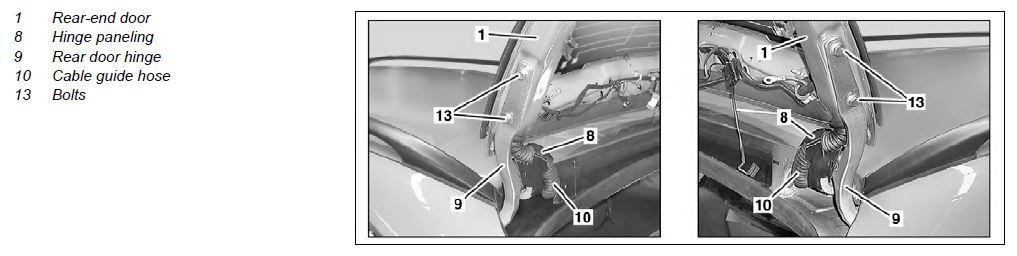

Check rear SAM connection, wiring in cable guide hoses, inspect wiring/connection/stop lamp. You do not mention model year so I attached all relevant if replacement needed, need VIN if you want part #.
