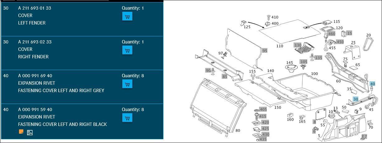

Hi, I've just registered for MBworld now and I hope my question it'll be answered, I want to replace the two trim around the trunk lip and I don't see how the plastic screws or bolts can be removed, i couldn't get a hold of them can you tell me how did you remove yours?

https://mbworld.org/forums/e-class-w...-leak-fix.html

hi konigstiger, I really appreciate your response, yeah I saw this picture before and I was wondering if those plastic clips can be removed from the top or do I have to remove the trunk side liners in order to get access to the bottom of the expanding clips and push them from inside out? because They are flat and laid low, I have tried to remove them gently using my set of plastic clips remover tools, so I did not want to go aggressive on them before i made sure what's the right way to take them off, lol I was worried not to break them, i never thought of replacing them too, not anymore after your reply with the attachment that includes the Expansion Rivet part # again thanks very much
