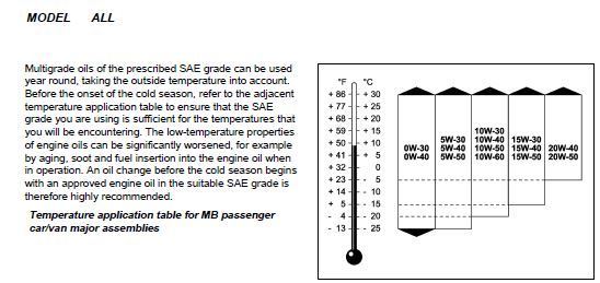

The Owner's Manual (Pg. 398) lists 10-30W as the recommended weight for my temperature zone.
relinuca
I always use 0w40 m1 european formula from walmart
something is off. these cars do not use 10w30 otherwise I would be cheapin out and running $1.50 a quart farm and fleet oil.
relinuca
0w40 should theoretically be thinner at start up than any 10w30, so unless you’re in Antarctica and the engine never gets to operating temperature I don’t see why anyone would ever need 10w30.
i did a quick google for 09 e350 oil type , and sure enough it says 10w30 on reference chart lol
relinuca
What country are you in? MB recommends 229.5 in the US. There's no 10w30 that meets that spec here.
