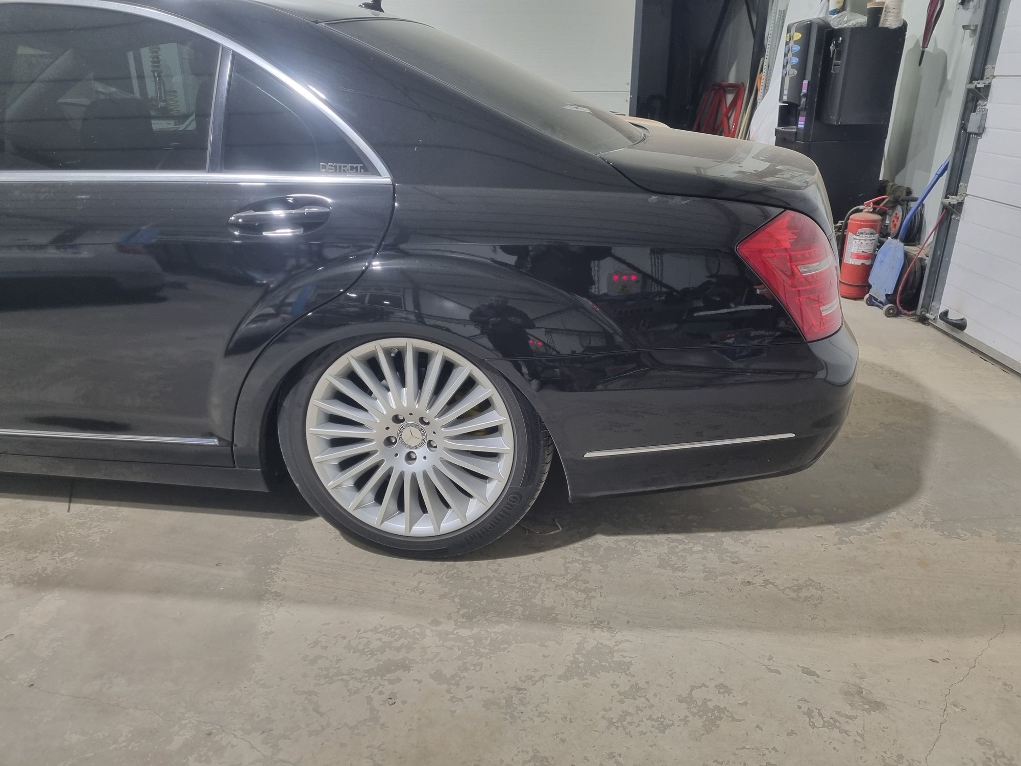

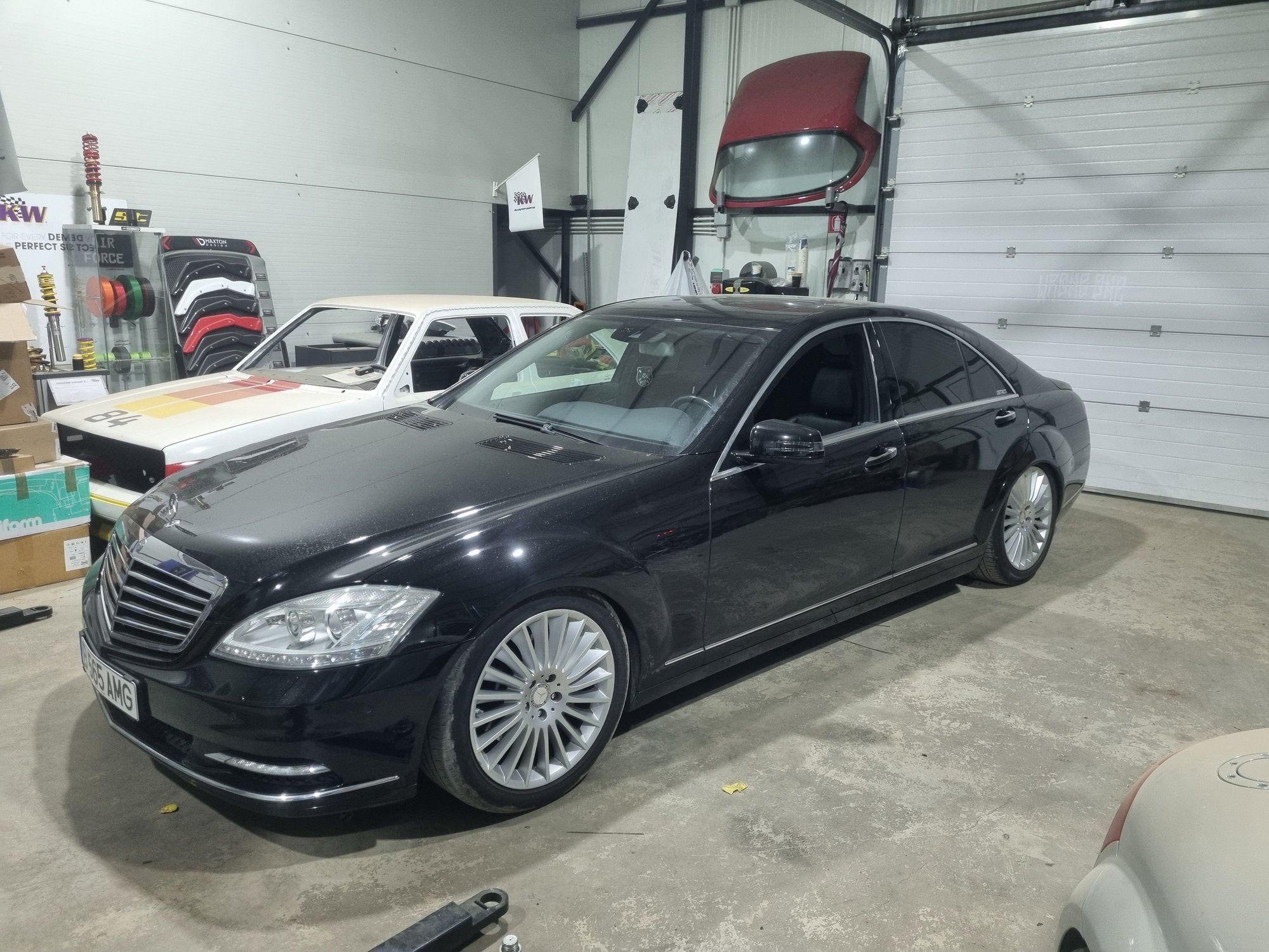

I own an S250 W221 from 2011. I installed lowering link on my suspension. Worked fine....everything.
One Saturday, when I was leaving from work, after I washed my car, suddently my rear fell down on bump stops. This happend in about a mile, as a distance. Everything was bouncy. Rear suspension was down. I reached my garage, where I have a ramp. I saw the rear level sensor lever not connected. Connected it...nothing happend.
So I bought a brand new level sensor, and brand new bracket (my old one was rusty). Installed them, nothing happend. Compressor not starting.
ERROR is the same as my colegues above.
I checked the compressor - it's ok, running with direct wires.
I checked the airbags - all 4 are ok
I checked the level sensors - all 3 are ok.
With the diagnostic tool , LAUNCH, I manage to erase the error. But the car still lays down.
Can you please help me with some ideeas. A friend of mine told me, that the relay is OK, and the 40amp fuse it's OK also.
I don't know what to do from now on...
