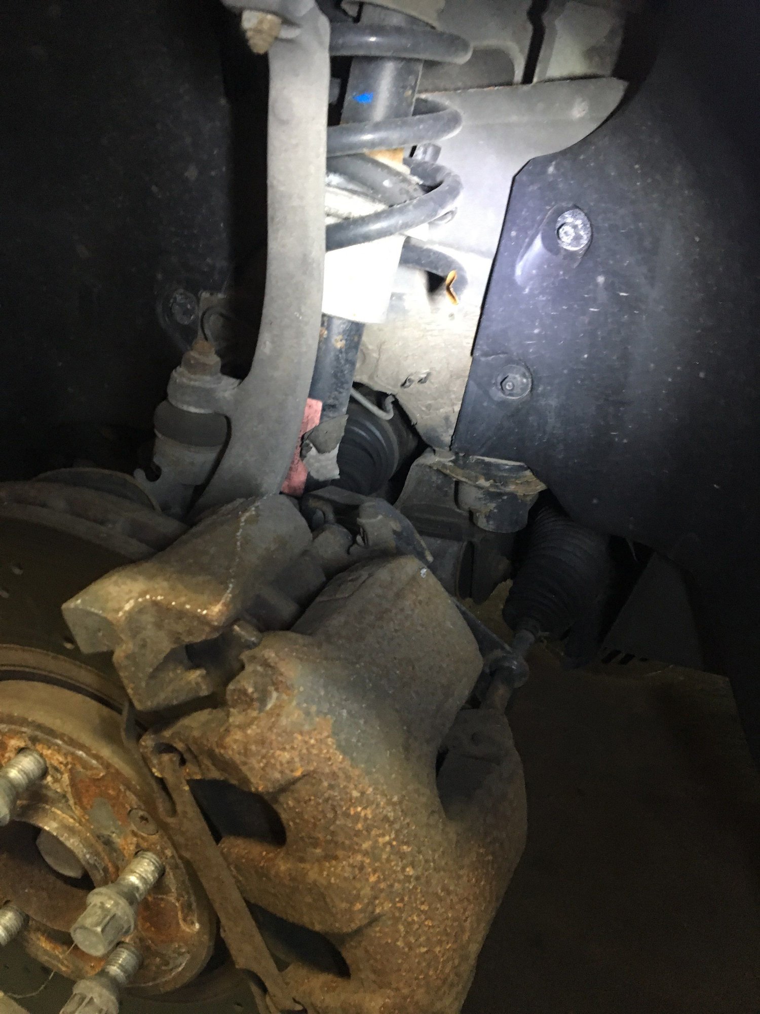

My front springs broke. What replacement do I buy?
Hi All.
After hitting all the dead ends I could, I finally relented and am posting here. I figured it's time to join the MB world community anyway.
So here's the deets:
09 E350 4Matic Sedan, non-airmatic suspension.
Long story short, my front springs broke at 110k miles (seems to be a common problem) and I'm looking to replace them with a shock and spring kit, already assembled.
So far all I can find are airmatic to spring conversion kits. Do they work as a plug-and-play replacement for the standard springs? Any help on this subject would be mucho appreciated.
Thanks in advance!

nobody sells an assembled kit that i can find.
best bet is to call your local dealership with a VIN and order a spring. MSRP is only $75-$95 depending on whether you have the sport package or not.

I just did the front springs/struts on my 2008 E350. You have to get the springs from Mercedes no one sells an aftermarket one. Figure out the part number using EPC or post the vin and someone will look it up for you. There's also a color coding on the spring, there's usually two dots on it, the colors will tell you what spring to get. There are no quick struts for the E350. The toughest thing is going to be to compress the spring. It will cost you more to replace it with airmatic than to just replace the springs/struts. I used the Bilstein struts, they're cheaper than Sachs by far although Sachs was OEM. Once you have the part number, you can google to find some local MB dealers that sell them cheaper online. I got mine for about $70 each and shipping wasn't that bad as it was just one state over from me. I think I went a little overboard, got the rubber isolator and the mount, maybe could have skipped the rubber isolator and reused the old one. FCPeuro also sells a kit from Sachs that had the bumper stop and the cover. Basically if you get all that, you don't have to take apart the old spring and you really have to crank down the spring so that's best to have a shop do it. You do kinda need the old one to measure the height when changing the struts as it comes set at the 10th stop which will be too high, depending on whether it's 4matic, sport, luxury, could be the 2-4th ring, you just match it up with the old one so that they're the same height.
You do have to take apart a bunch of stuff to get at it so I hope your sway bar links, ball joints, tie rods, control arms etc are in good shape, otherwise now would be the time to do them as it all comes apart then.
