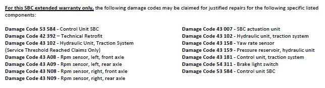

Are any of these connected to the SBC Warranty replacement? I'm assuming that they are older
occurrences, but don't want to reset them if it will null any chance of getting it replaced should that be the solution.

Could be or have been auxiliary battery (engine compartment) low voltage. SBC is covered for 25 years from in service date, clear codes see if any return. A73Y2 returns, it is internal component have dealer check it under warranty.
