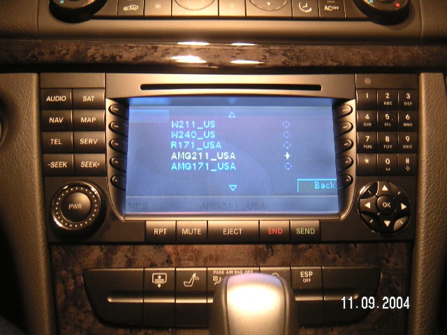

Okay, thanks for your help guys. I got the menu to come up while in CD mode and by pressing the 5 slightly before the 3 and 7, then holding until it comes up (about 5 seconds).
I set it up and turned off the car for about 10 minutes and now I have the AMG splash screen but no DVD video capability. Guess my build doesn't come with the DVD drive.
Attached Thumbnails Secret menu in the 05's COMAND unit.-keyboard.jpg   Secret menu in the 05's COMAND unit.-model.jpg

The strange thing about all of this is that this is not the menu I got into earlier, which is what I thought was the 357 menu. That menu had to do with navigation and somehow allowed me to choose a guide voice with a british accent (the setting/language chosen was English GB). The problem is I didn't shut off the COMAND long enough to let the setting stick. I also don't know how I got into that menu since I was just going crazy with the buttons.
Anybody know of this menu and how to get in?

1. It is not necessary to shut off the car to activate the settings. Just turn off the Comand unit for 5 minutes or so and it will activate.
2. If you set the menu selection to the European W211 setting, you will have the Brit voice along with a few different Audio selections than the U.S. settings. (unless the '05 is different from the earlier versions)
