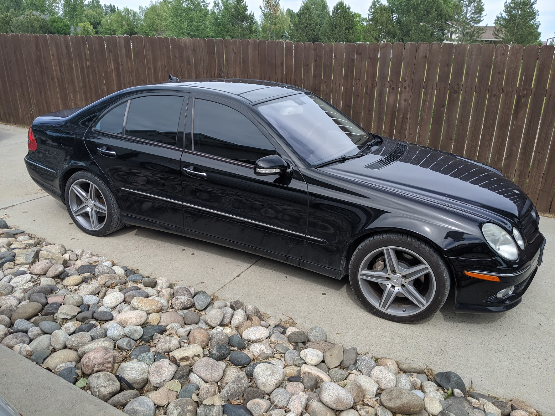

yes i have 245 fronts and 275 rears on OEM E63 wheels, fits great, no stretch

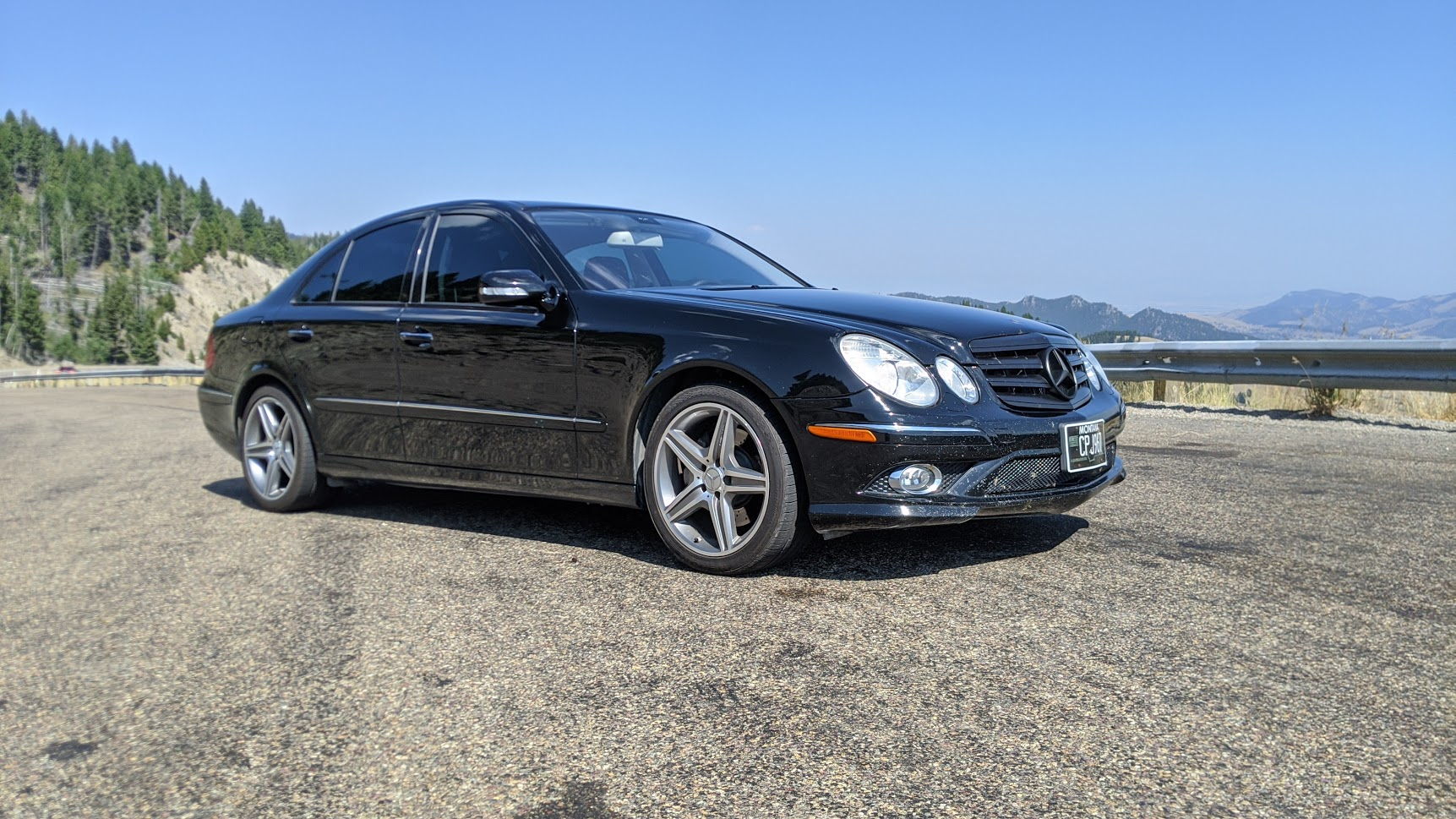

255/40R18 front
285/35R18 rear
On CLS550 wheels. I didn't choose the size It came as a packag with nearly new tires. Clearance is more of an issue in the front than the back. I had to roll the front fenders.
And for comparison, my E320 wagon and my friends E500 sedan on stock 211 wheels with 245 front 265 rear tires. He had 10mm spacers.

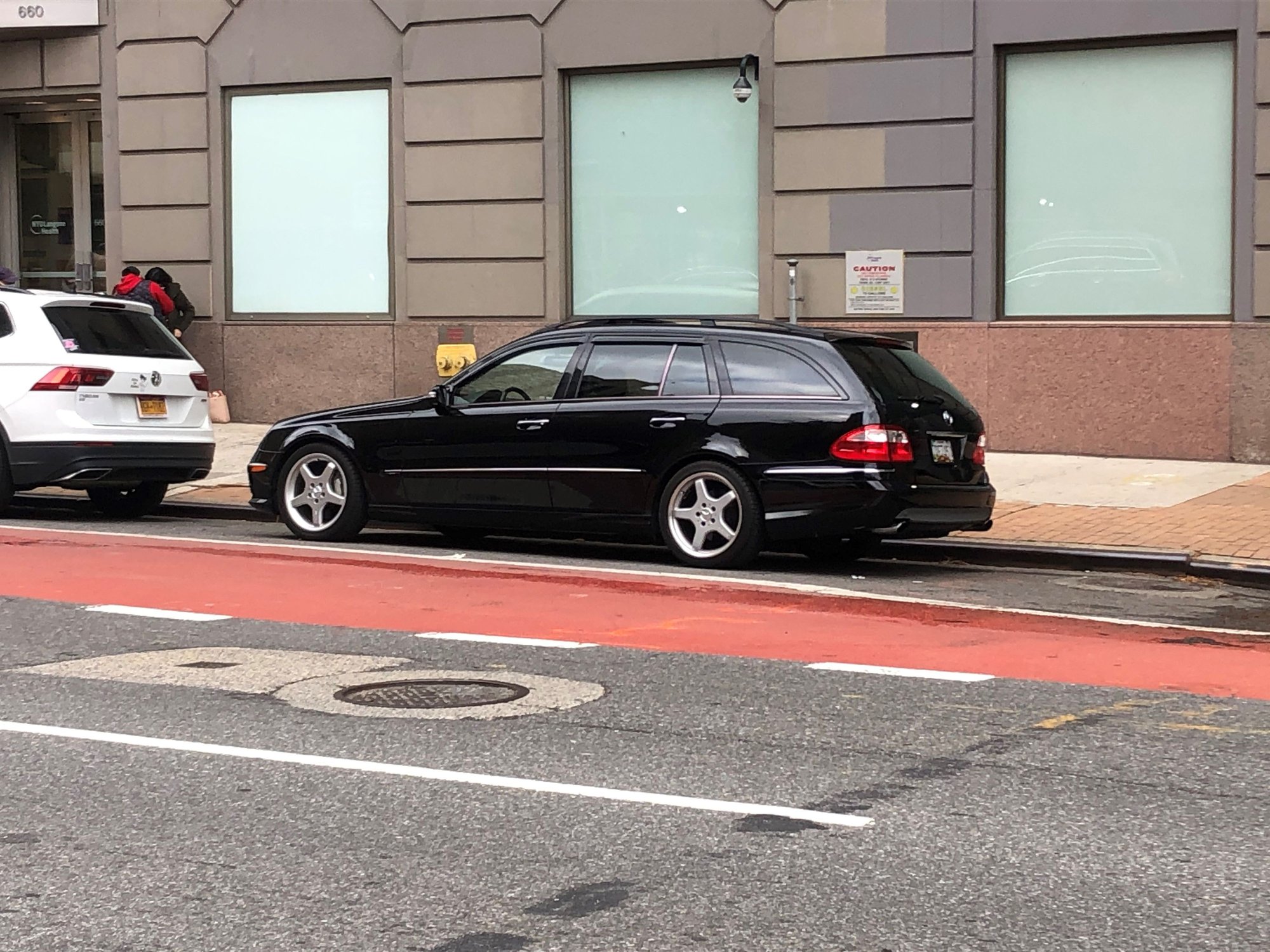

Front are the stock 18x8 the rears are 18x9.5 from an R230

245/40
275/35

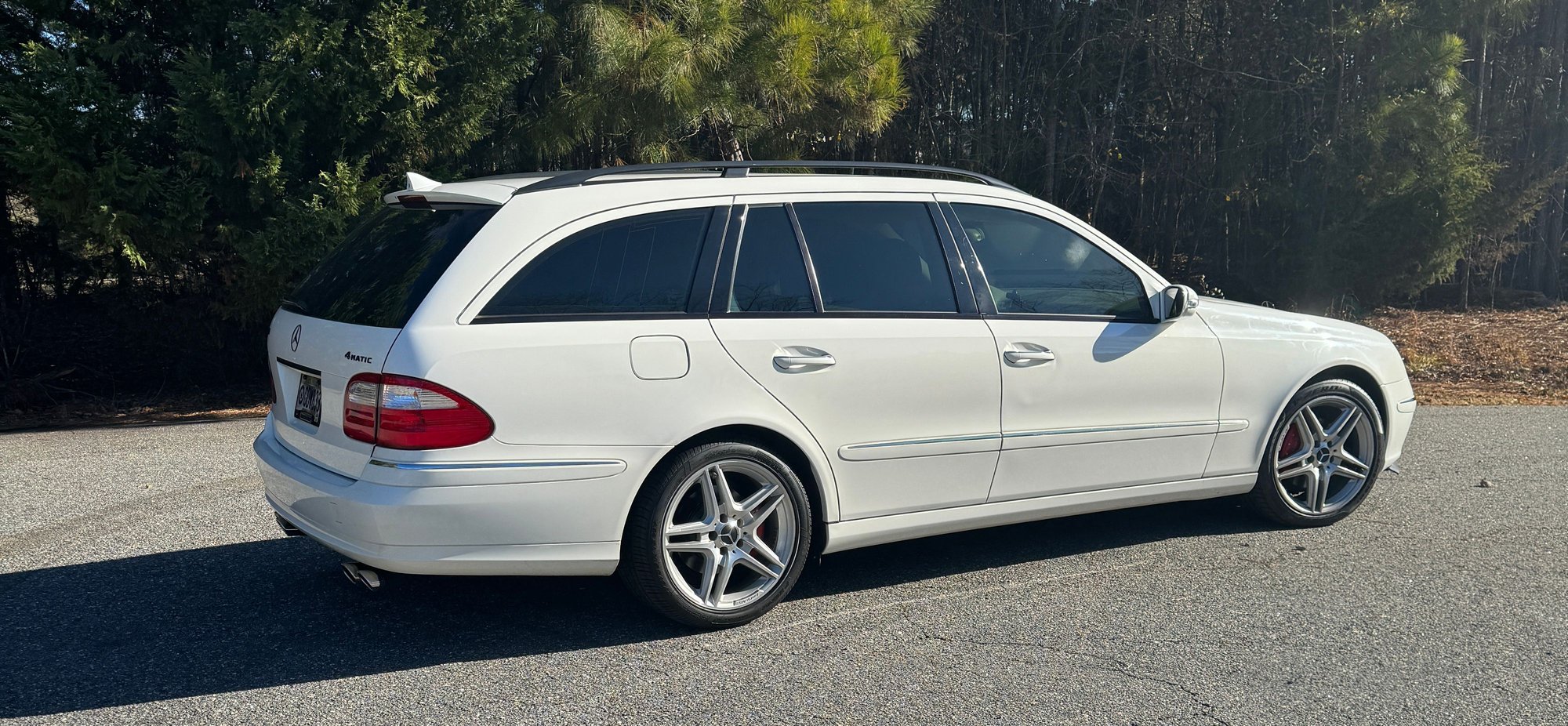

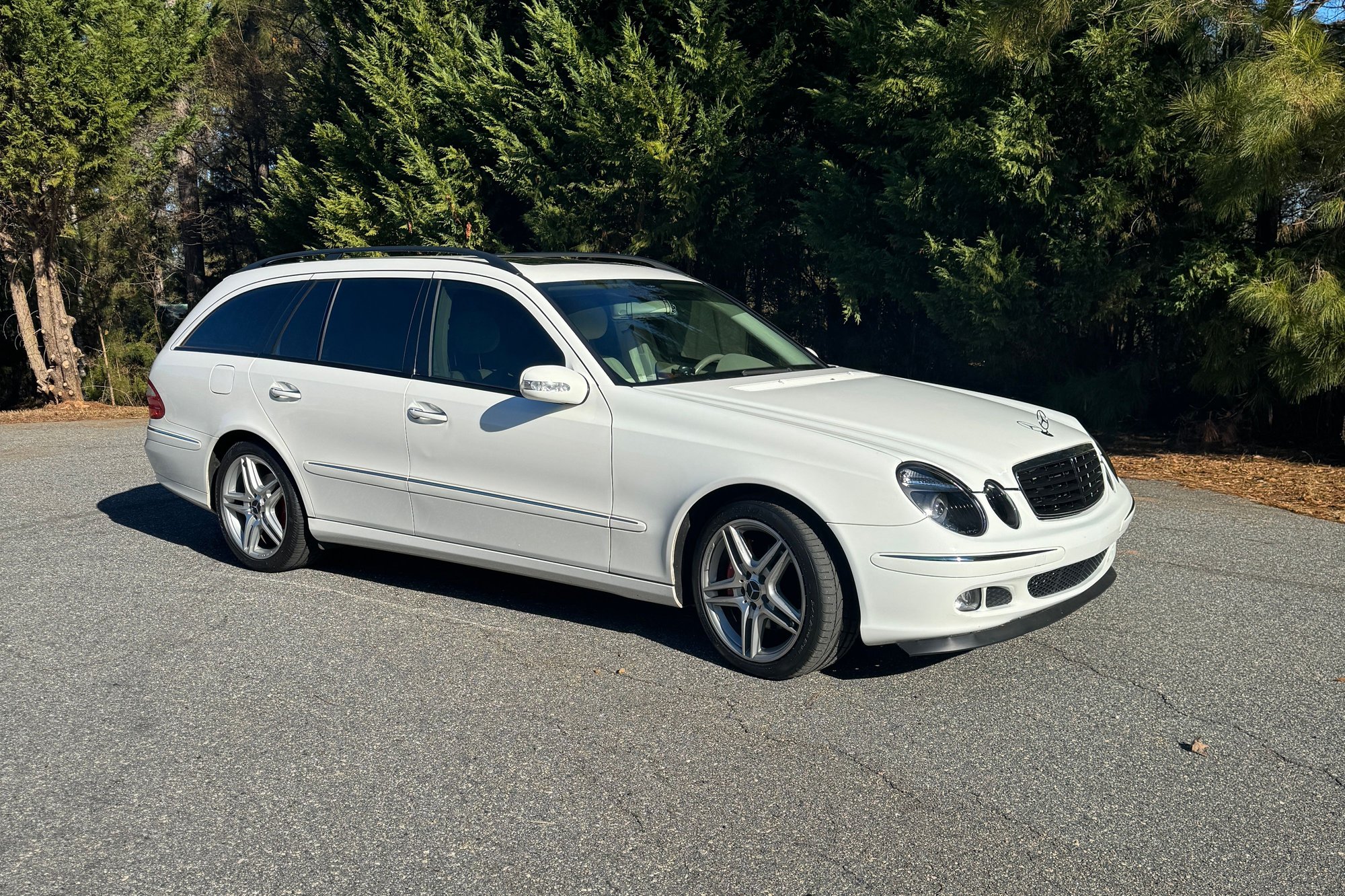

I run 245/40 and 275/35 on 18 inch staggered wheels
I run Pirelli p-zeros
