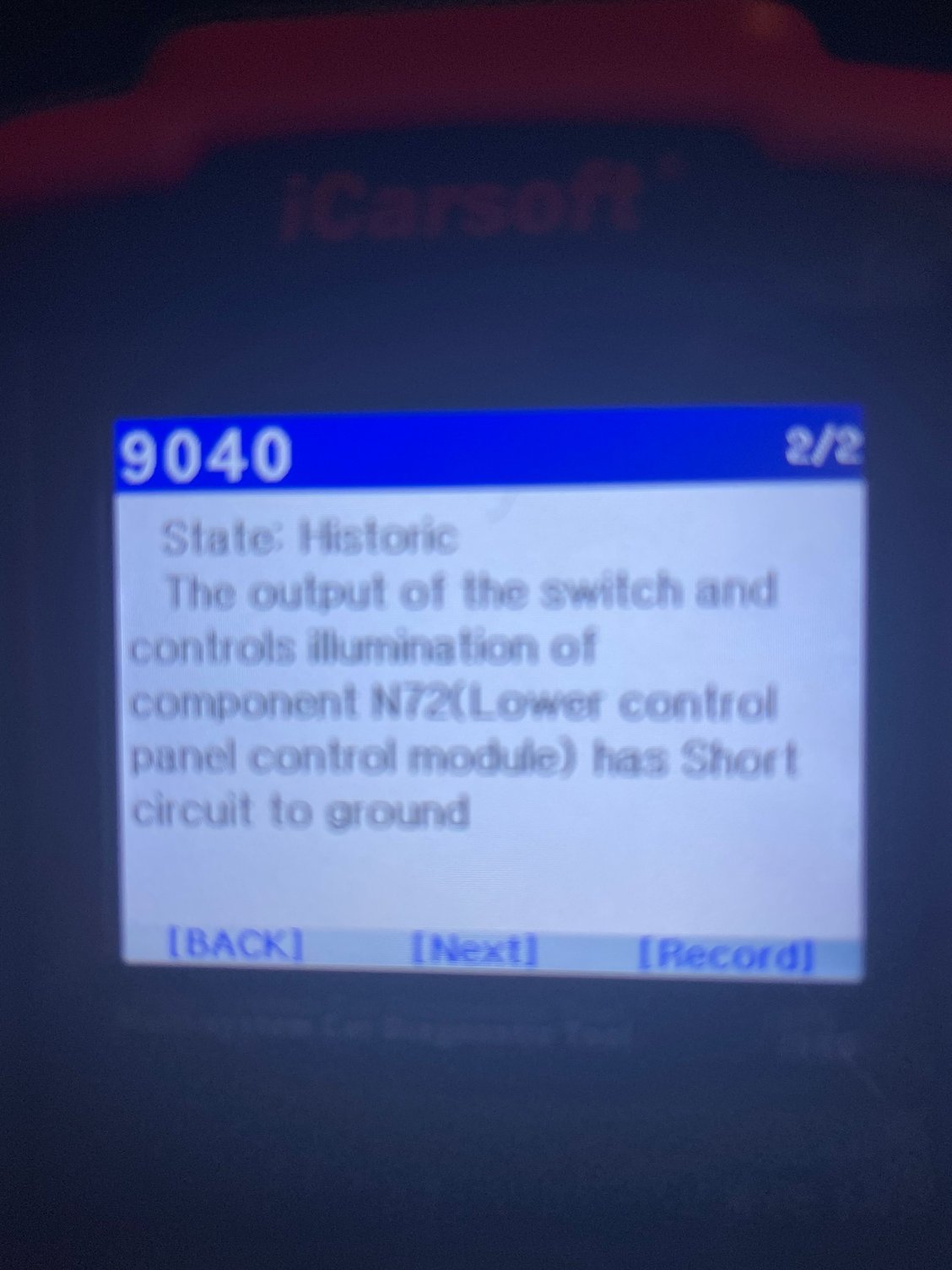

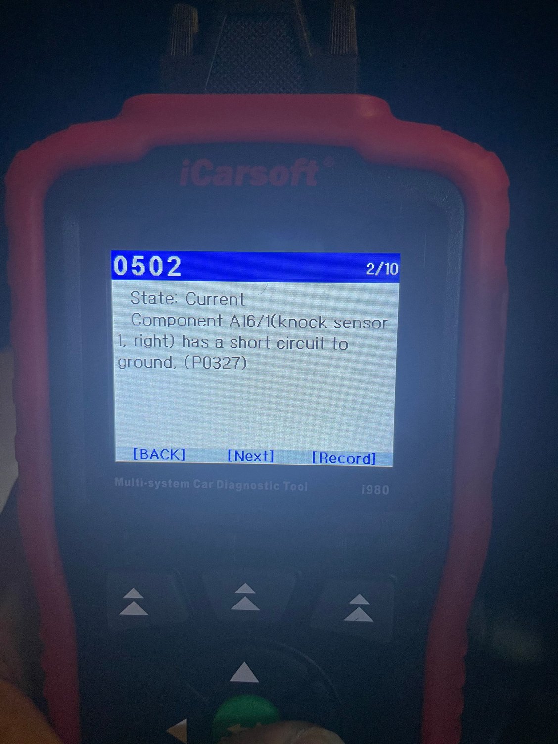

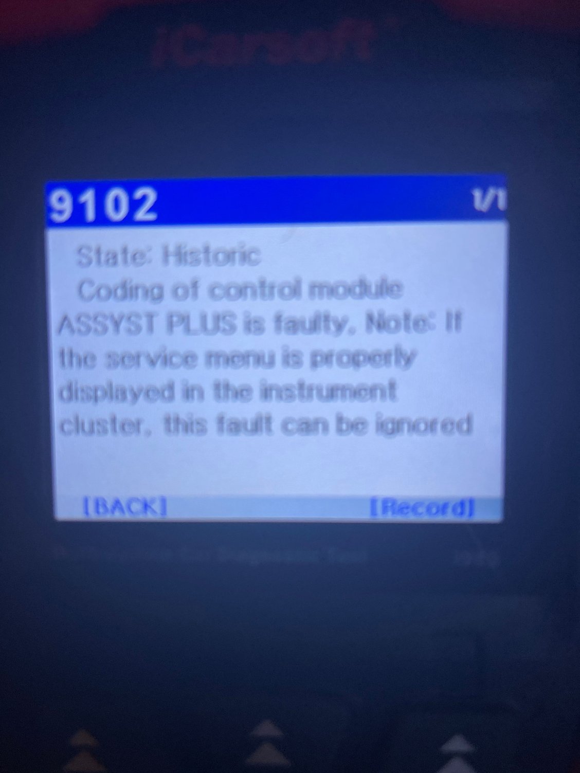

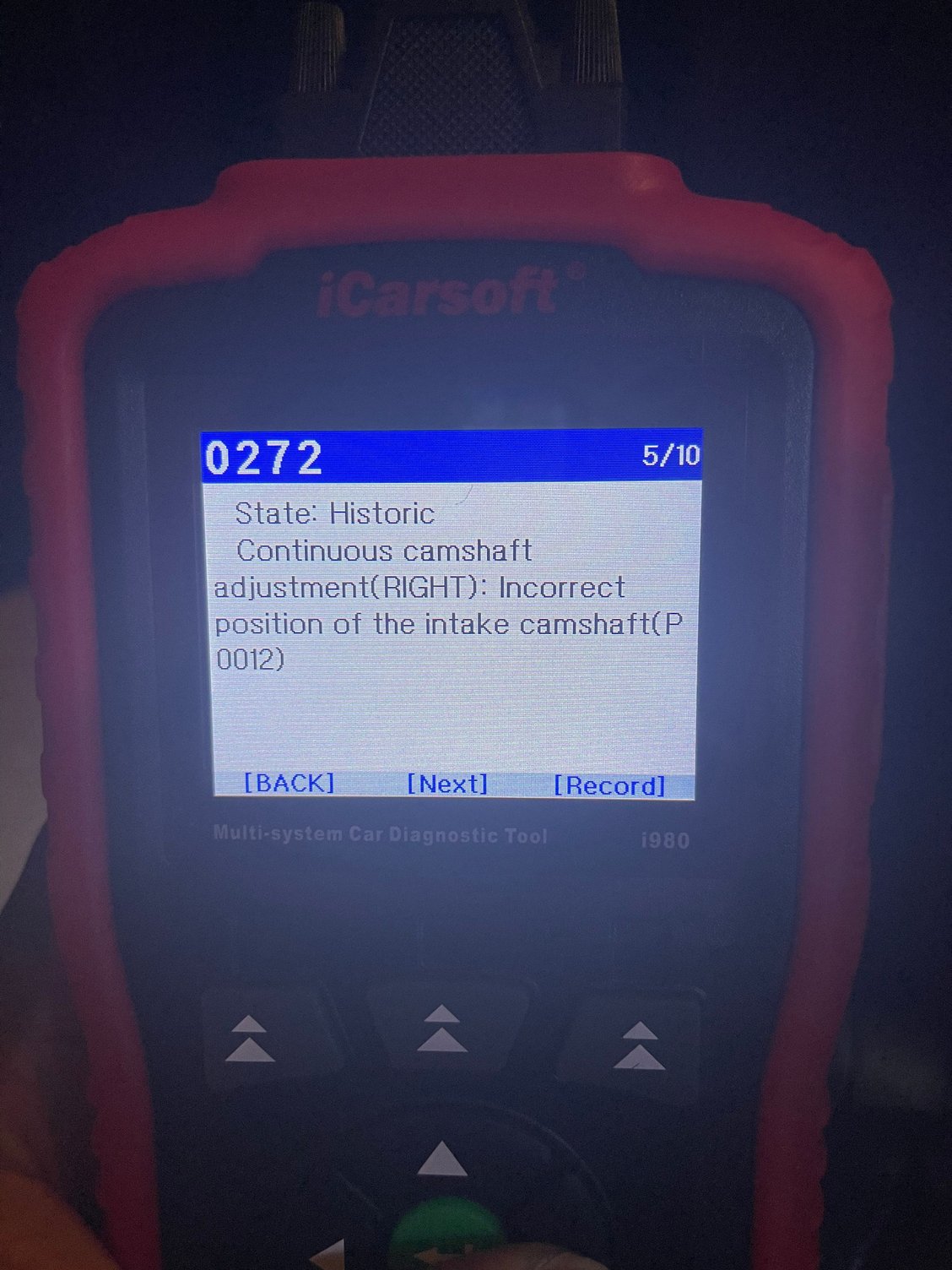

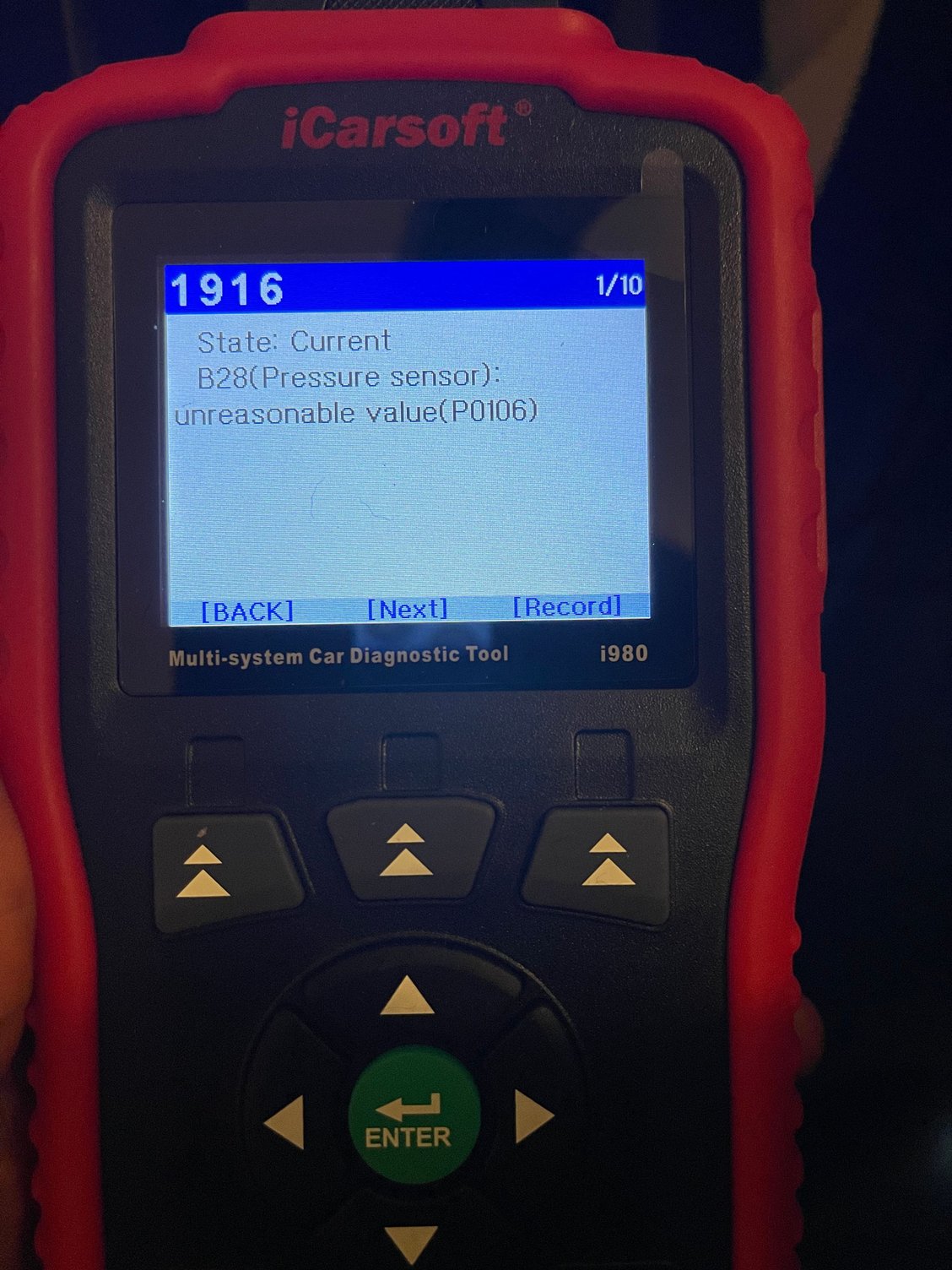

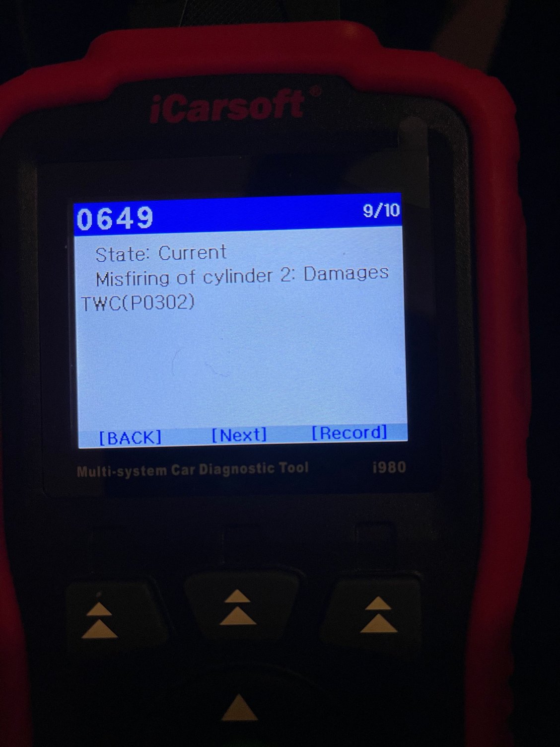

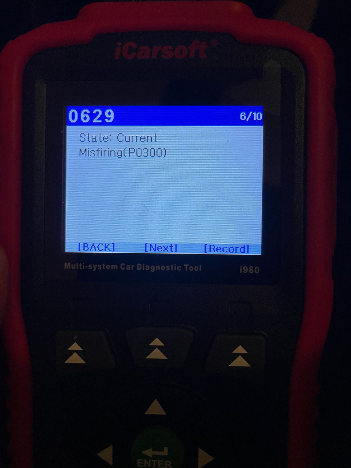

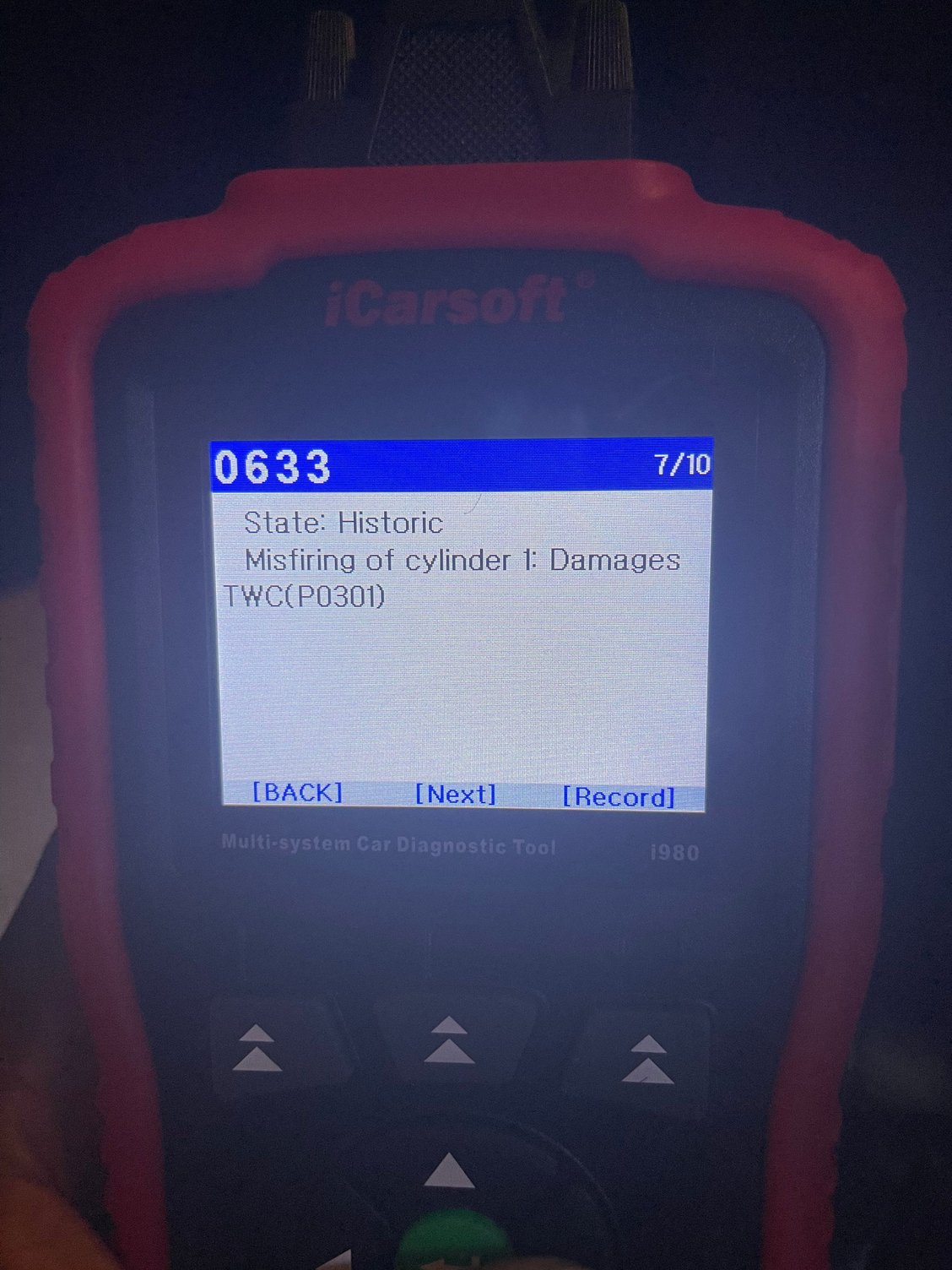

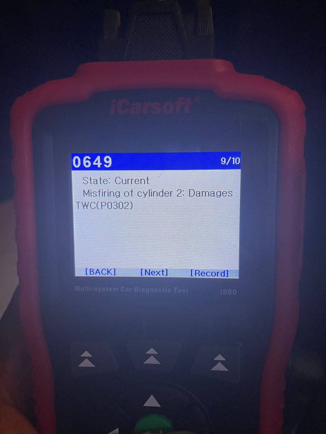

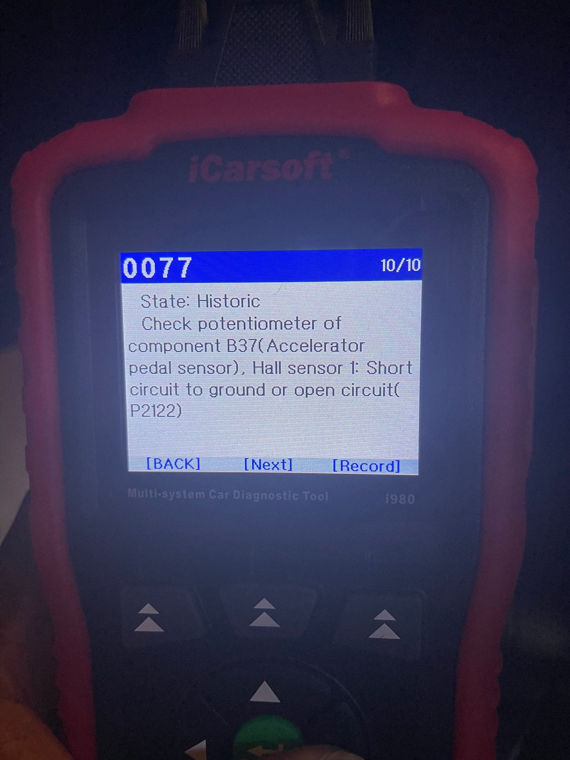

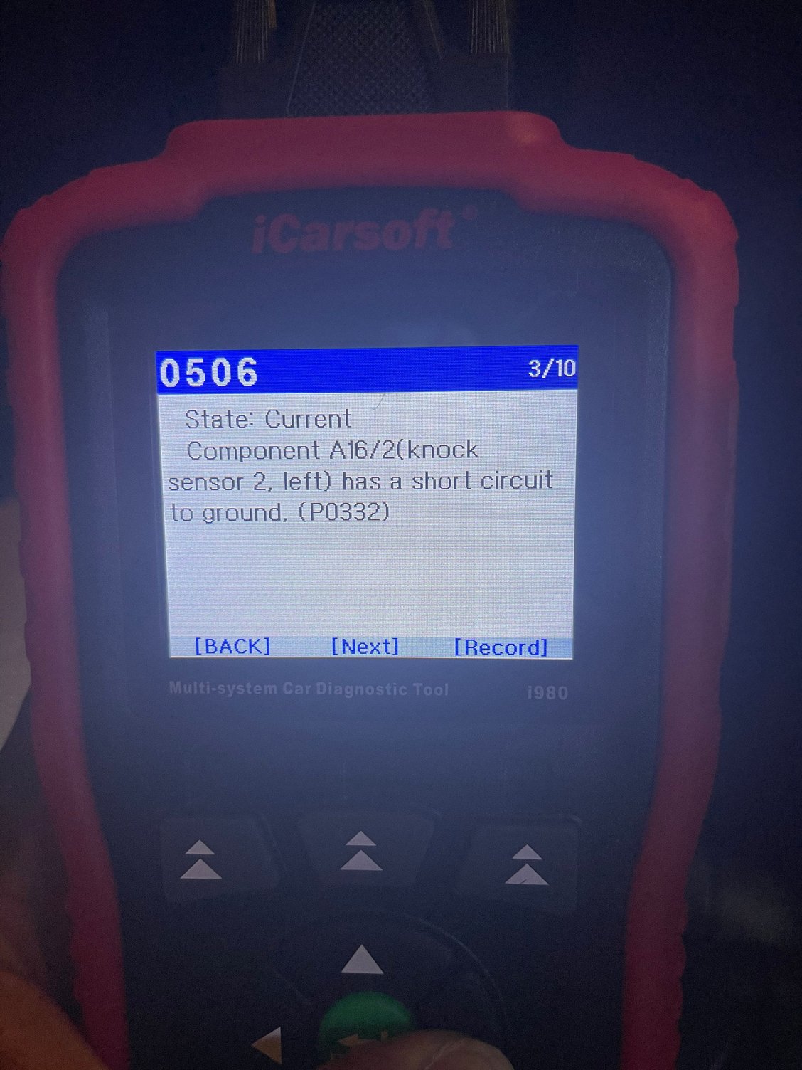

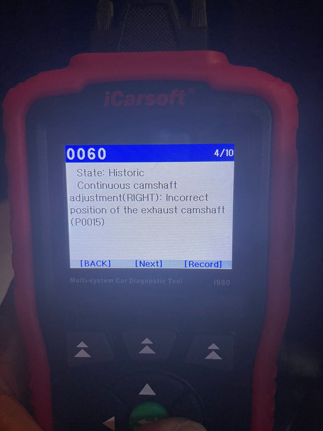

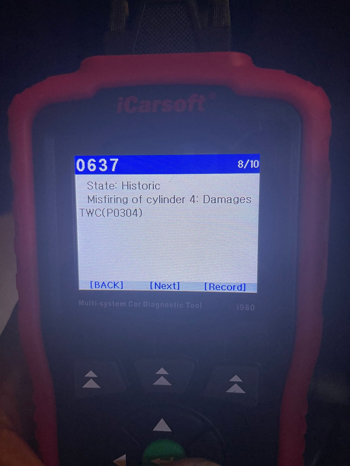

Pulled codes
Old Mar 3, 2021 | 02:53 PM
cetialpha5's Avatar
Joined: Feb 2014
Posts: 6,190
Likes: 1,550
From: MA
2008 E350 4Matic, 2011 E350 4matic

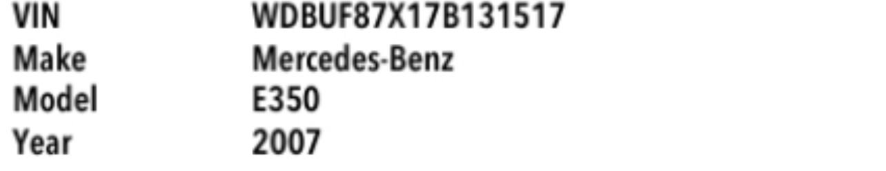

What's the vin? Sounds like a couple of those codes could be balance shaft related but it could also be bad sensors. Early 2007 models also had balance shaft problems. Misfires can be the plugs/coils but sometimes it's something else and can be hard to track down.

Vin
Thanks for the valuable input and quick response, I started it yesterday and it started fine and idled but I still have the oil leak.

Actually I have brand new sets of spark plugs and coil packs in it from just less than two weeks ago. All are MB approved, because one of the coils had gone bad I decided to replace the entire six along with brand new spark plugs. I haven’t gotten a chance to check the oil breather but I suspect it is the culprit to my oil leakage. The low voltage might had come from when I was cleaning inside the car I had left the doors open for long with the dome lights on. I’ll clean the throttle body along with map sensor. So nothing about the camshaft magnet and crankshaft adjuster defective? What will say are the symptoms of a defective knock sensor? I’ll really hate for that to be the issue. I recently had the intake manifold replaced by an indie mechanic.

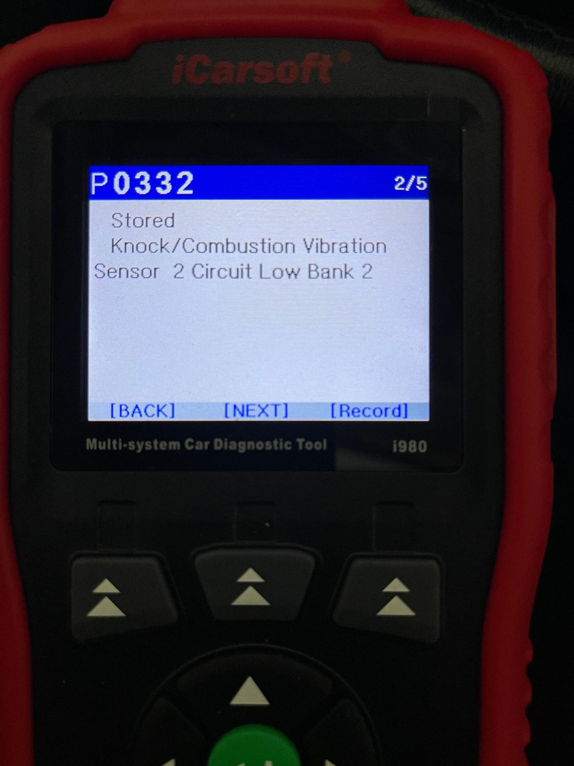

Have him double check his work. Maybe he didn't plug in those knock sensors. There's a lot of electrical connectors to disconnect and reconnect when replacing the intake manifold. Camshaft messages are historic so they could be old from the low battery or maybe they were accidently disconnected when the intake was replaced. You can clear them and see if it comes back. I don't worry too much about old codes. Says you still have current codes for the misfire, you sure you got the right plugs and that the ones you got had the right gap? Of course you could have a vacuum leak somewhere from taking everything apart which could be causing your misfire codes. The oil breather and separator is what cooks the intake, failure lets oil instead of fumes into the intake which gums up the flaps which means you have to replace the intake. Remember the oil separator is reverse threaded, turn it the other way to loosen it.
Thank you for the valuable input, the plugs said pre-capped when I purchased them and the guy that worked on the car said he’ll check I don’t know if he ever checked. I probably won’t get to the car until Friday but I’ll update you soon thanks again!

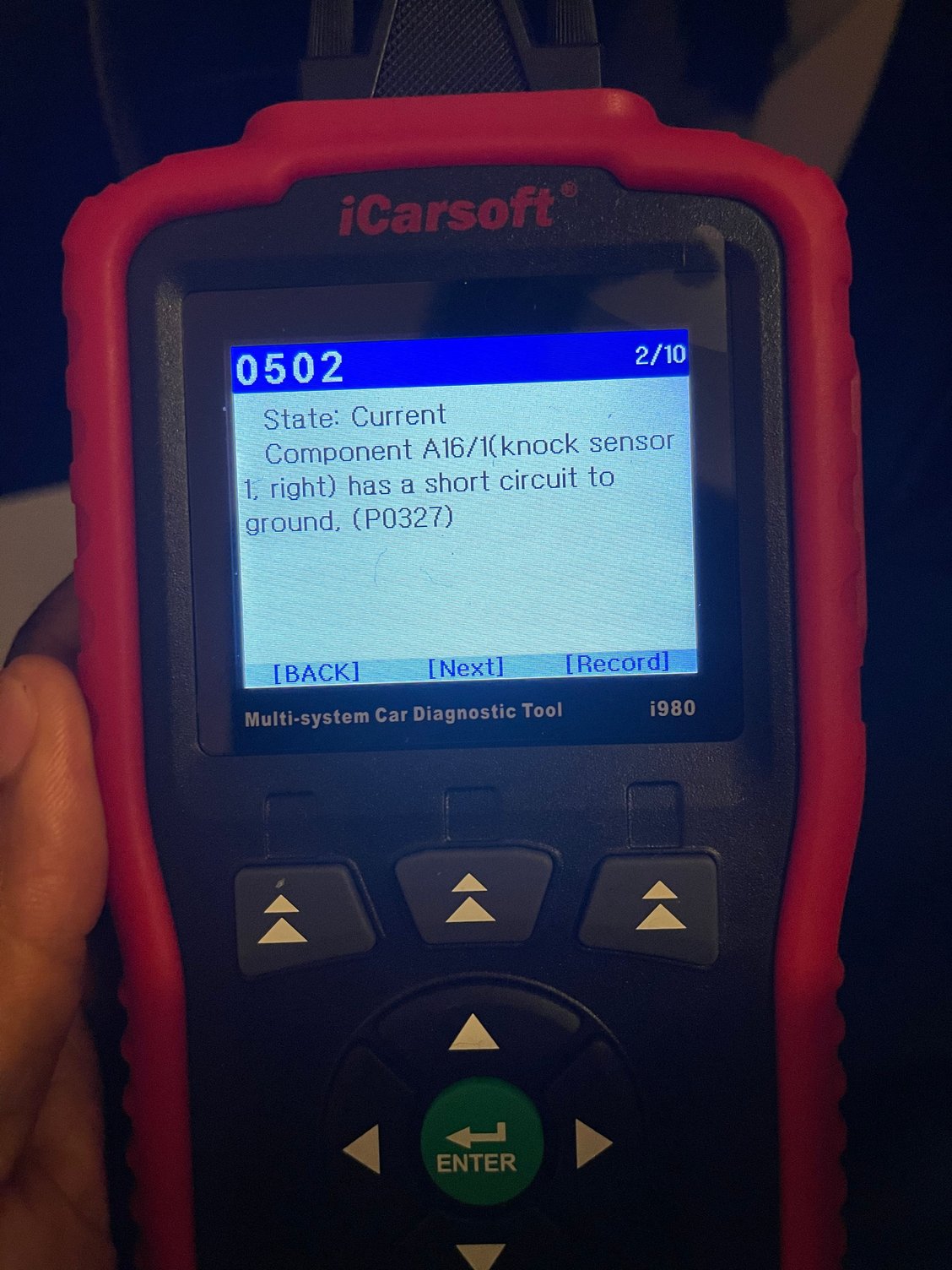

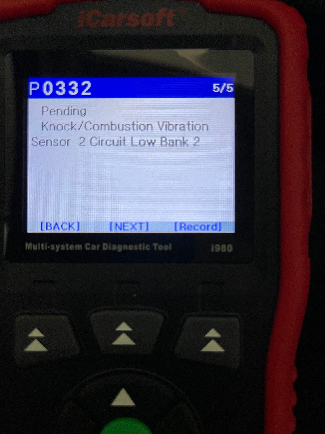

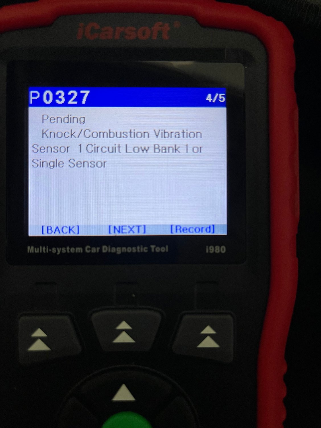

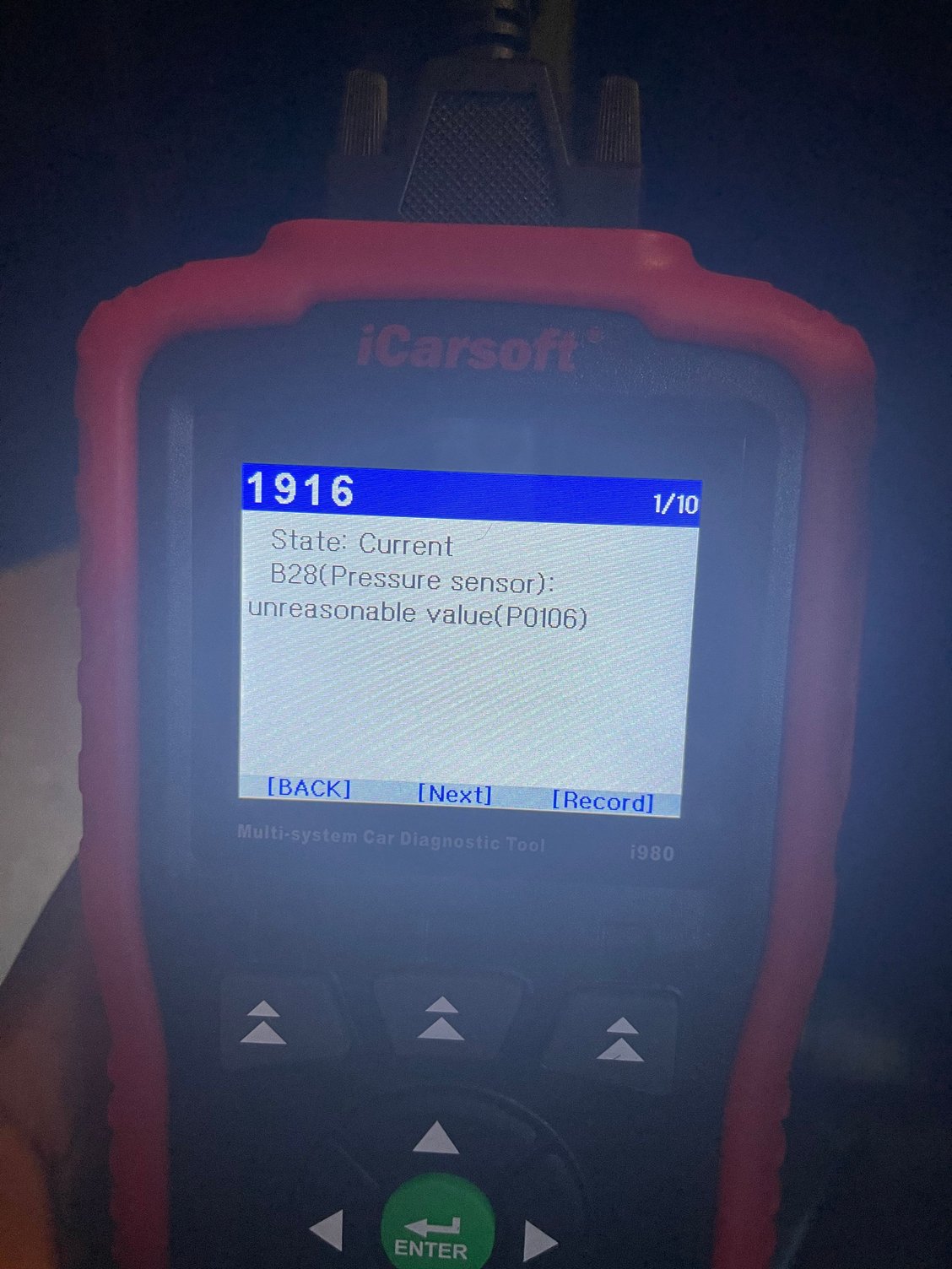

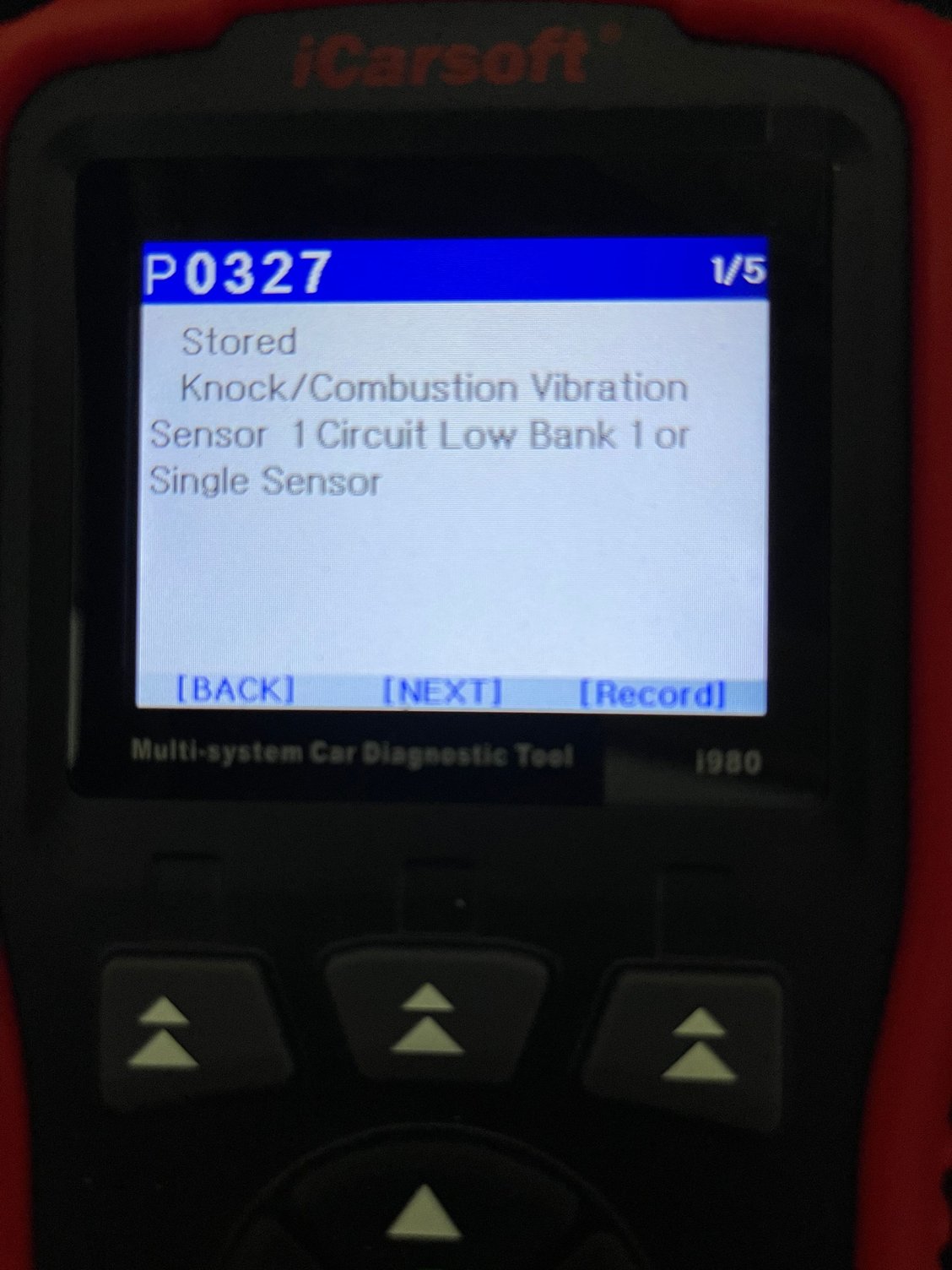

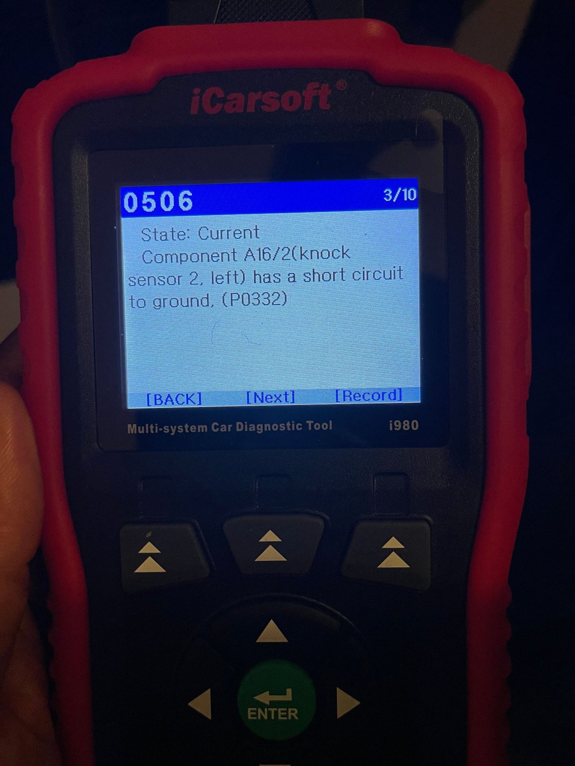

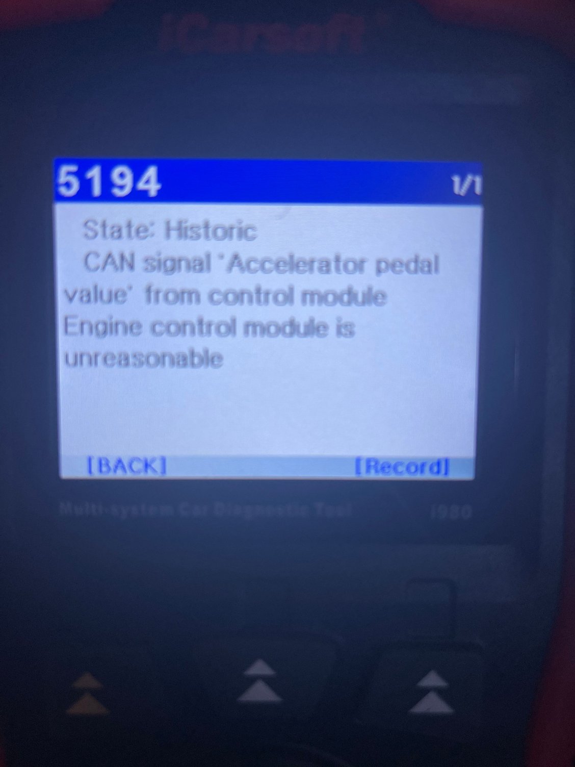

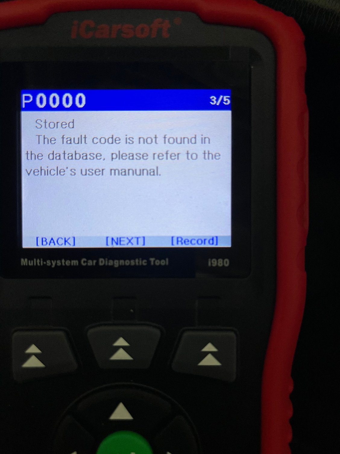

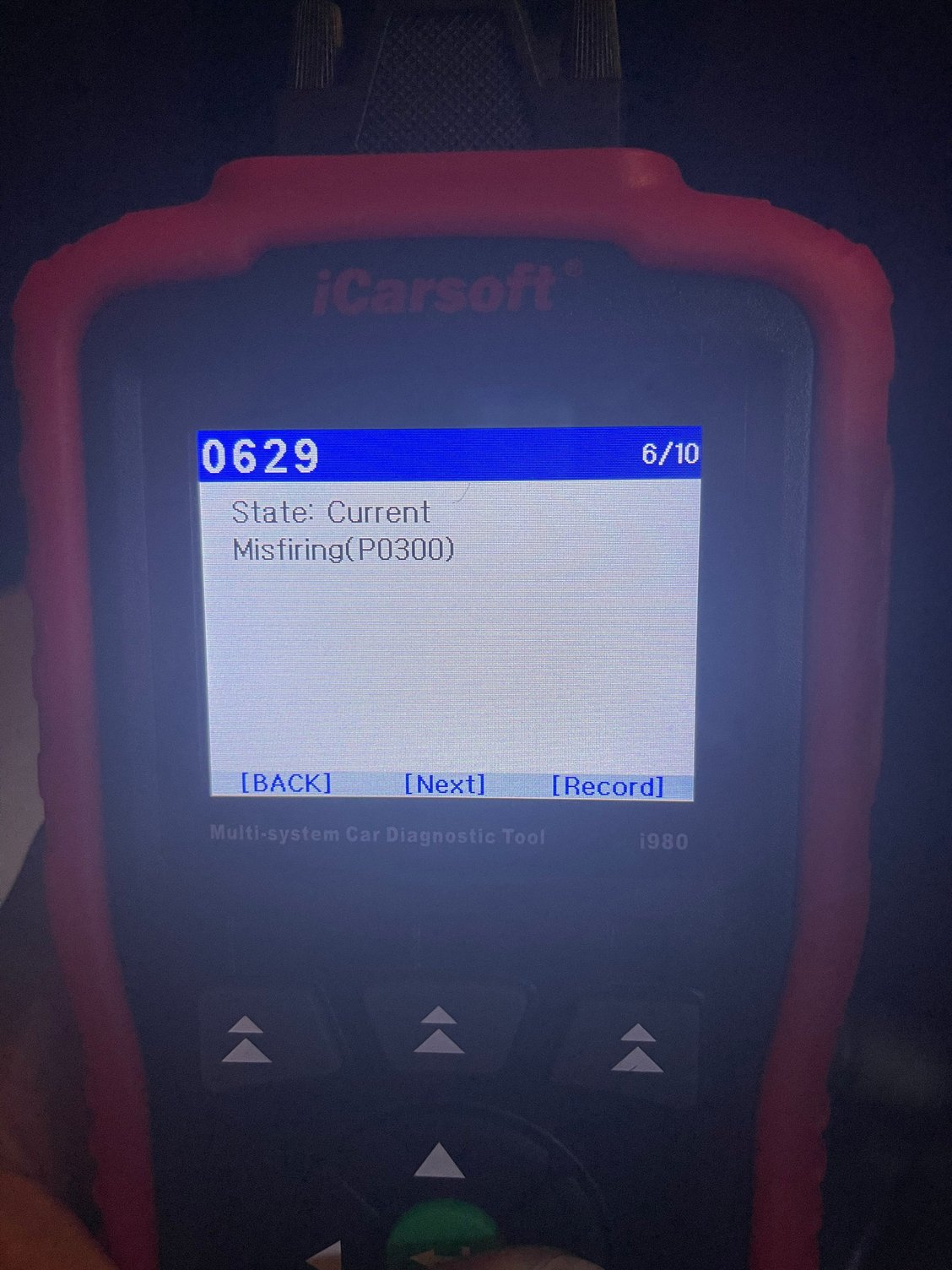

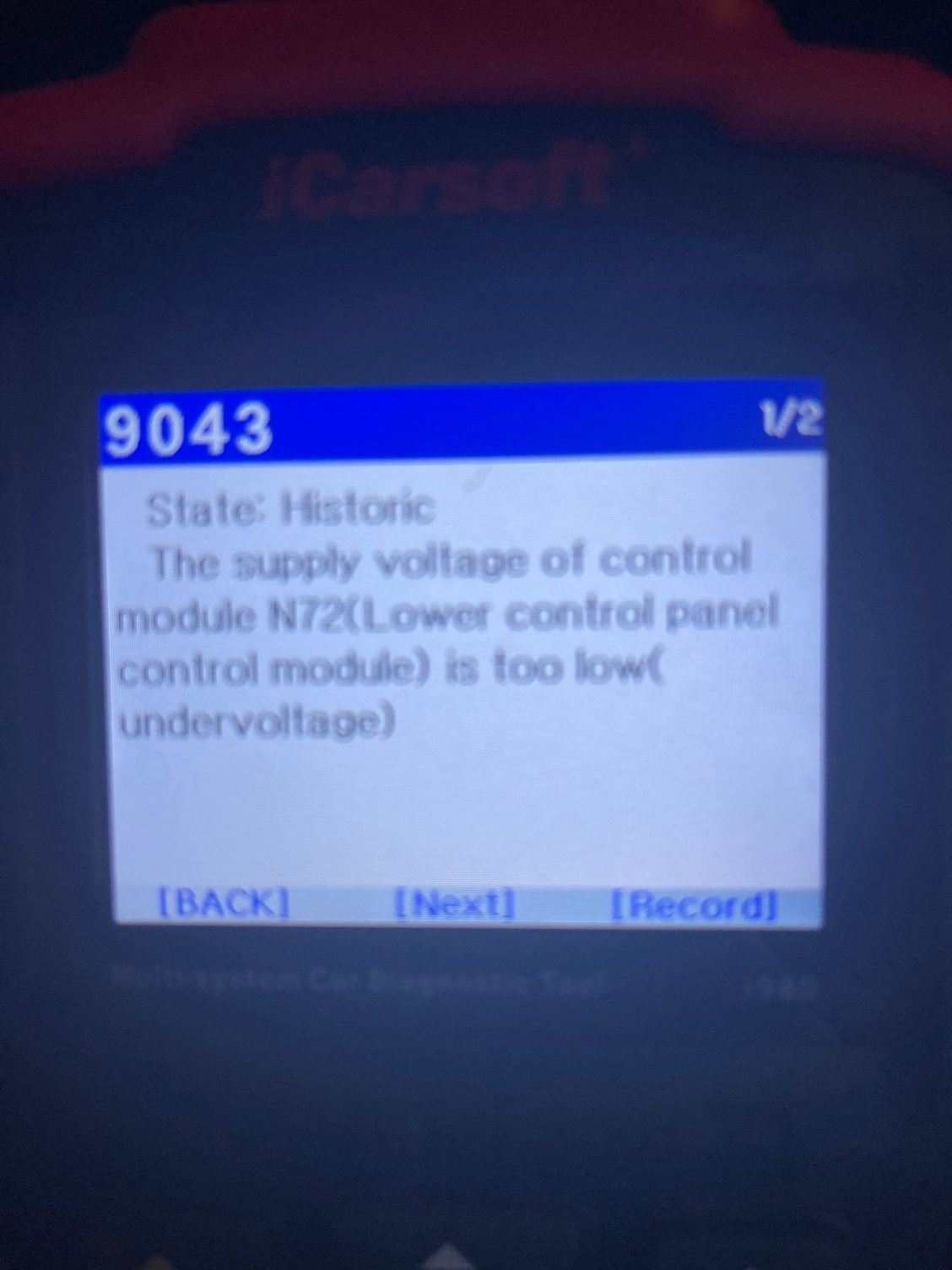

Hi Fam! Sorry for the late update, I just left the Mercedes for a while since something else seems to break as soon as I’m done replacing the other.
Changed the max air flow sensor and the car stabilized and ran good for a day without the CEL on. The next day while driving to work, inoperable message came back on, lost acceleration power. I purchased a brand new throttle pedal with sensor replaced it. Car ran great for 2 days then cel came back on. Now it is showing that it is the knock sensor and unable to pass emissions.
At this time I’m just tired of this car, thousands of dollars and hundreds of man hours later and I still don’t have a fully functional car; the cel is still on. The photos shows its latest soap opera.
I’ll really hate to take the intake manifold back out again as I just replaced it. Because that’s the way to get to the knock sensors.
