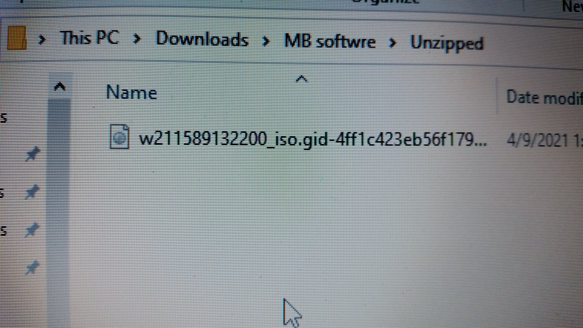

Here is what is in the car and the file I want to install. How do I tell if the car version is older?

The file you are trying to install is for firmware 30/06 which is definitely older than what you currently have. It seems like 30/06 was released only for the EU COMAND, which is different than the US one and firmware is not compatible. What you should be installing is 29/08 (though I think it shows as 28/08 when you do a version check on the COMAND after you perform the update). Here is the information on it: PDF The PDF contains information on how to perform the update. Here is the update itself that will need to be burned on a CD. ISO
