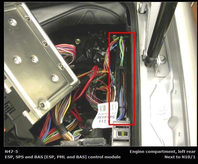

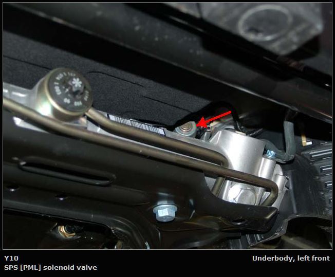

Solenoid valve (y10) is wired to ESP module, you may have a problem.

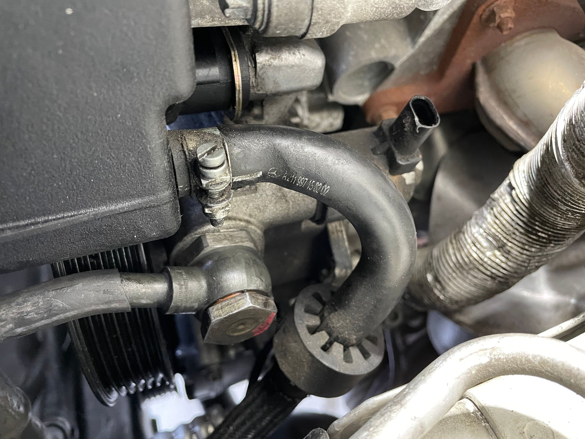

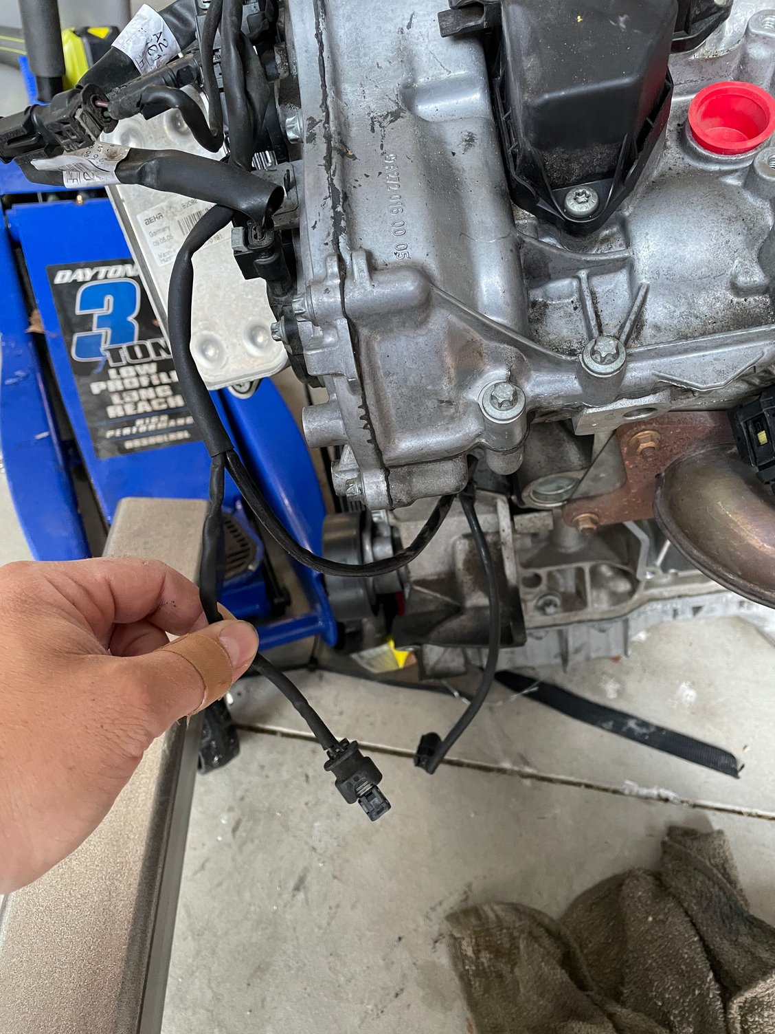

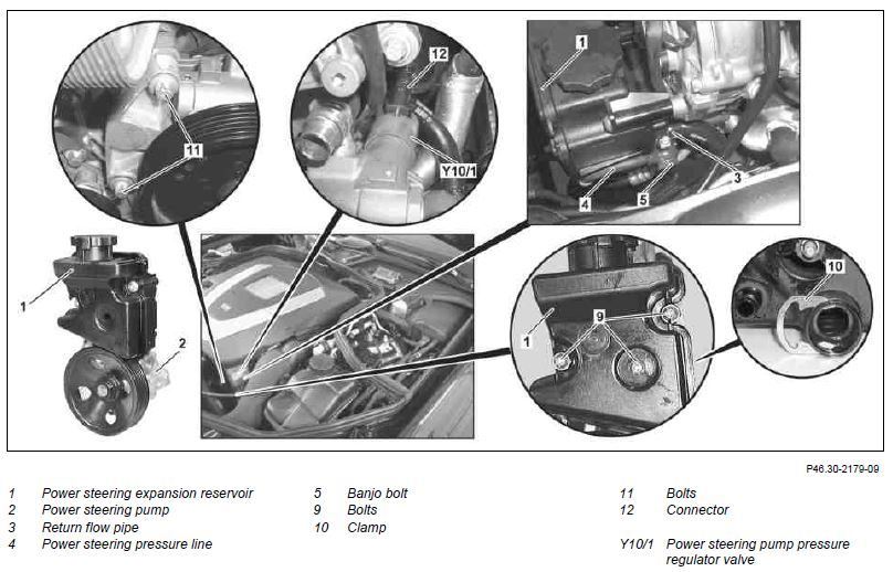

First photo is the wire going to the p/s pump. It branches off the wire going to the a/c on the 2006 harness. It’s black/pink and red/green.
the plug on the p/s pump sits behind where the high pressure banjo bolt goes in

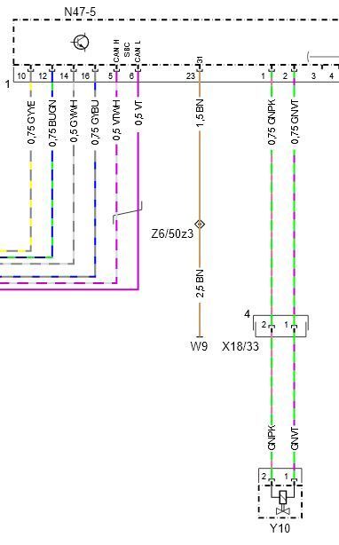

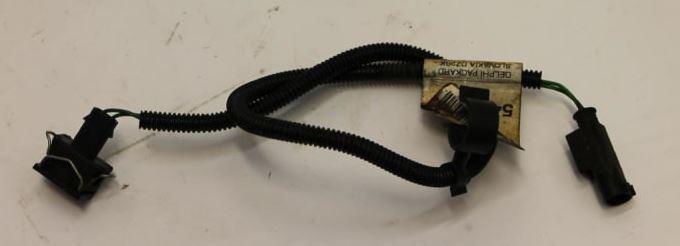

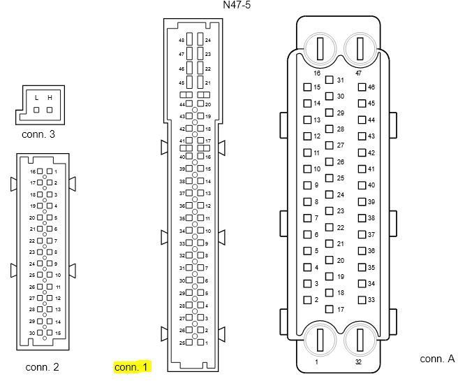

I was approaching from steering gear, misunderstanding you’re referring to 12. You can attempt to manipulate a retrofit (FYI solenoid valve wiring harness 18/33 wiring diagram above is part 2115400709), ultimately wired to n47-5. Not certain if MB diagnostics will eliminate coding for speed-sensitive steering since it is associated with ESP, etc.
