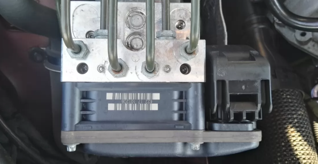

The pump you show is not sbc
The
The sbc pump has an accumulator.
the bleed procedure should be followed for any normal braking system. If you have run the master cylinder dry, you must bleed that, and same for the abs pump. Lots of info out there depending how dry the system was, but again, from the pics, no sbc. Tools can help in this instance, digital (star) as well as pressurized (brake bleeder)

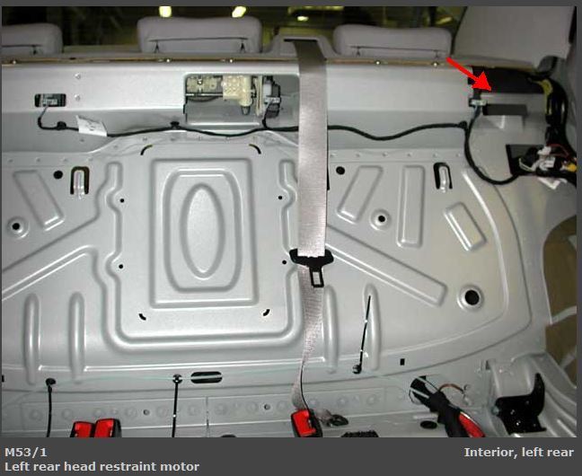

I have continuous currunt to rear left and middle headrest even switch is not depressed. Right rear is working fine. I have disconnected the cable (beside backrest) for the left and center headrest motors. Any suggestions or maybe i need wiring diagram?

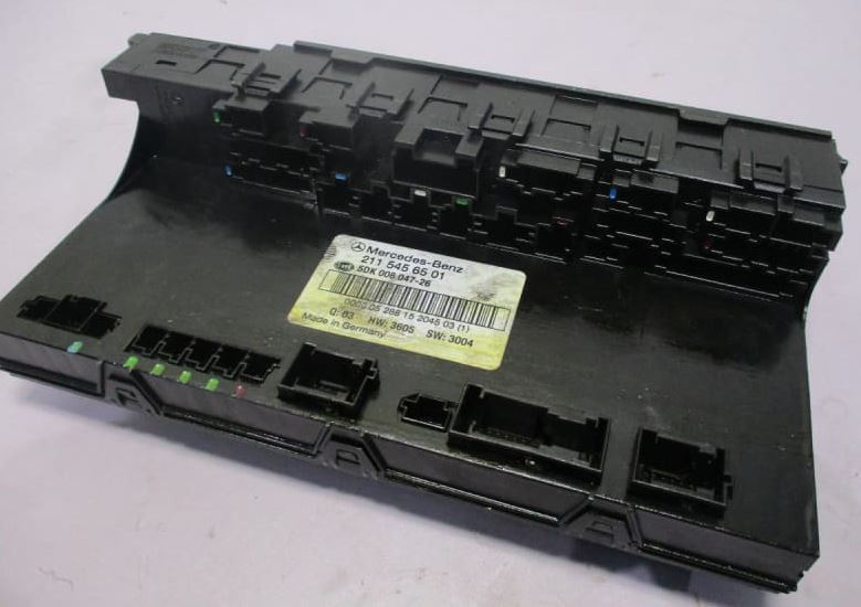

Pull f31 @ interior fuse panel (side dash) in an attempt to reset UCP (headrest switch). Problem remains, try disconnecting battery for about 30 minutes in a second attempt to reset. N/G, I believe harness (part # 2115405206) originates from rear SAM in trunk trace harness back and check connector.
