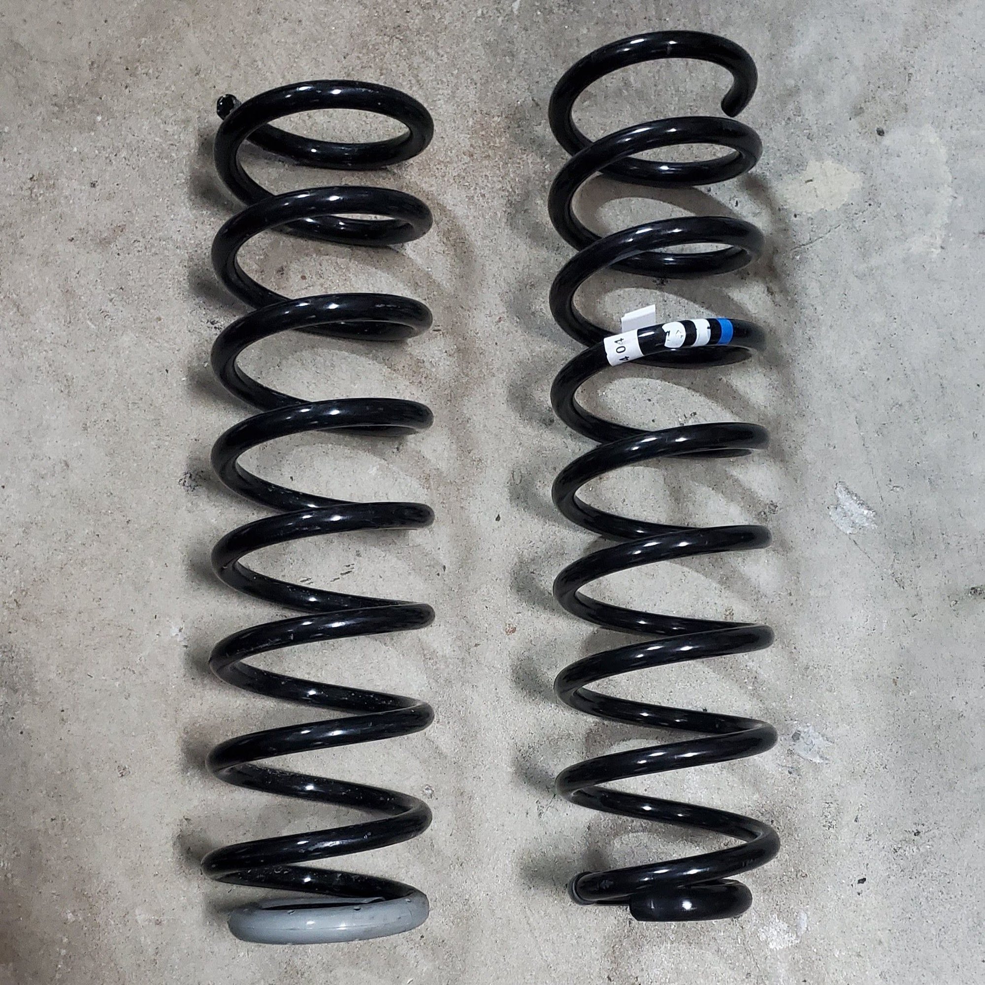

I ran into this when I replaced my springs a year ago. I mistakenly purchased the incorrect springs (slightly thicker and beefier). This resulted in a definite high front end. Initially I installed with the adjustable support spring at the same point on the shock as the old one so that in theory, the height would be the same. As you can see in the last two pictures, there is quite of adjustment from top to bottom based on where you put the spring. If you are 100% sure you have the right spring, you can lower the adjustment spring to lower the ride height. From my experience, it was trial and errror to get it right since is a pain since it requires a spring compressor. Good luck!
Correct spring is on the right.

Yep, it sounds like whoever did them didn't set the rings to the correct height. I got a set of Bilstein and by default, they were at the very top which would make them too high. One of the first things I did was set the rings to the lower ones. You have to match them up to the old springs to get the right height but now that they're gone, it's probably 2 or 3 rings from the bottom depending on the strut you have. I think my Bilstein had 10 rungs and in the pic above I see 11. You do have to take the spring off in order to move ring down to a lower rung. There were sport, luxury, 4matic, rwd, gas diesel, v6/v8 options, who knows what ride height went with each option.

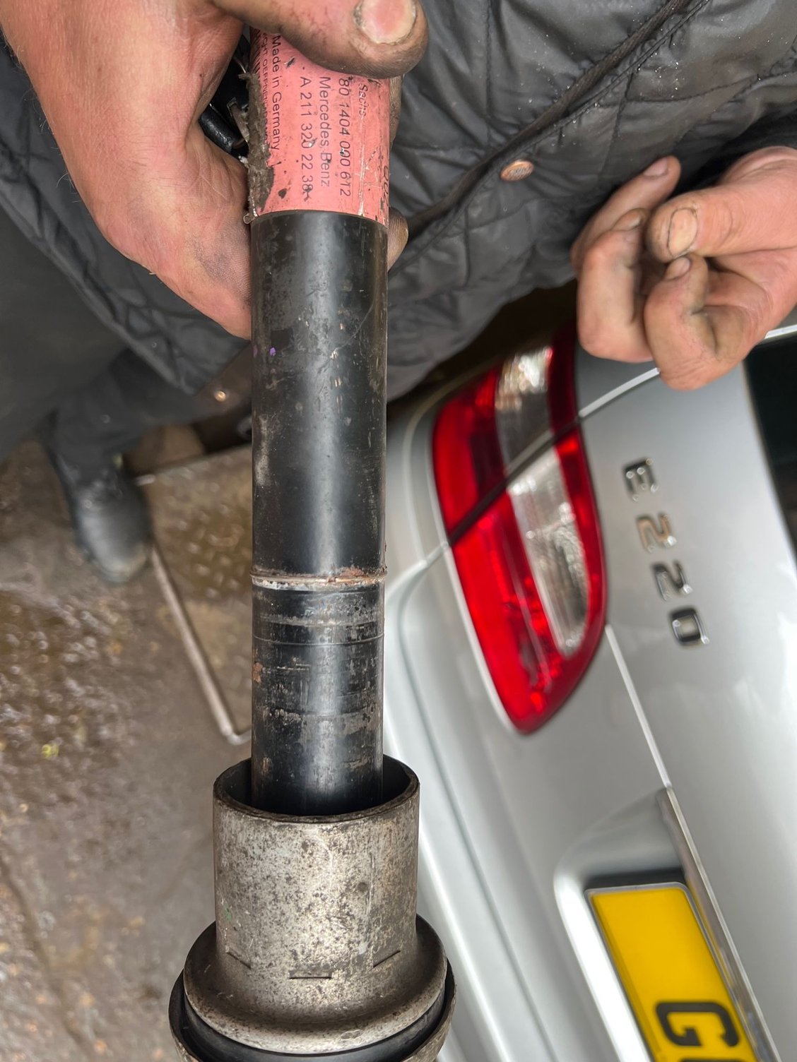

I went to collect the car today and it certainly drives better and sits lower on the front end. I guess there might be some minor spring settlement to come too. I did ask about the struts and was shown one off another W211 which also doesn't have the adjustment. I showed the garage the pictures from this post and they were adamant these struts have no adjustment. I take your point regarding replacing struts and I would have done had the garage advised me to do so. They did advise on the lower O/S/F ball joint, which they did whilst in with them.
The strut on my car seemingly has no adjustment; FYI the back of the car in the picture isn't mine but another E220.
I was advised on replacing the inner tie rods; they said not dangerous but something to plan for in future especially before having an alignment (for obvious reasons). I suspect if doing this it might make sense to do the outer ones too?
