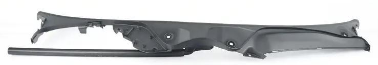

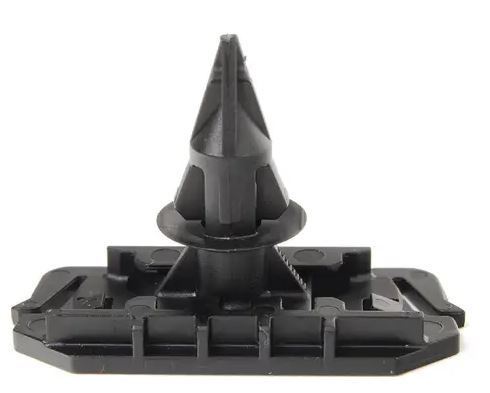

Some checks: all expansion rivets especially if reused (photo 1) common problem - part # 1239900592, mounting clips (second photo) allowing tight seal 2119880081, and last crimped hose if need be.

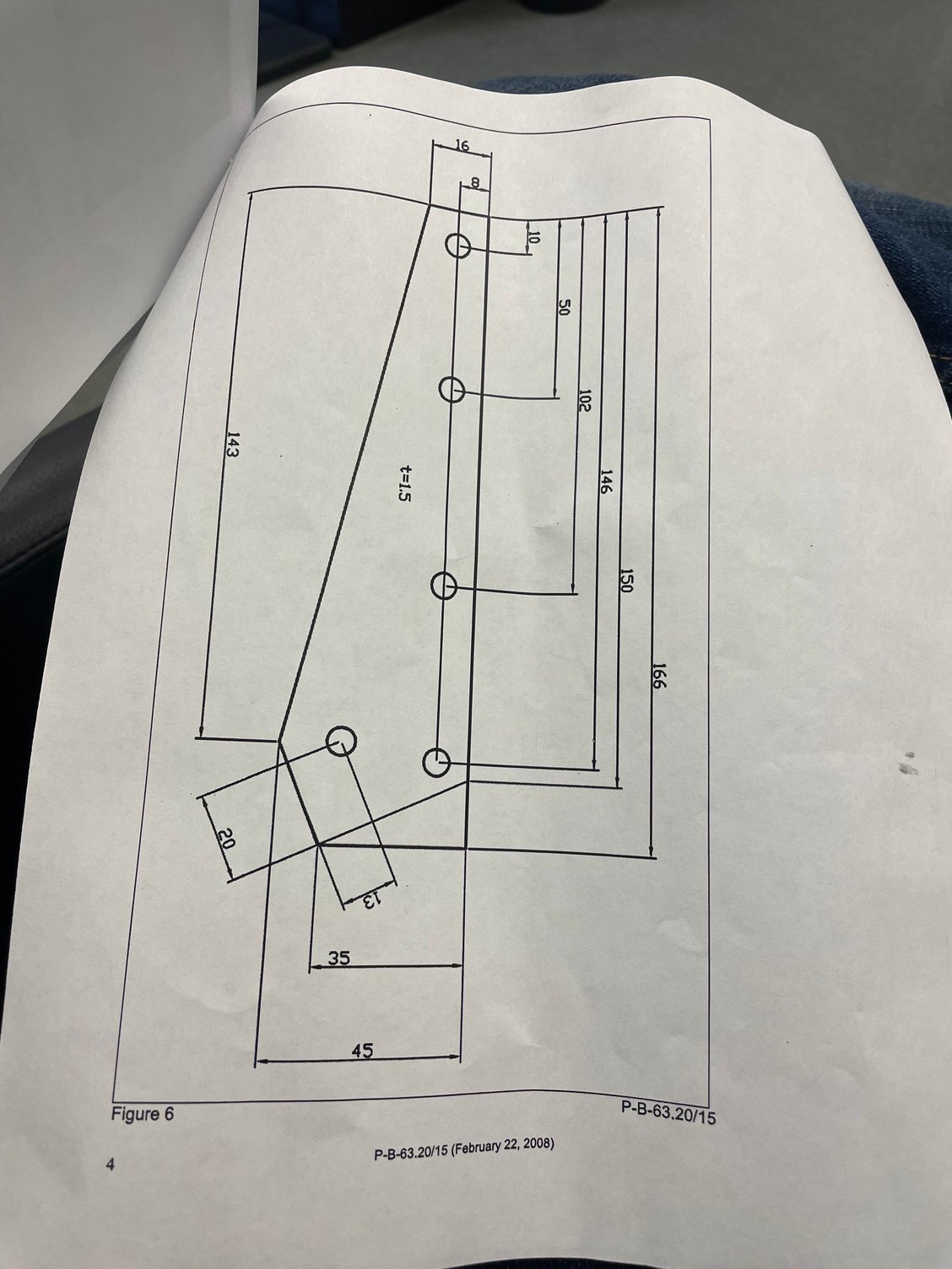

Update - took it to a Mercedes body shop. Apparently there is a DTB out for the glue at the seams of the sheet metal where the water drains.
Needless to say I am extremely surprised and concerned with this being an issue on a Mercedes. Is it typical for these costs to be of the owner? Or is this something that is covered by warranty?
see images attached.

Picked up the car today from the dealer. They applied the DTB and essentially explained that even though my specific W211 model doesn’t apply the DTB could very well be the solution to it.
Needless to say ey were right and this fixed the issue. I felt that if anyone else ends up in my shoes they can see the fix.

Attached actual bulletin.
