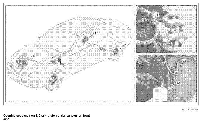

Attached is the procedure I found in WIS for my car. VIN WDBUF87X28B306312.Do I have SBC? It is 211087 2008 E350 4matic. Is the correct opening sequence rear right, rear left, front left, front right? Will need to pump brake pedal. Have pressure bleeder that can do 2 bars.

08 no SBC, sequence stated is correct.
