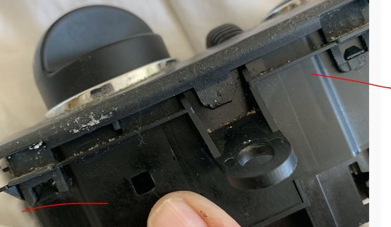

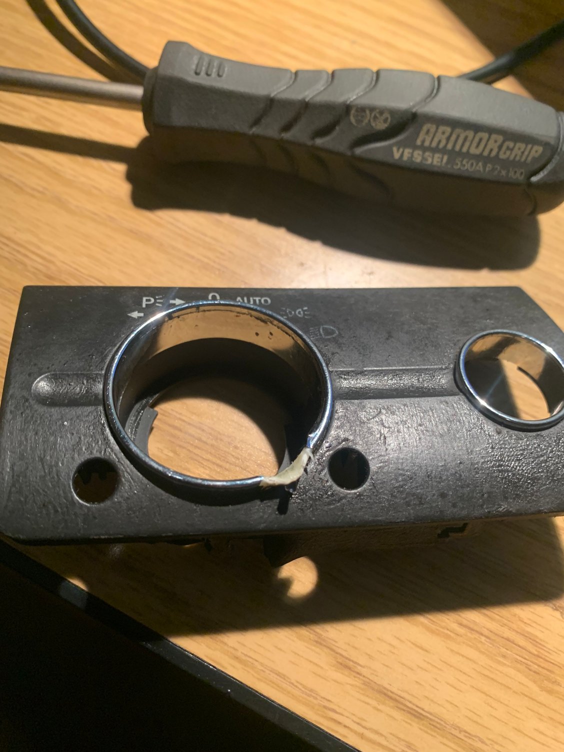

Old headlight facia panel. Worn and the plastic has perished. W211 E320 2004
Back of headlight switch unit. What's the trick in getting the facia and the box apart in order to replace the facia with a new one? E320 W211

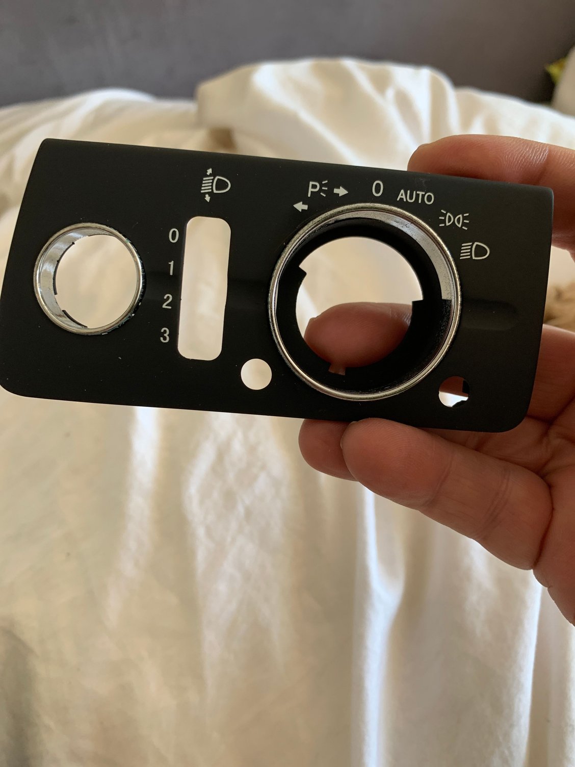

New facia panel I wish to install but I can't get the old plate of the headlight switch box. E320 W211 headlight facia
There's a decent video on YouTube where the guys sticks a tiny screwdriver into the hole where my finger is in the last image - but damned if I can get the 2 to seperate
what's the trick here?

Try releasing clips by carefully prying up, first may have been broken second normal.

Seperating headlight switch facia and box.
where the guys sticks a tiny screwdriver into the hole where my finger is in the last image - but damned if I can get the 2 to ACTUALLY seperate

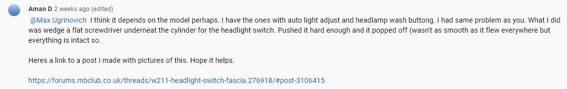

Associated video comment:

Success but not the way I presumed
In answer to everyone, I finally managed to pry the unit open but in doing so I had to literally cut away the plastic with a hack saw and tin cutters. The unit was impossible to open the way it shows in the video so I used the old "percussive maintenance" technique of just completely splitting open the box so I could change the fascia. **** of a job but ended up perfect.

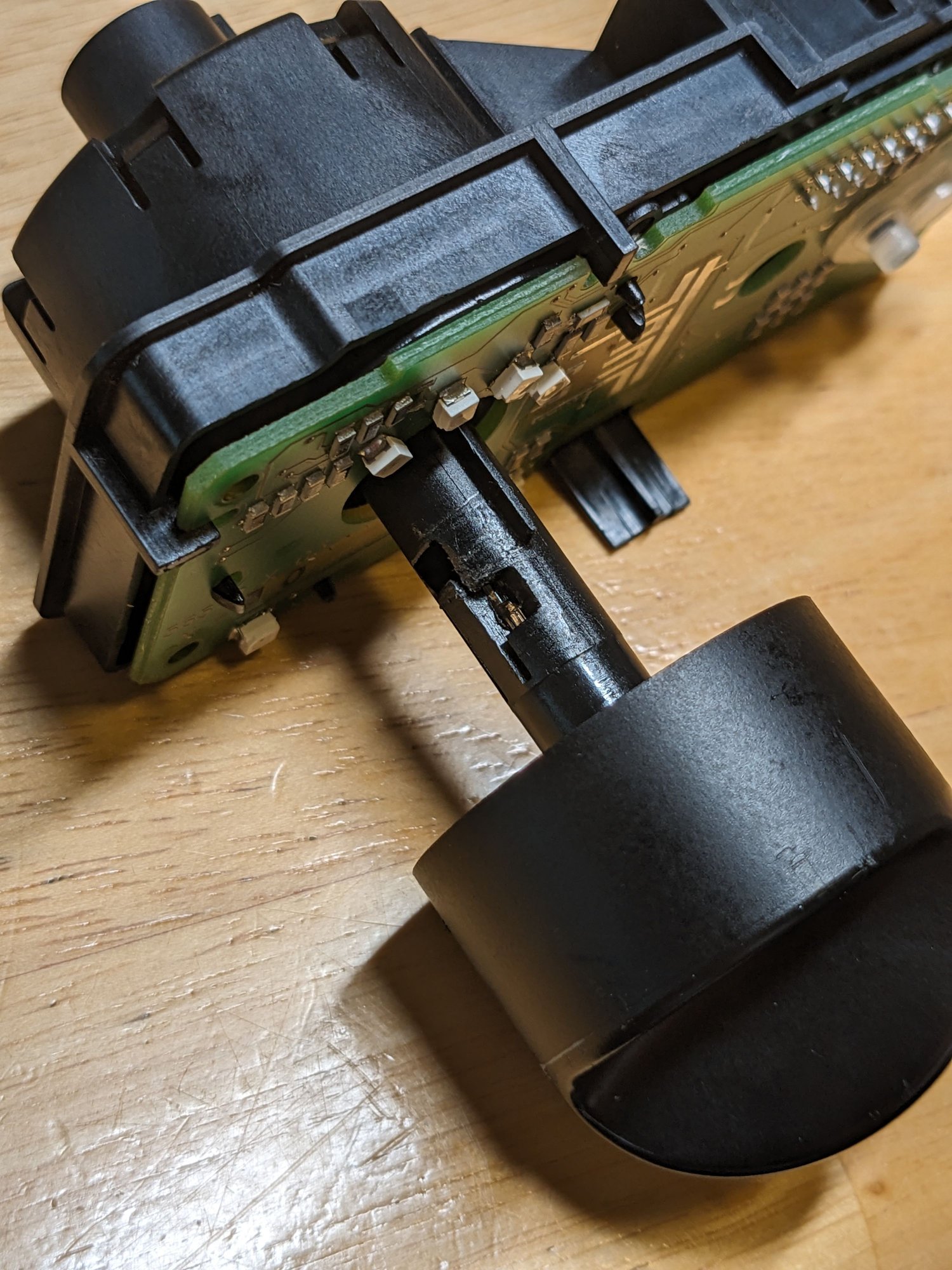

I was really struggling with this today so once I figured it out I made another video to show how to get the knob disconnected.
The knob is barbed, and there are two clips attached to the switch itself that both need to be pushed out simultaneously. There are two holes in the top and bottom of the switch that allow you to insert a small screwdriver (the part I bought came with two). Put the screwdriver in straight down and when the screwdriver is touching the shaft of the switch, move the bottom of the screwdriver to the left until it sinks into that groove. Then you should be able to pry the clips open with the screwdriver and pull on the knob to remove it. I don't know how anyone could do this without a third hand to help.

Thanks for posting these details. I had a heck of a time replacing my switch cover. I eventually got so frustrated I just pulled until it popped off. Thankfully nothing broke, but this would have been great to know at the time!

I also had a sticky fascia and bought a hard plastic one from Aliexpress. Fitment was so-so, so I decided to see if I could clean the original fascia. I was able to remove the rubbery goodness and it looks good again with perfect fitment.
