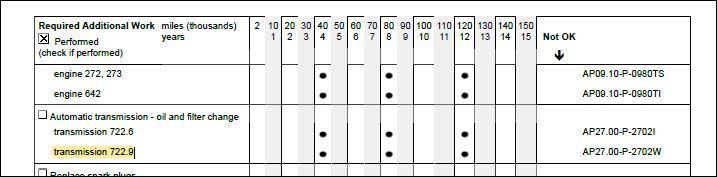

You have 722.999 transmission in 2009 'MBUSA' revised ATF/filter change to every 40,000 miles/4 years whichever comes first I suggest you follow this schedule.

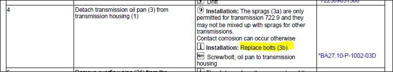

Hey with regards to the transmission pan bolts, my local auto trans mechanic states that the bolts need to be replaced every time the pan is removed and fitted back again.
Is this true? I've taken a quick look at all the PDFs that @konigstiger supplied above and can't see anything about new bolts???
Old Mar 1, 2022 | 09:52 AM
konigstiger's Avatar
Posts: 15,901
Likes: 4,630
From: North Scottsdale, AZ
'71 Pinto
Revisit AR27.10-P-7030W

Yes, you can clean them and add LockTite, and probably reuse them. They are M6x40 screws, and torqued in two stages, first to a 4 Nm and second stage to 180 degrees. I doupt they would stretch beyond reuse. But then again, there are only six of them, so they are not too expensive to buy.

I took my transmission valvebody out today, and wondered why those screws need replacing, as they are not in huge strain or anything. But I was just looking for filter and gasket, and noticed that spare parts listing says that those screws are made out of aluminium, so yes, they need to be replaced.

Not worth saving a bit, and risk breaking the bolt when reused. The time to extract the bolt out, plus the pain , is not worth it.
