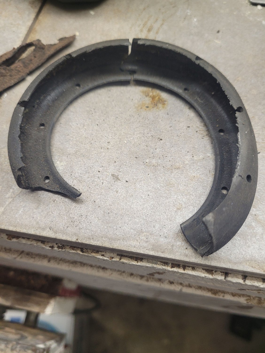

What is this?
I was checking bushings and found this hanging around the bottom of the spring coil and perch of the strut. It is very light weight maybe more foam than rubber.
I've been trying to diagnose suspension noise, not finding anything obvious except this. Would whatever this is deteriorating be my issue? I can't find any part number for this.

suspension are the sturdiest parts of the car. Light foam is not rated for strength. That piece looks like a cushion for the spring coil bottom.
Searching for noise, have you checked these:
#1 ball joints
#2 sway bar bushings
#3 stab. links
#4 control arms
Perhaps this part
https://www.fcpeuro.com/products/mer...4aAqx1EALw_wcB
Notice the part fits the next generation W212, not listed for the W211

When you purchase a new coil spring, that isolator is glued onto the bottom of the spring, during the process of installing new springs recently, that part fell off. I already had Bilstein B6 series, replacement shocks and purchased a separate isolator, Which doesn’t fit that great but works, so I didn’t need that part you show.
I wish I could find a properly fitting bottom isolator for use with the Bilstein B6.
