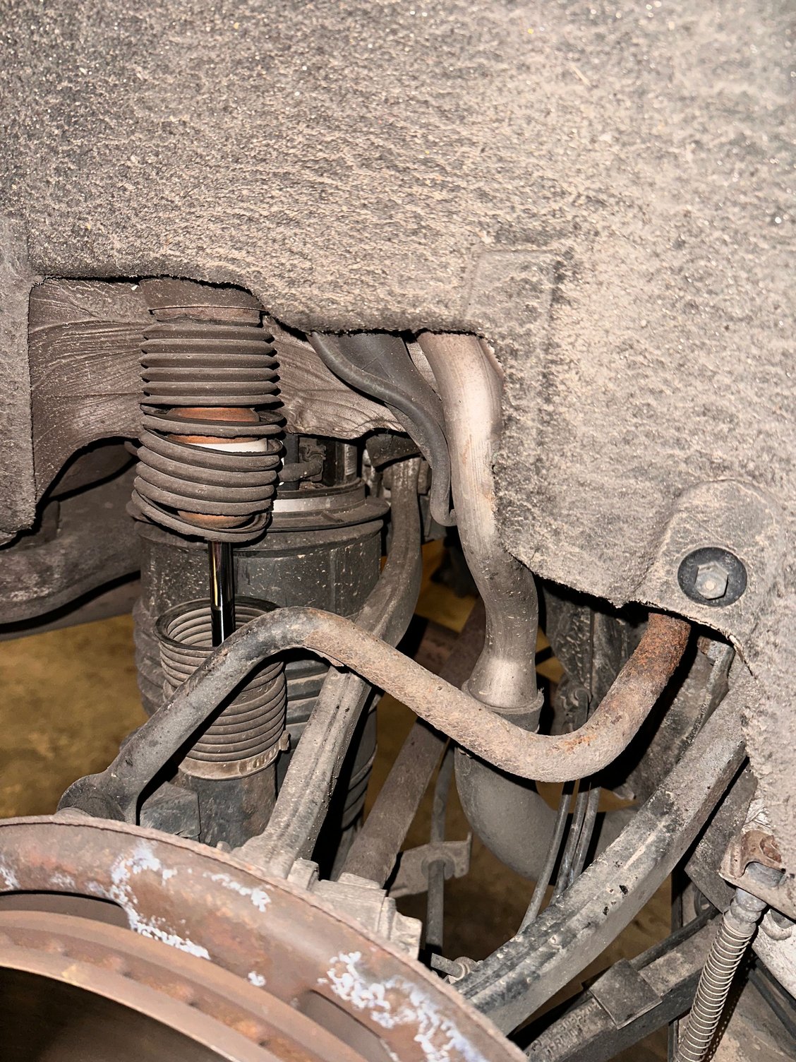

Hello,
I just bought a 2006 E500 4matic wagon, all 4 corners were replaced with Arnott, I noticed regular shock absorbers in the rear next to air springs. The bellow on one side is torn which makes me think they didn’t replace the shock absorbers when the changed the air springs.
Where do you buy those conventional shock absorbers? I looked on Rockauto, but can’t tell what I need, a lot of parts fir RWD and they might be different.
thank you

The air struts were replaced, but nothing else, planning on replacing the rest of suspension.

When they changed the air springs on this car Arnott was used, both rear and front.
The shock absorber with torn bellow is a regular one, no wiring.

if there is no wiring then you can use any rear shock for a W211 without airmatic, regardless of RWD or 4matic. you can narrow your search by putting non-sport package. sport package shocks are slightly shorter in length.
OEM: https://www.fcpeuro.com/products/mer...chs-2113264300
they also carry bilstein: https://www.fcpeuro.com/products/mer...50-e500-553380
