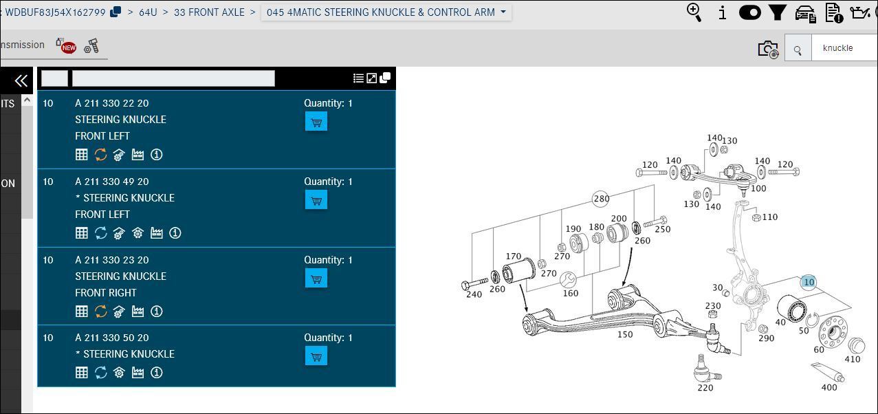

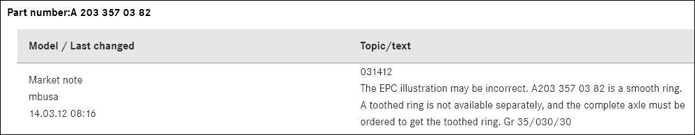

Correct part #s original 2113300001, replaced by 2113301101, replaced by current 2113301701 (no longer available new); recommend replacing pulse ring at same time part # 2033570382.

Howdy Konigstiger-
Very many thanks for the info! Looks like my question(s) have been answered. It's pretty much as I suspected-- that the axles have been changed through the production run of the W211.. and that the "new" version(s) are backwards compatible to the steering knuckle/wheel bearing on my W211 MY..
One last thing-- I'm going to assume that there is no change to the bearing / steering knuckle accepting the new axle shaft.
As per MB's recommendations- I'll install a new impulse ring on each shaft.
Once again many thanks for your help.

Enter VIN & part #s here: https://www.mercedespartscenter.com/ all fit.
