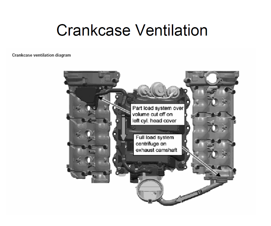

Quote:
No. That is a separate part. The attached picture (taken From M272 instruction document posted by @konigstiger ), you can see the two entry points for oil into the intake.Originally Posted by imchaiwala
Is the oil separator/breather part of the Pierburg manifold? Thanks again
Here are the parts: oil separator-related parts and the intake. As @cetialpha5 mentioned, the breather/centrifuge is the commonly known failure point.
https://www.fcpeuro.com/products/mer...es-2720100631k
https://www.fcpeuro.com/products/mer...tor-2720160134
https://www.fcpeuro.com/products/mer...ierburg-516475
