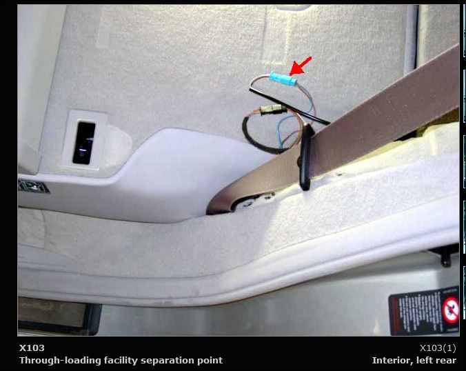

See attachments.

konigstiger.... Thank you for picture and pdf files.
I have disconnected plug from seperation point, because headrest motor have continuous 12v power.
Still i cant understand how to check why its always powered. Are headrest connected to a module?

Check corresponding rear SAM connectors/pins per wiring diagram could be internal SAM malfunction.
