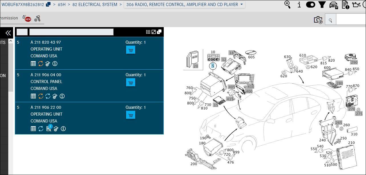

Need to have someone check for fault codes using Xentry (MB diagnostics) head unit may need replacement. Provide VIN I’ll pull compatible part #s to shop in the event unit is confirmed bad or you want to circumvent definitive diagnose and replace.

Thanks for the reply. I would definitely be interested in the part #s in case it comes to that. VIN is WDBUF87X98B262812. I do have an OBD reader and it shows no error codes.

Shop the following part #s used.
