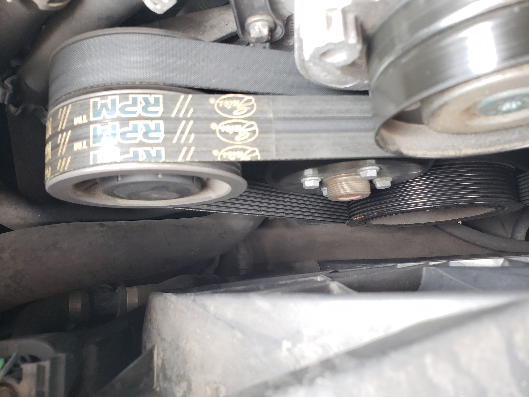

Aug 8, 2023 | 07:42 PM
Perhaps getting good lighting and taking a few pictures of the front of the engine, and close up of the front of the harmonic balancer (crankshaft pulley). With current cameras, zooming may show any cracks in the rubber.

Aug 10, 2023 | 10:10 AM
Quote: Perhaps getting good lighting and taking a few pictures of the front of the engine, and close up of the front of the harmonic balancer (crankshaft pulley). With current cameras, zooming may show any cracks in the rubber.
I'll take some pictures today.

Aug 17, 2023 | 07:19 PM
Sorry for the delay. Took some pictures to see if there is any oil. Couldn't find any that I could see. Camera had a hard time focusing. As of late, have not had any noice.

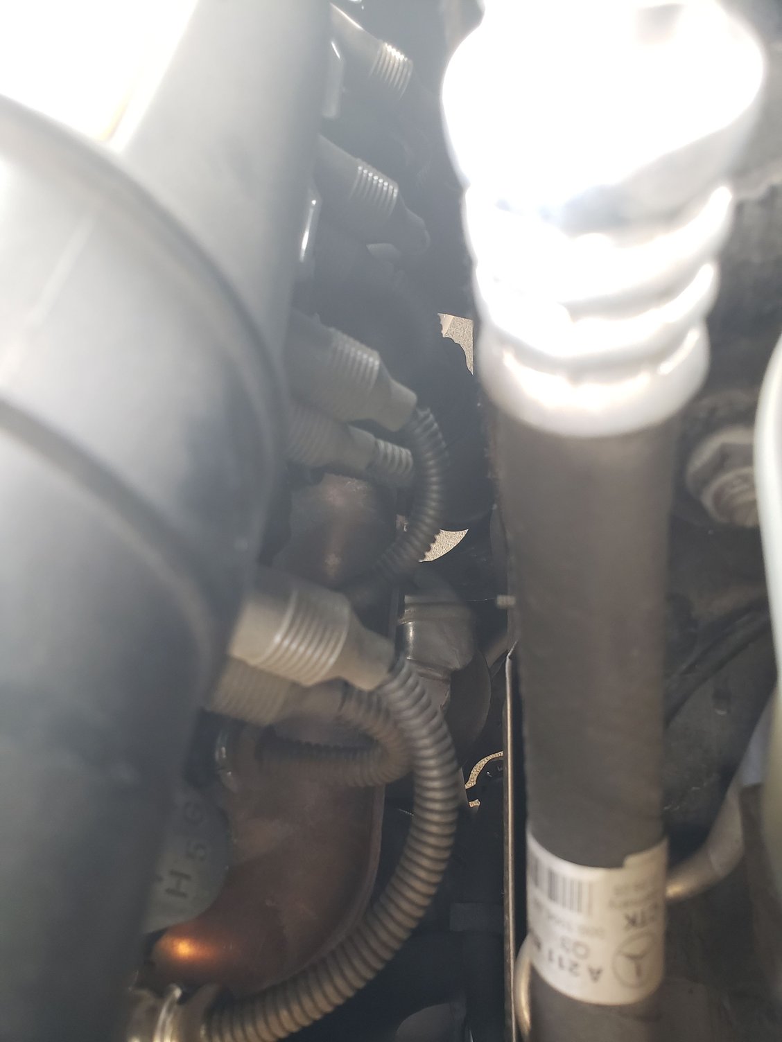

Update: 2 weeks without any noices. Today temperature outside was 105°f, plus whatever heat from the engine bay added to it. Actually had a chance to get a short video of the problem with help from my mom. Although she got spooked by the smoke.
By the looks of it, mp4 video format is not supported. So I've attached a couple of screenshots.
First picture has arrows pointing to the area where the smoke/mist comes from. I say mist because when it happens, it is almost like a shot of NOS. Which leads me to believe that whatever is the cause it is under pressure.
In the picture above you can see steam/smoke coming from under the coolant reservoir area (top left corner of the picture).
Hoping this might give someone an idea of what might be the cause of this.

Aug 21, 2023 | 06:07 PM
Unfortunately, never seen the layout around the E55, but on the E350 I have moved the coolant reservoir on the side, and look at the wire connections under it. On the W212, and W166 there are a few connections on that side of the car. For W212 and W166 there is definitely a ground post, and I would not be surprised some minor coolant is leaking a tiny bit and wetting some connection.

Aug 21, 2023 | 11:13 PM
The hose connector usually crumbles with age , and starts dripping under pressure.
Fingers crossed is that simple, though if crumbling likely new reservoir and new hose.
