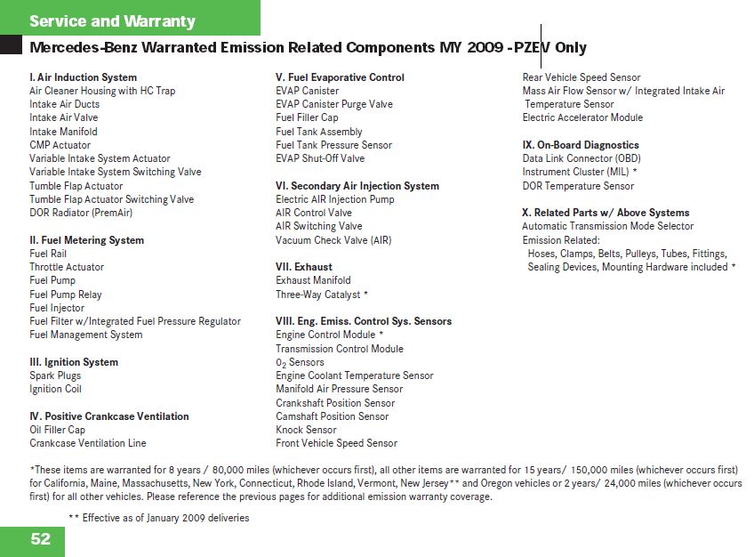

"California edition" and "replace whole fuel tank" lead me to believe this is a PZEV vehicle if so, you are entitled to no cost repair under emission warranty see attachment. Check your PM.
Attached Thumbnails 09 E350 california edition fuel pump problems!!-capture.jpg

Only problem with the warranty is that i bought this car off a dealers crashed sight like copart, (not sure if it was exactly copart) but so since the car was totaled before, they voided the factory warranty or any warranty at all that this car had! i WISH i coulda done it thru this warranty!!! but I'm not lucky enough for things like that lol so due to the fact that i have no warranty on this car i can't get it thru that, i PMed you back as well...i have a high end body shop in the philadelphia and so when i bought this car back in 2010 i ONLY bought it to use as a shop car to get here an there back an fourth werever if someone needs to go somewhere, so this is why I bought a crashed one and fixed it myself, (first off because i only spent $5,500 TOTAL, brought from the auction and fixed including parts and labor which i obviously did myself and this again was back in '10 and it only had like 500 miles on it so it was a good deal, and so I'm using it as a shop car for ANYONE that needs to go ANYWHERE kind of thing) thats why i dont want to spend $2,200 for a new tank because this is kind of a community car for anyone that need to use it!

THE CARS WARRANTY IS INFACT VOIDED DUE TO IT BEING TOTALED IN ITS LIFE SO WARRANTY ANY KIND OF WARRANTY IS OUT OF THE QUESTION GUYS...BUT THANKS FOR THAT....ANY OTHER IDEAS????

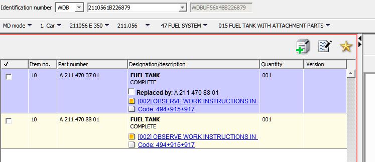

Here's datacard & part #s. Shop 2114703701 used, 2114708801 new/used.
File Type: pdf
Ya, Thanks for showing me that, i already know the exact part number that i would need for the exact part i would need, i have an estimating software as well thats linked to dealerships and aftermarket parts as well, and heres the exact part i need but look at that price over $900, and yes i get a pretty good discount, but instead of spending hundreds i want to spend double digit numbers not triple digit numbers all over a fuel pump problem!

BTW those aren't the right part numbers for my Mercedes, my system gives me a different part number, idk if it supersedes or the numbers you had are old but i tried putting in your part numbers you gave me in my system against my vin number and they dont match my vehicle :/
2114702402 is not PZEV see codes under description in MB EPC VIN specific attachment above, not that it matters anymore given "your" situation.
494 = USA
915 = larger capacity
917 = PZEV
