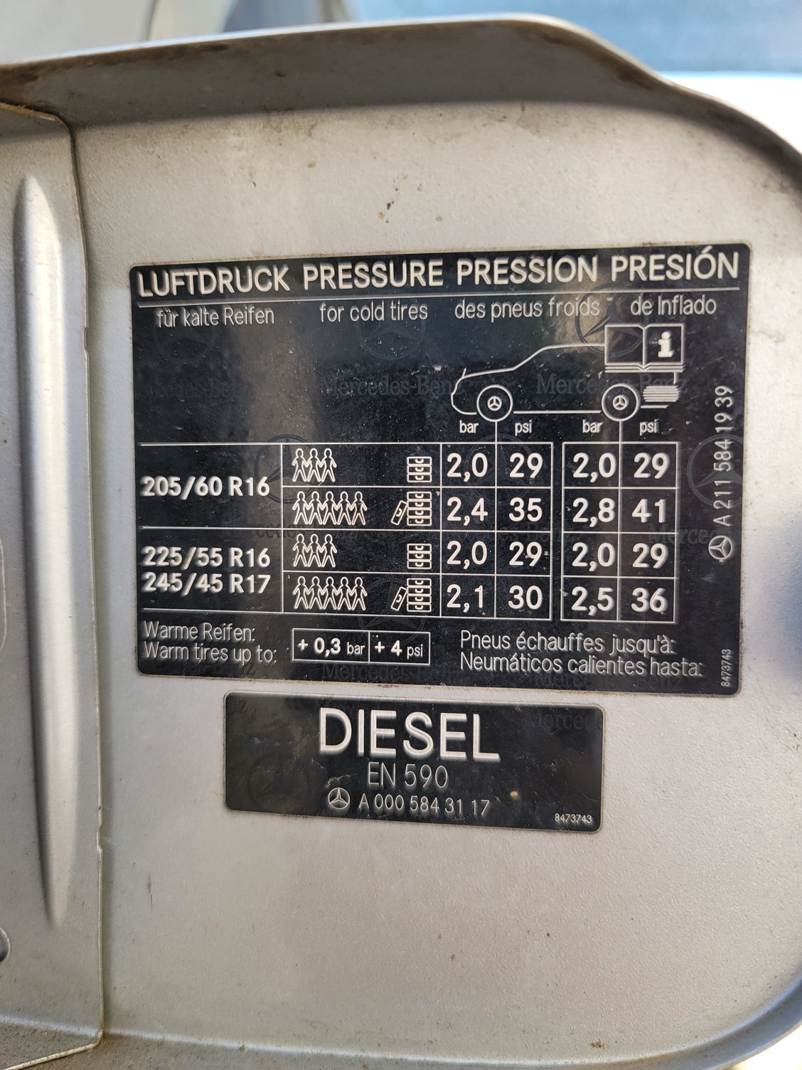

Don't be stuck on the wheel size alone. It's the combination of the wheel and tyre that make the difference, or doesn't.
Google tyre size calculator, and compare your current size to the ones on the sticker. What number is important on how your car works, is the circumference, which converts to revs per mile, and your 245/40R18 checks out just fine. It's basically same as the stock sizes. So no, doesn't have any affect on transmisson, nor cruise control.
But if they are cracked, an alignement doesn't fix them, you'll need new tires.
And as you have same size on all four corners, you can rotate them for even wear, no issues there.
Only drawback I see is that short sidewall will give you a harsher ride, especially if you compare it to the 205/60R16.

Well to be honest, there is a truth to what you are saying. Also there is a reason in the fuel cap there is a note to the type of tyre you should use. A bigger rim can be good for a bigger engine due to its power. For a 220 cdi engine for sure it would be an overkill. But I do also think that maybe due to this car being a classic model maybe the front suspension and arms are not aligned for a 18" wheel.

As per review to the situation, after doing some digging on the owners manual of the car, the maximum allowed (except the weight of the rim) is 245/45 R17 tyre-rim size...which it translates in accordance to the 18" wheel diameter to actually the same size with 17" (except less sidewall). Attached as you can see, is the calculated size for each of the rims.
So on a technical standpoint, except the harsh ride/less fuel economy, the specs are about the furthest tyre size/model you can get (so you can't use 245/45 r18 tyre...I think it wont fit...).
