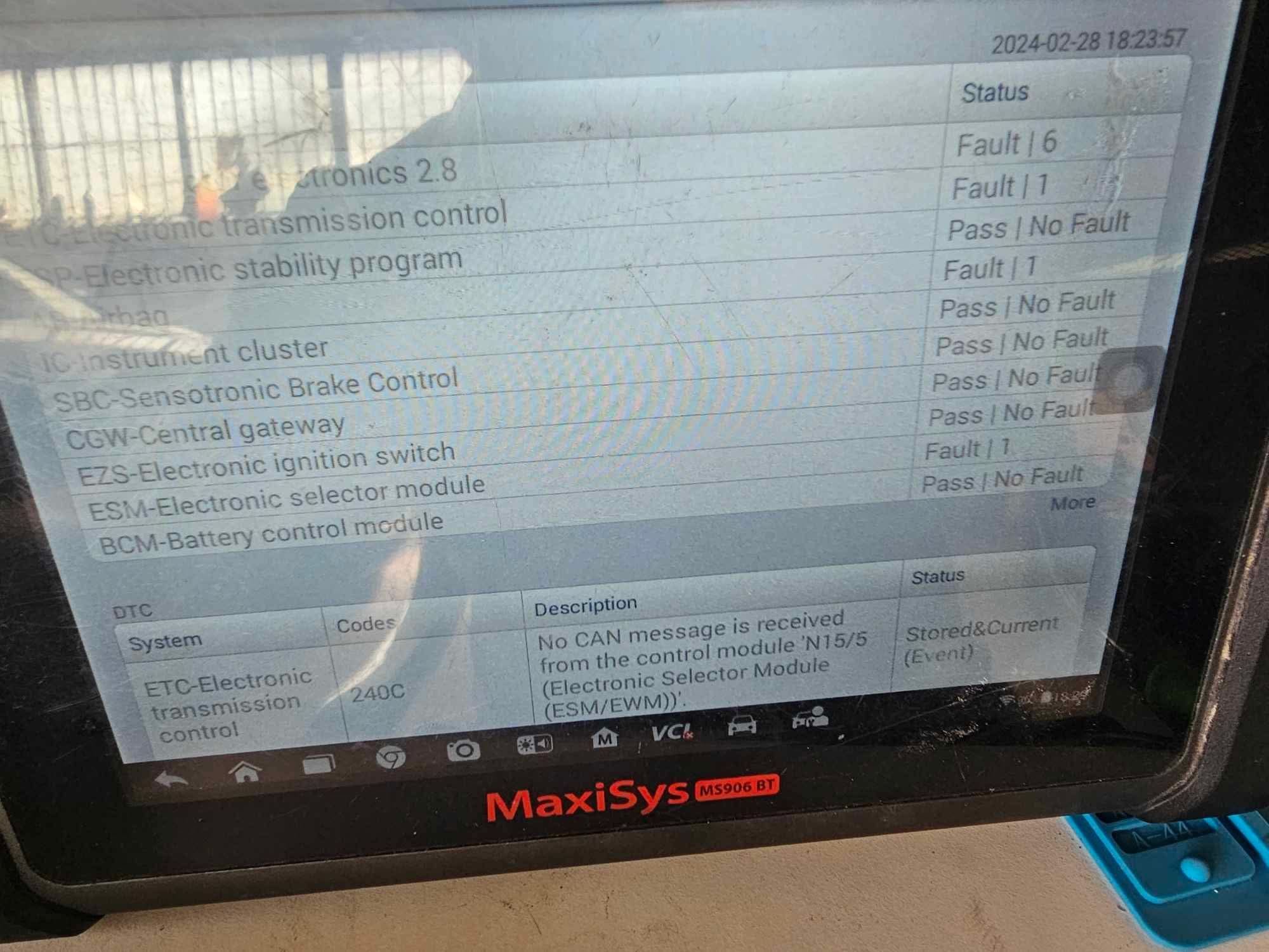

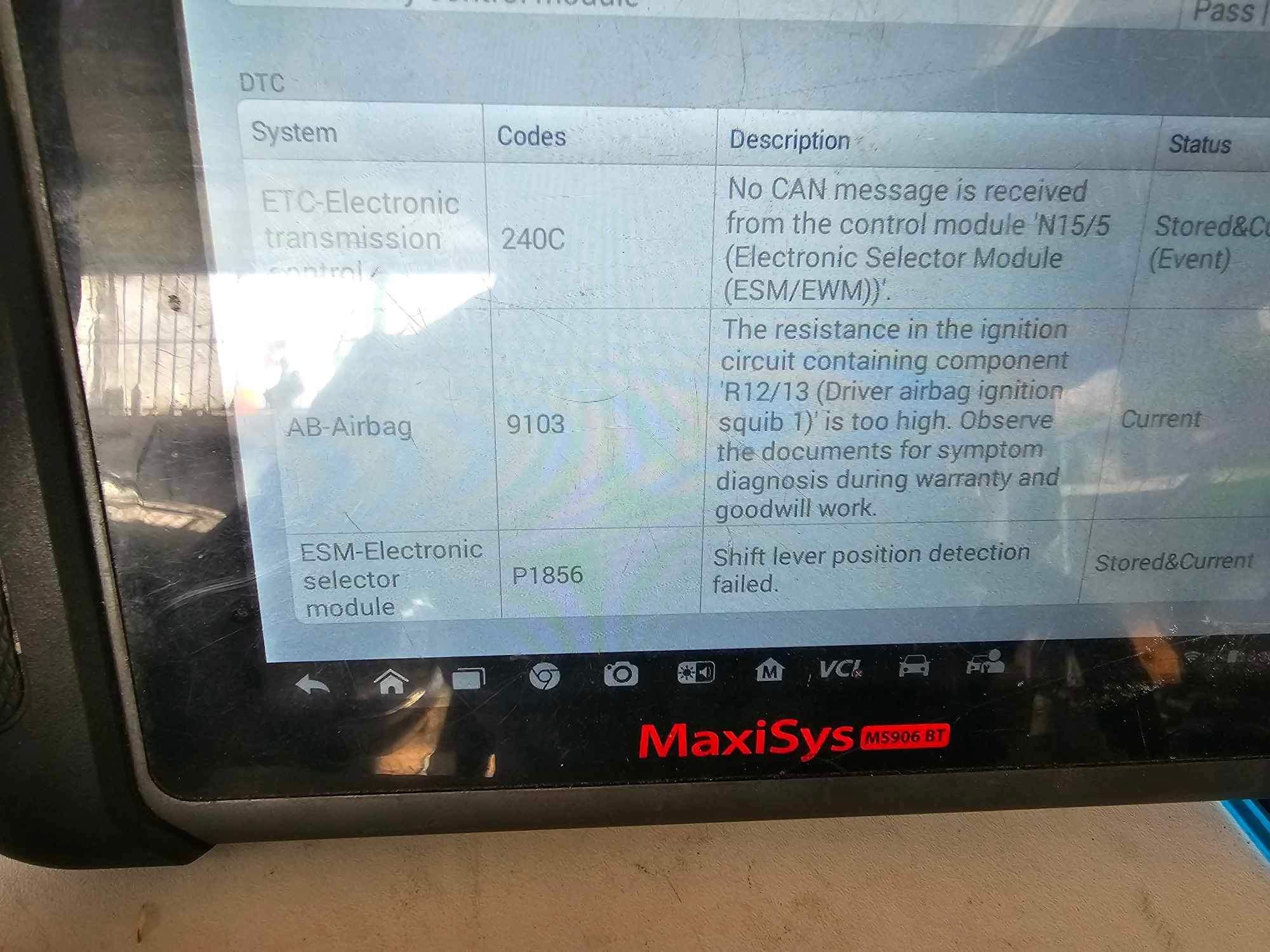

You haven't described when it overheats and what conditions. Is it straight away, only sometimes, heavy traffic, highway? And what's occurring so you know it's overheating? Gauge only, excess pressure?
Youv'e changed every part but have you scanned for codes? You might see something there that points you to an electrical issue - fans, coolant temp sensor, Aux pump, relays etc. You've loaded the parts canon, now load the information one so people can help you.

Hello
it doesn’t overheat straight away but it does overheat in traffic/heavy traffic! when the temp goes above 80 hitting 90 to 120 the coolant water comes out of the reservoir tank but if not in traffic and I keep the car going with the heater high the temp stays at 80 or drops below that!
yes it was scanned I’ve put it down below but I did ask him to send me a clear one which he ignored me and i couldn’t contact him cause he changed my key fob but it ended up being faulty and I tried to contact him about it but he wouldn’t get back to me!

You haven't been clear about whether your fans are coming on. I'd suggest that's where you should look. That's why i said look at the scans. You may have a faulty temperature sensor or an electrical problem. Have you checked all the fuses and the wiring to the fan that can corrode? The fans have encountered problems with age. Remove it and bench test it to see if it works and if it does, work your way back from there.
There are quite a few posts on this topic here and also look at W164, X164 and R251 forums as the engine bays are essentially the same.
