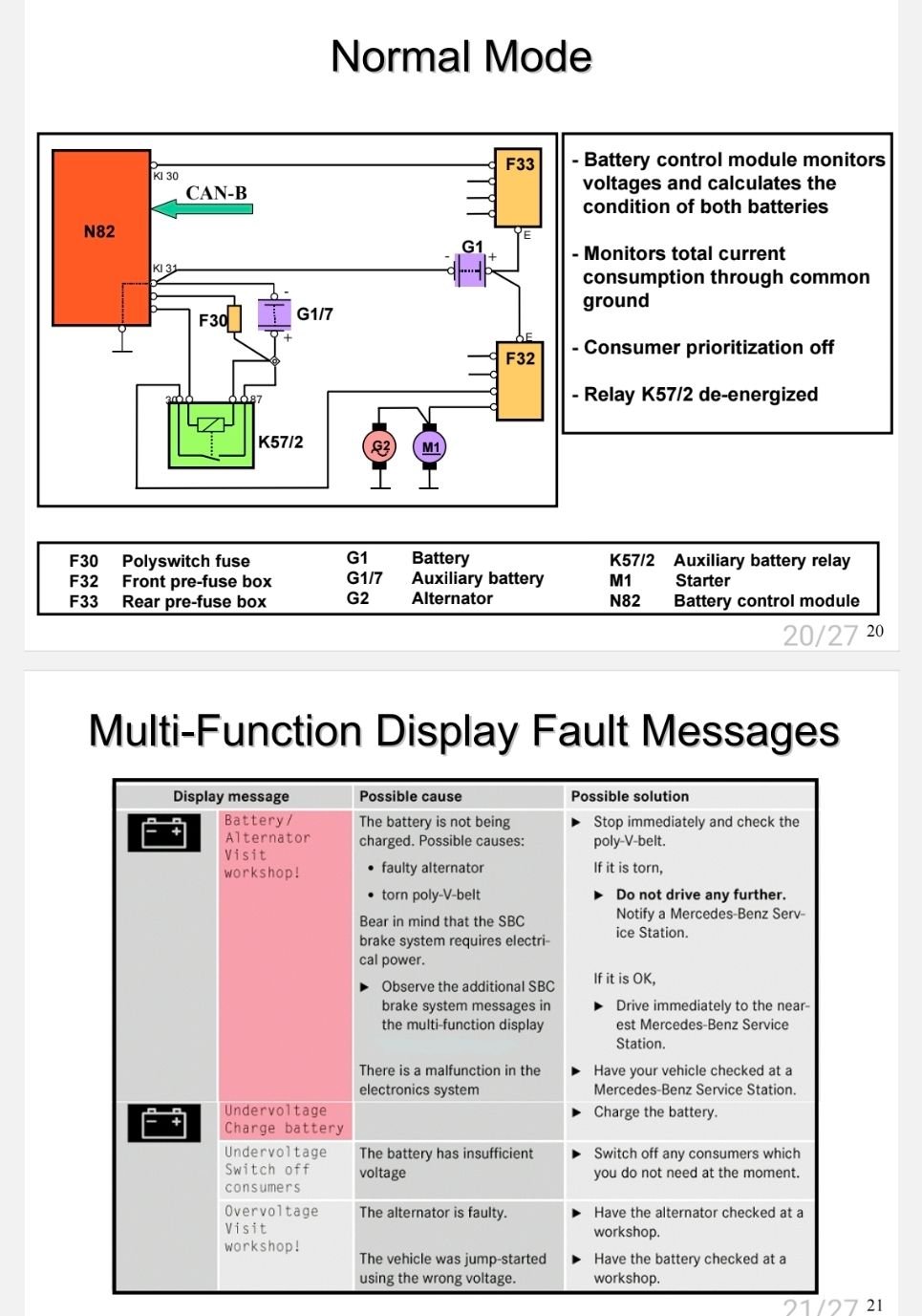

See attached for the W211/C219 electrical system for model years 2003-2006. Any version with an auxiliary battery.

W211 electrical distribution
Thank you for this system design pdf. @bbirdwell
Great doc has everything except troubleshooting steps...
@RocketE500
Before things go bad, make a note to never use ALTERNATOR to recharge flat batteries...
Simply use a charger!!
-- The difference is ALT put-out unlimited 150A killer current.
-- A lead-acid charger supplies limited fixed under variable voltage.
-- Once damages are done poor connections develop with oxidation.
power distribution
power distribution
the BCM duties
the BCM duties
power mgt
power mgt
> TROUBLESHOOTING:
-- Everything is always possible (Batts; ALT) but these chassis are known for charcoaled BCM... focuss on that!
-- Read the chassis faults with a $150 scanner, in particular the battery mgt module
-- Test voltages under operating conditions with a DVM... poor connections will exhibit dropped voltage !!
-- Missing voltage may be linked to open fuse links.
