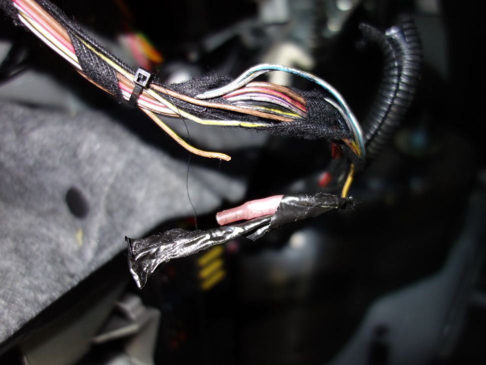

What Heguli said. IIRC the Left hinge has a plastic conduit that houses a bundle of wires that by now have broken/cracked insulation and likely a wire or two that isn't in one piece any longer. Again, if I remember correctly, the brown wire is ground and I bet it is broken.

I had time today to remove the left side trunk panel and look at the wiring per the recommendation of Heguli and rapidoxidation. Spot on.
The ground, brown, wire had been butt spliced and came apart. I used a new butt of better quality and repaired the brown wire and re taped the bundle. The other wires in the bundle looked good .
The trunk interior lights now work. However, neither the license plate lights nor the power trunk release work. The manual release still does not work.
I am guessing there is a fuse or a relay responsible for the electronic trunk release? I have looked on the supplied fuse breakdowns ( bbirdwell Thank You!) and cannot see anything marked for those areas.
Does anyone have any thoughts?
