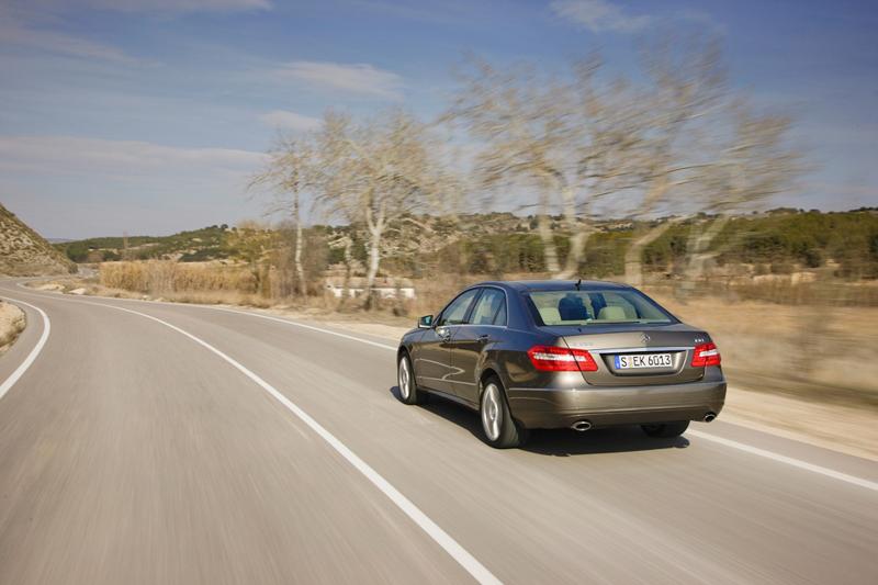

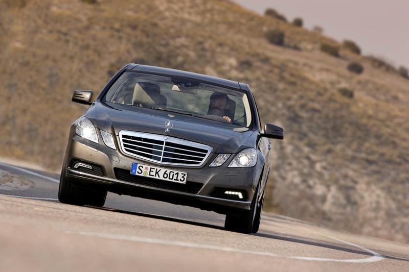

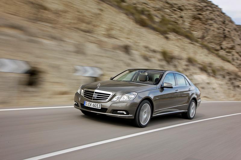

FWIW Here are pictures of a W212 with Luxury trim with the 18" 5 spoke wheels from the sport trim (I know, not the AMG wheel package), but you can see the overall proportions with the luxury side molding etc.
These 18" wheels are standard with the sport trim - 5-spoke wheel
Finish: titanium silver
Wheel: 8.5 J x 18 ET 48 |
Tire: 245/40 R18
A212 401 1302
This compares to the 18" AMG 6-twin-spoke wheel |
Style IV
AMG light-alloy wheel |
silver, high-sheen
Tire: 245/40 R18
B6 6 03 1466
This thread has tons more pictures from which you can see different trim/wheel combinations.
Hope this helps.

Thanks. So the standard 5 spoke and the AMG split spoke will have same profile, width, etc. etc. as they are both 18x8.5 245/40 (unless you go staggered in the back with 9" which I probably would not do). Thanks for pics. Looks good from side and front, but a little hard to tell from back. I'll check out the other thread.
