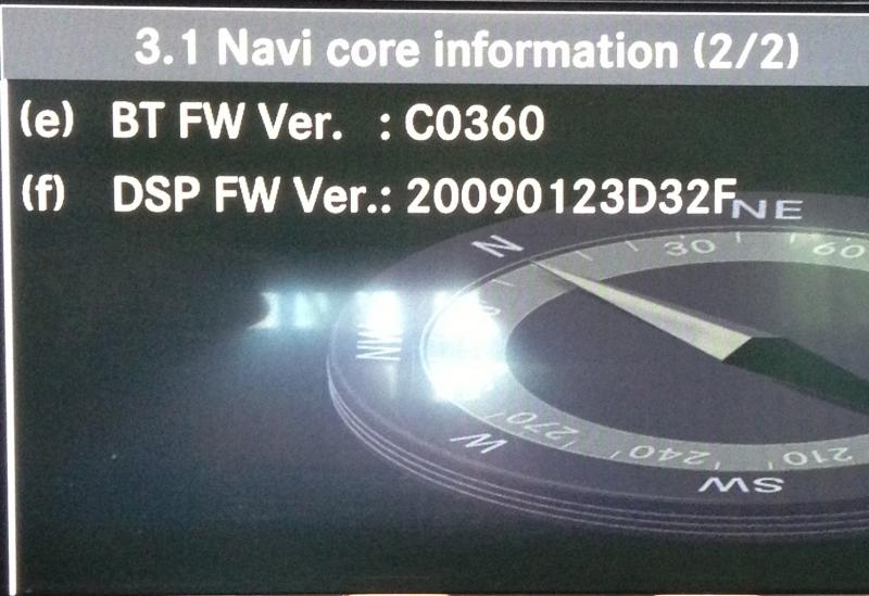

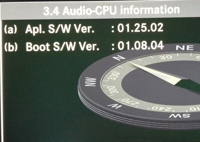

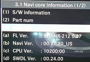

2013 ML350 BT
Is my command software up-to-date?
I just purchased a used (CPO) 2010 E550. I enabled BT streaming and the air-conditioning display in the engineering menu.
I can't get streaming to connect with my iPhone 5, but I don't know who's fault that is. In the phone menu, for connecting a new phone, I don't have an external auth option - only auth. (BT phoning works fine)
I've taken some pictures of any screen that seemed to show a S/W version, though none of them show anything similar to the version #s in a previous post above: SW Version: 0029024000 to 0009026706-001
Before I go thru the trouble of trying to get a software upgrade, does anyone know whether I could benefit from an upgrade?
Attached Thumbnails NEED HELP ON THE BLUETOOTH AUDIO-img_0609.jpg   NEED HELP ON THE BLUETOOTH AUDIO-img_0608.jpg   NEED HELP ON THE BLUETOOTH AUDIO-img_0610.jpg   NEED HELP ON THE BLUETOOTH AUDIO-img_0612.jpg   NEED HELP ON THE BLUETOOTH AUDIO-img_0616.jpg

Old Jul 21, 2013 | 11:05 AM
  #36
OliverU's Avatar
Joined: Jun 2002
Posts: 36
From: Ontario
2013 ML350 BT
Found External Auth - streaming now working
Originally Posted by Arrie
Have you tried EXTERNAL AUTHORIZATION in the car's menu?
Thanks Arrie, I found that option - I wasn't expecting it off "Update". Ok, so now BT streaming with my iPhone5 is working!
I'm still wondering whether I'm running the current version of SW. The POI Map option is disabled - this tells me I'm running older SW. BT streaming is working, though not showing song/artist info - I thought an upgrade was needed for the 2010 E for BT streaming to work?

Old Jul 21, 2013 | 02:40 PM
  #38
Arrie's Avatar
Joined: Oct 2010
Posts: 5,142
Likes: 1,295
From: Southern US
2010 E550, 273 Engine: 2012 S550, 278 Engine
I had 2011 E350 and it did have audio streaming but it did not work correctly. One of the problems was that I had to authorize it every time when I started the car. After updated SW it did it automatically.
I now drive a 2010 E550 and have the updated SW and it works flawlessly.

BT streaming shows the song/album/artist names.
Nav:
While looking at a POI, the map option is enabled.
Traffic:
I was hoping, but wasn't expecting traffic to start working after the SW upgrade. After re-sending the signal from the Sirius site (I had tried this several times before the upgrade) - I now see traffic.
