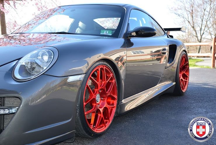

Your car looks great. How is the ride? I don't want any poke. Just flush. Here is a pic of my 997TT with what is to me perfect stance. Your car is perfection too.
I have my theories that my 17" run flat will feel about like a regular 19 or 20 but haven't driven in an E with 20's yet.
That is one sick Porsche 997TT you got there. Loving those candy red HRE's.
