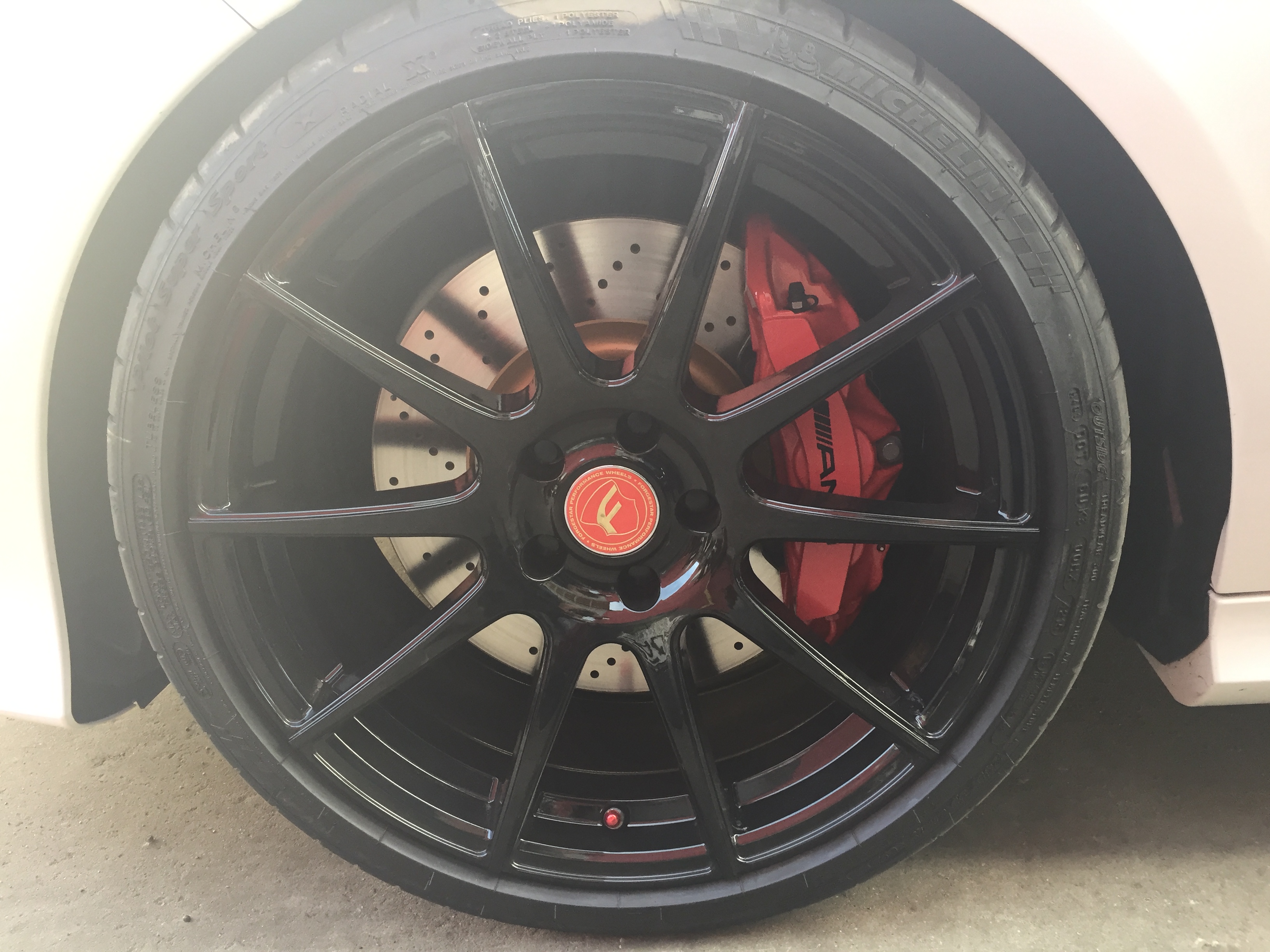

E63 Brakes on E350 Sport.
Knuckles, master cylinder, brake booster are the same exact parts.
On rear rotors, you will have to adjust the e-brake shoes by 1/8".

The stock E350 rotors and brake sensors will not work. You are going from a 13" front / 12" rear to 14"/14" rotors with the AMG calipers. Of course the tiny stock rotors would not work.

The sport rotors are too small. You will need the bigger rotors. You can find after market, one piece, rotors really cheap brand new.
The E55 rear rotor will work with a C63 rear caliper.

The e55 front caliper will bolt on to a e350 sport. You will have to do the following:
1. Enlarge the 12mm holes on the spindles to accommodate the new 14mm bolts that the e55 caliper takes. OR buy AMG spindles at $300+ a pop... much easier to just enlarge stock spindle holes.
2. You will need to cut the brake dust shield. Takes all of 5 minutes with a dremel.
3. Replace rotors with e55. The are only $140 a pop of FCPEuro's page.
DO NOT use your stock e350 sport rotors with e55 calipers, they are too small. I posted on the other thread as well.
Also the brake pad sensors on the e350 will work 100% with the e55 calipers. They bolt right on just like before. Zero issues.
EDIT:
Actually seeing that you put e63... My bad, In that case if you use the 6 piston calipers you WILL have to replace the rotors to two piece. They are expensive. One of the reasons I went with e55's was because the rotors are cheap. I saw zero need for two piece rotors or the associated costs with them on a heavy *** MB... if this was a track car or track bike sure. If it's not going to see track time, personally spending $1800 for front rotors only is silly to me considering you can do an e55 swap for that as an entire package.
just food for thought.
