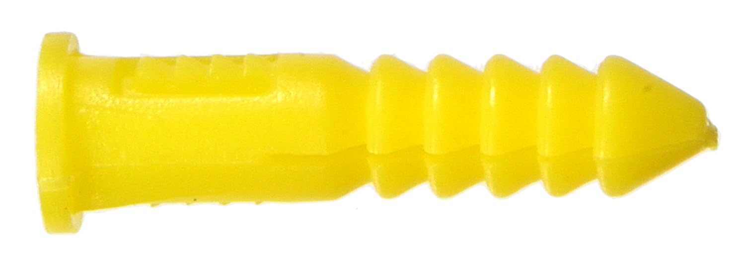

I would go to hardware store and buy 3 plugs that a screw can go into. Like the plastic ones you use on drywall in house. Put plugs in then re-screw. Should hold up and no one will know the difference. The other option would be to use larger screws to go into the holes as long as they work on the holder

This is what dbldpr is referring to, (hollow tile-wall anchor) you can cut it in half and it will still work if it is oversized for your 8MM screw, every local hardware sells by the box or package for a buck or two.
