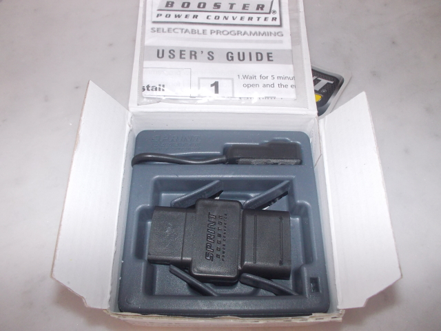

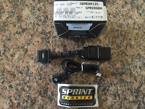

I know exactly what SB does (and does not do). For me it eliminated or greatly reduced throttle lag not in just one, but in six different MBs (as mentioned before, my '14 CLS550 has a long throttle delay, as was '13 CLS550 I considered before I bought '14 three years ago). And no, it did not make car quicker (its not supposed to), but it did make throttle "engagement" immediate (or very close to it) so that pedal's response felt immediate to me and many others. (Five years ago I was very skeptical myself...until I tried it).
IMHO, a SB is a must on most if not all MBs until and including 2014 MY (except in my experience in both '14 E350 and E550 - they must have done something to "fix" the issue for 2014 MY specifically on w212 Es, so for E class its 2013 MY and earlier).
Disclaimer: I usually change cars often, so the longest I had SB in were the 2014 MY CLS550 and ML550 (over 18 months) and since I sold ML, I have SB only in CLS now, so I do not know its longevity, but do know that physical SB P/N SBME0012S (the one for E and most other "modern" era MBs) has changed form the ones I used in 2010 and 2012 cars (even though P/N is the same).
This is the "older" version I had in 2010 and 2012 Es: https://mbworld.org/forums/attachmen...12s-fjls1x.jpg
This is the "newer" version I had in '14 ML and still do in '14 CLS:
Attached Thumbnails Horrendous lag time between shifting into gear and being able to move. Tune fix?-s-l300.jpg
