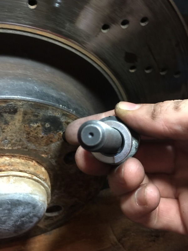

Any suggestions on which lock washer I should use? I got 1/2" and 5/8". Both will work but should I pick the 1/2" since it's closer to the diameter of the camber bolt shank?
1/2"
5/8"

id go with 1/2
but i wish they were a bit wider not thickness wise but radius wise.
1/2"
5/8"
Is there a fastenal store near you? They likely have more options that will be a better fit.
Based on your experiences with them so far, do you think they would work acceptably to decrease the negative camber to address alignment/allow for proper tire wear? (I love the aggressive look but blizzaks on factory 18" amg's in the snow isn't the time for that)

I never tried adjusting the camber bolt for positive camber, however with the results I got for negative camber I think they will work good to adjust for proper tire wear!
