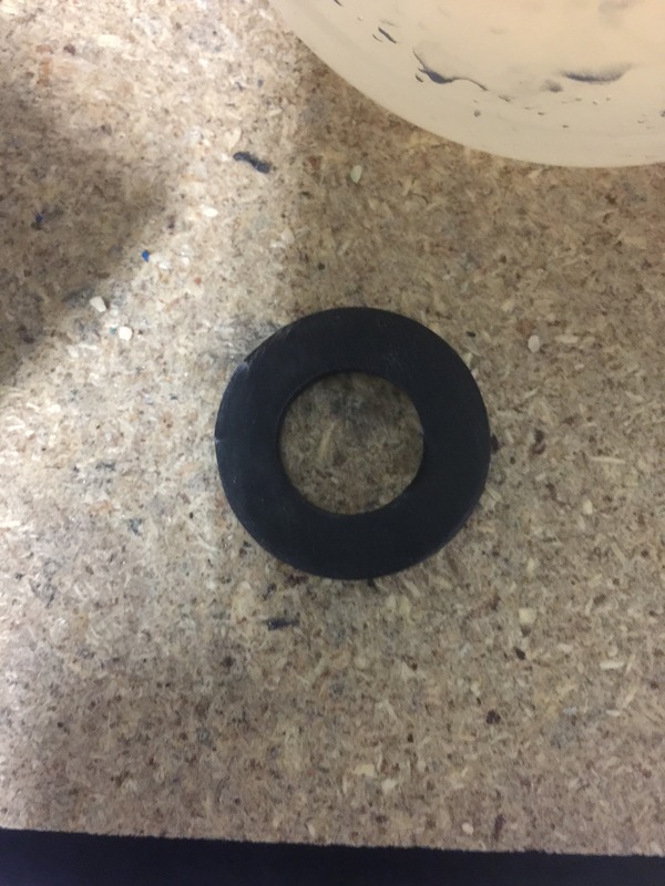

I gave the Acdelco bolts another shot. I finished shaving off the tabs that were in the way, and had great results!
Old Nov 23, 2016 | 12:18 PM
  #37
Chris_tA_4's Avatar
Joined: Dec 2010
Posts: 411
A4
I can't upload the video I made but here is the washer with tab eliminated. It sits flat now
EDIT: heres the vid

You can't remove the tab. It's a integral part.
Old Nov 23, 2016 | 01:08 PM
  #42
Chris_tA_4's Avatar
Joined: Dec 2010
Posts: 411
A4
How?
I thought it was merely just an indicator of which way the washer is oriented to distinguish between positive and negative camber.
EDIT: Maybe I have been using the wrong terminology. I removed the washer handle not tab.
EDIT EDIT:

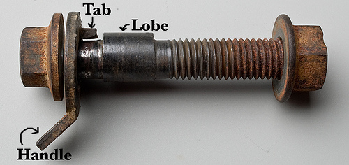

yea the thing that sticks out on the washer. i think he meant
something like this in the pics right? (not an actual pic of the washer)

One locator (tab) goes inside the bolt hole and if you remove it you render the bolt cam useless. The external tab is intended to indicate where the locator tab is in the hole, and you could remove that, but why? It's there so you have a way to conveniently clock the locator tab.
Old Nov 23, 2016 | 02:08 PM
  #45
belarus27's Avatar
Joined: Jun 2013
Posts: 1,900
Likes: 210
From: Sacramento , CA
2010 e550 p2
i guess it wasnt fitting right with it???
Old Nov 23, 2016 | 04:51 PM
  #46
Chris_tA_4's Avatar
Joined: Dec 2010
Posts: 411
A4
The washer wouldn't sit flat with the external tab (handle) on it (I posted a picture of that on page 1). It was hitting the strut mount.
Now with the handle removed from the washer it sits flush and works as intended.
