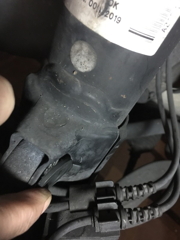

ok bad new. These Acdelco camber bolts only work if you have them oriented for positive camber (tab facing outside of car). If you orient the bolt for negative camber (tab toward inside of car) it will hit the assembly and not sit flat...

I'm thinking about cutting the tab off to get them to sit properly

yeah I'm still going to torque the bolts down to proper spec. I'm not sure if I will be able to get any negative camber when all is said and done because I think these two lower bolts will not allow the spindle/knuckle to move. Even when I had the camber bolt in the positive orientation, as I would turn the bolt I didn't notice any change in camber. We'll see...

if they wouldnt work , they wouldnt sell them.
so you all done with it?? but you right , looking at these pics , looks like those 2 bolts do not move?
shidd im a bit confused now

I honestly don't think the camber bolts are made for the E550. Just the E350.
I didn't shave down the tab yet but I'll probably do that tmrw.

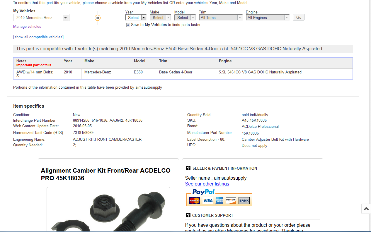

went to check compatibility and it shows that they should be fine.. ughh man.
