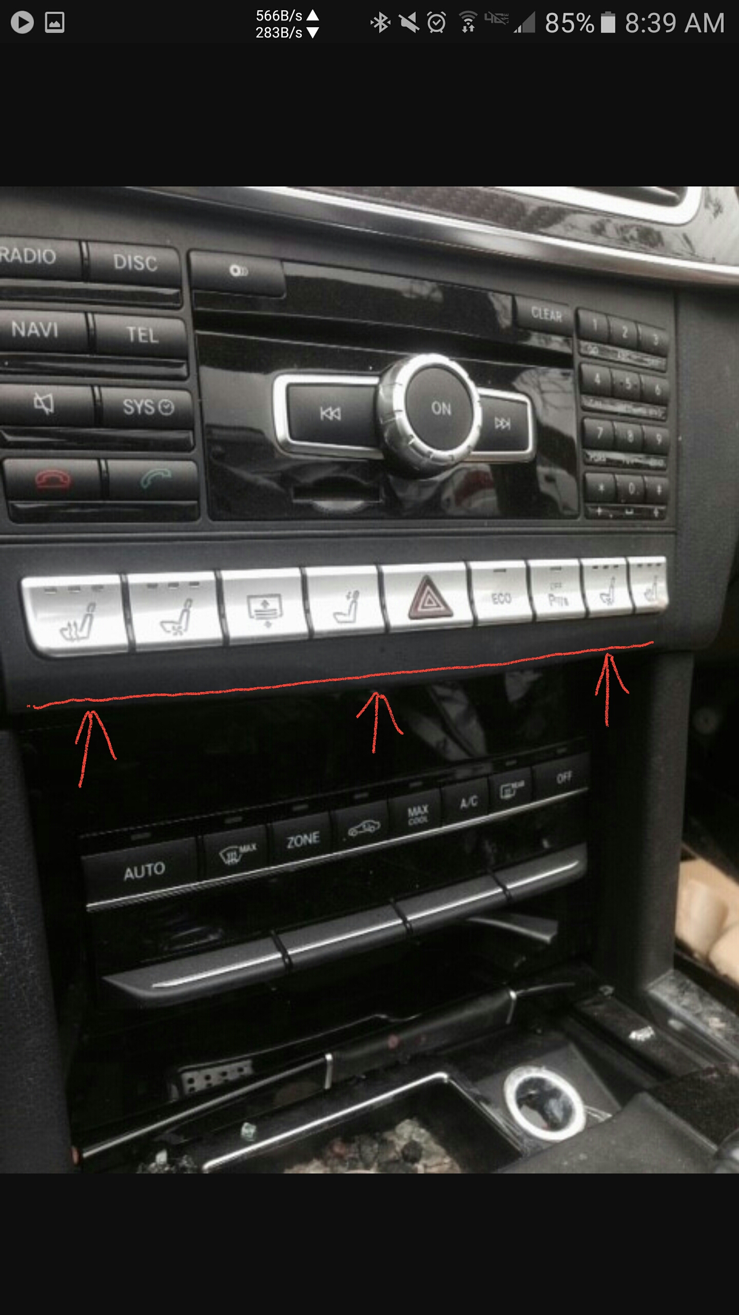

... and almost forgot , to get to those 2 screws you would have to remove a plastic which is 1in x 6in apprx that is located where arrows pointing
Attached Thumbnails Pre-facelift wood trim question-screenshot_2017-02-09-08-40-26.jpg
