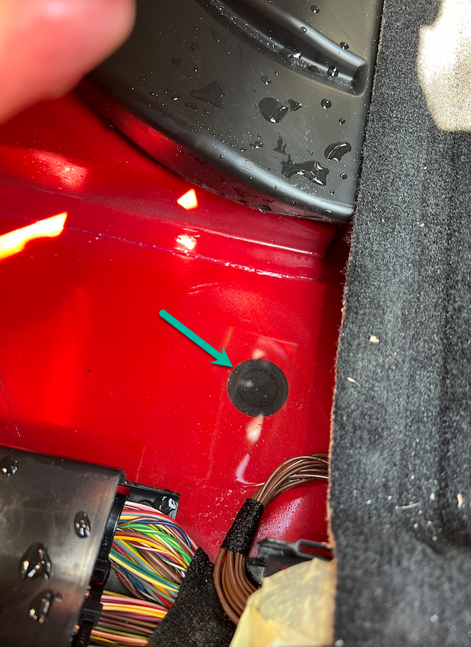

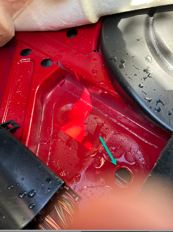

There are holes in the floorboard that have plastic/rubber plugs. Usually the size of a quarter (~25mm). I have removed mine to keep the water from pooling in case any enters the passenger cabin during a heavy rain. The plastic undercarriage covers keep road debris from entering.
Plugged hole
Plugged hole
Unplugged hole
Unplugged hole
